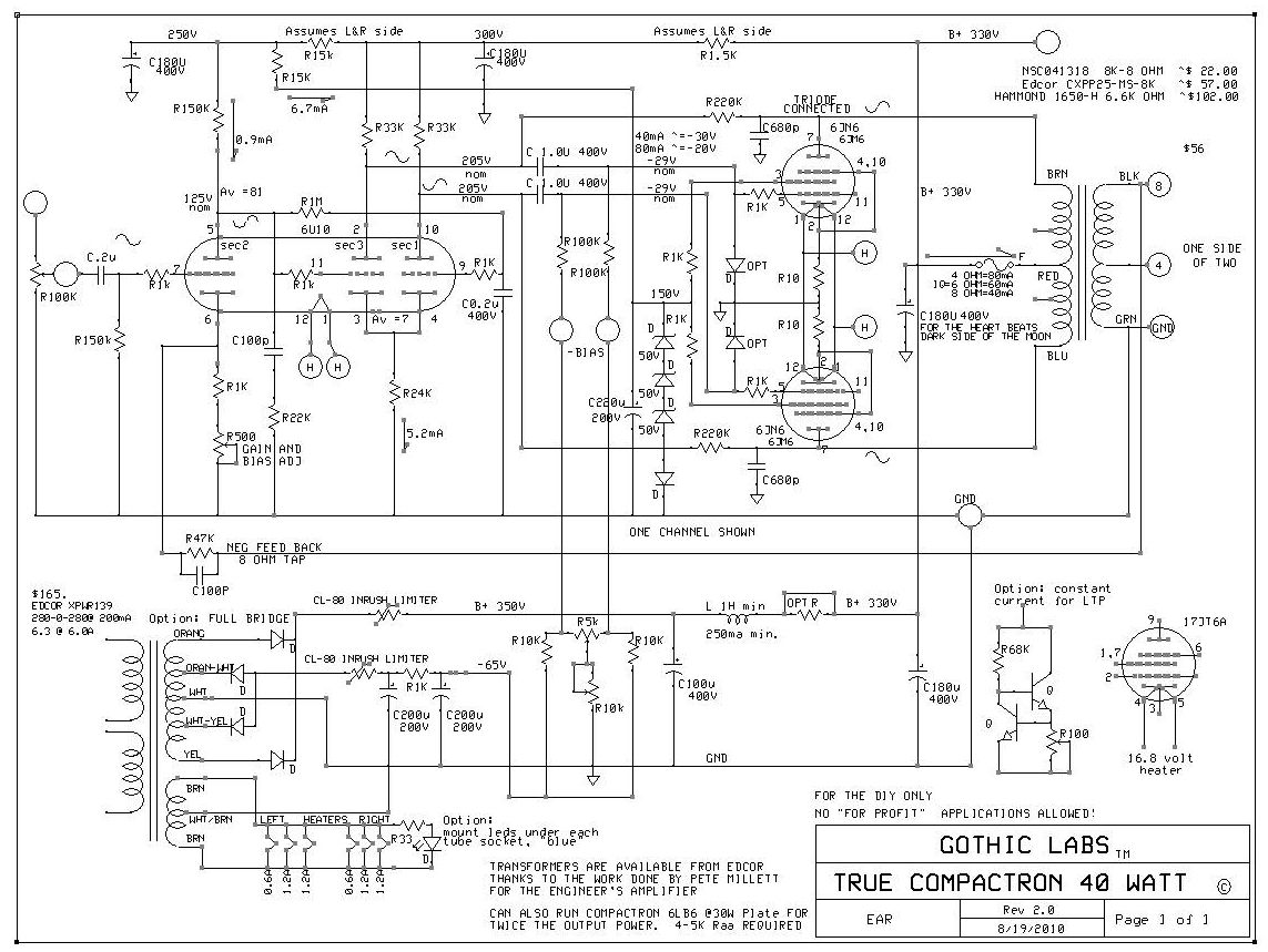

Use of global negative feed back
It is amaizing how well behaved the amp is with the global neg feedback from the output transformers. Some may say too well behaved.
I attached the schematic for the Compactron amp, as designed is 20watts/channel into 8ohms but after doing research on other compatable sweep tubes, can achieve 100watts/channel with the proper iron and appropriate B+. It has the global output feedback to tame it to be able to run with 4 to 8 ohm speakers with the cheap $22 8k-8ohm output transformers. At that output level with the speakers I have, it can drive you out of the room. With 4.3k Raa output transformers, sweep tubes have been tested at over 200watts/channel with 550V B+.
TO add GNFB to your amp just mimic the schematic, if properly hooked up the output will drop a little in volume, it it gets louder, its hooked up wrong on the transformer output.

Today i made some experiments with feedback in my EL34 PP ,tested different values of resistors,and spent some hours listening some CDs,and to be honest,didnt decide yet if prefer with or without NFB.And found one problem- I cant connect the Black Wire of the OPT to Ground ,and use the yellow for 8 Ohms and feedback(through 22K resistor) because it makes PFB,so i have to connect the yellow to ground and use the black as 8 ohm for output and for NFG. Do you think that is a problem?

I don't know if that would make any difference, but could you switch the leads going to the input grids of the EL34s? That would be an easy fix. Or switch the inputs on the phase inverter.
Yes, i can make a test and see what happens!I don't know if that would make any difference, but could you switch the leads going to the input grids of the EL34s? That would be an easy fix. Or switch the inputs on the phase inverter.
EL156
Be much easier to switch the connections between finals at the primary of the OPT.
Might have consequences regarding stray capacitance, though whether or not that's a problem remains to be seen.
