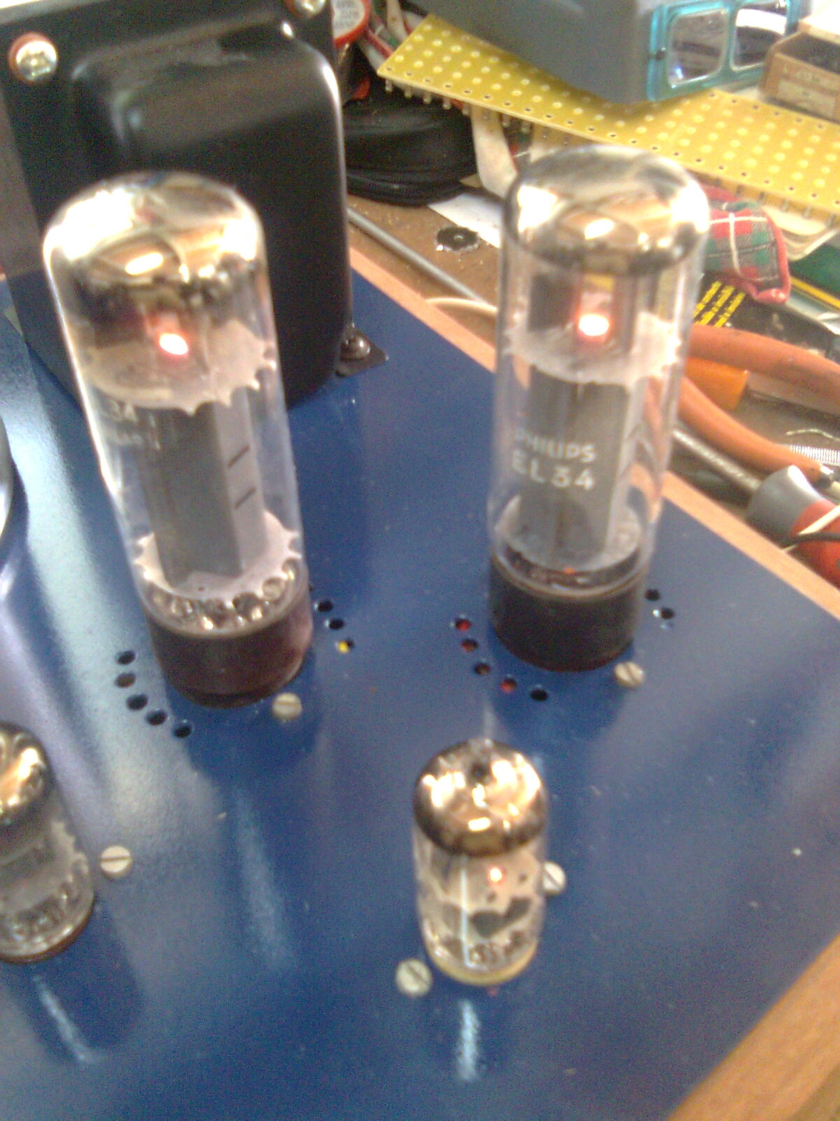

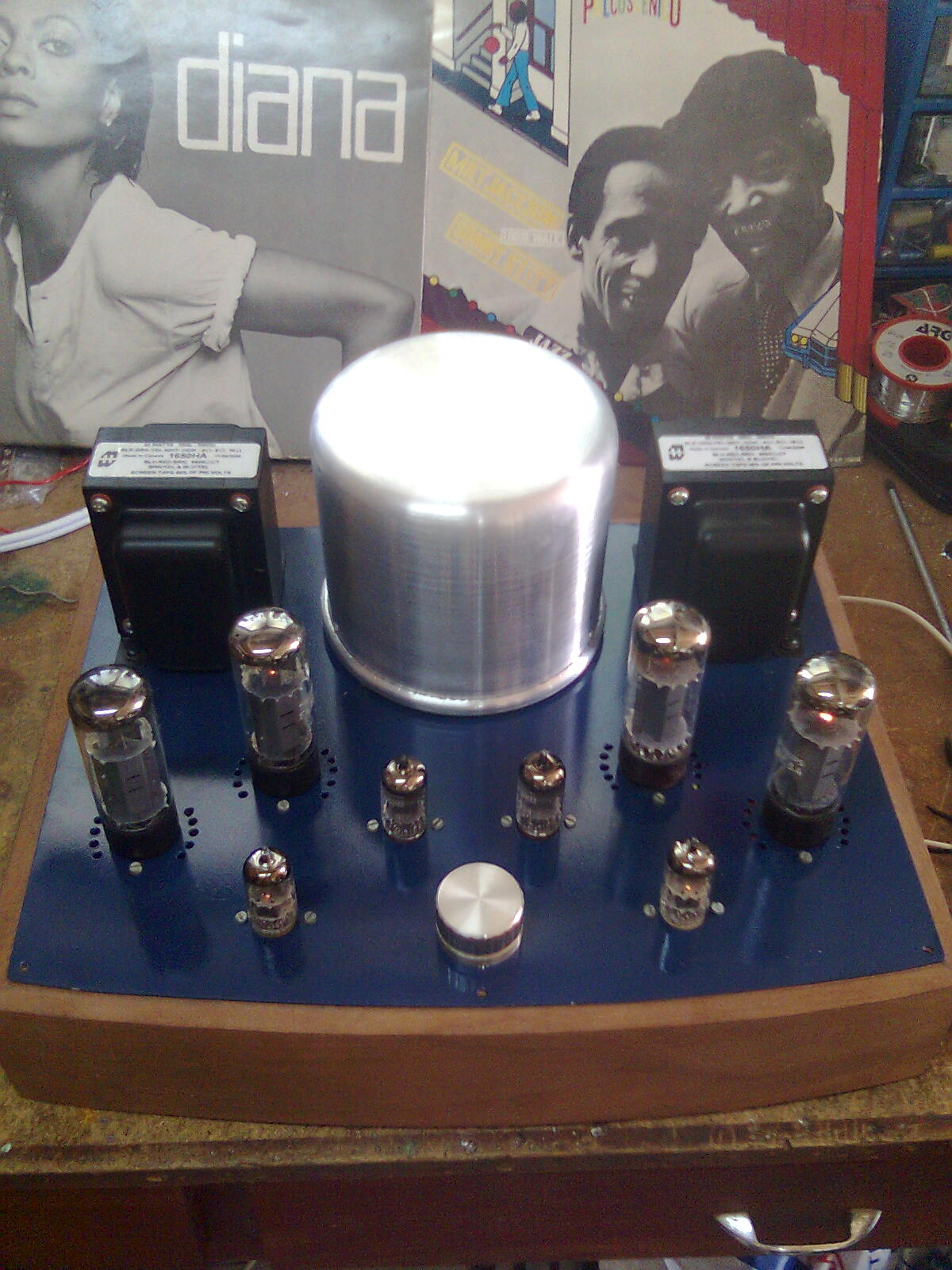

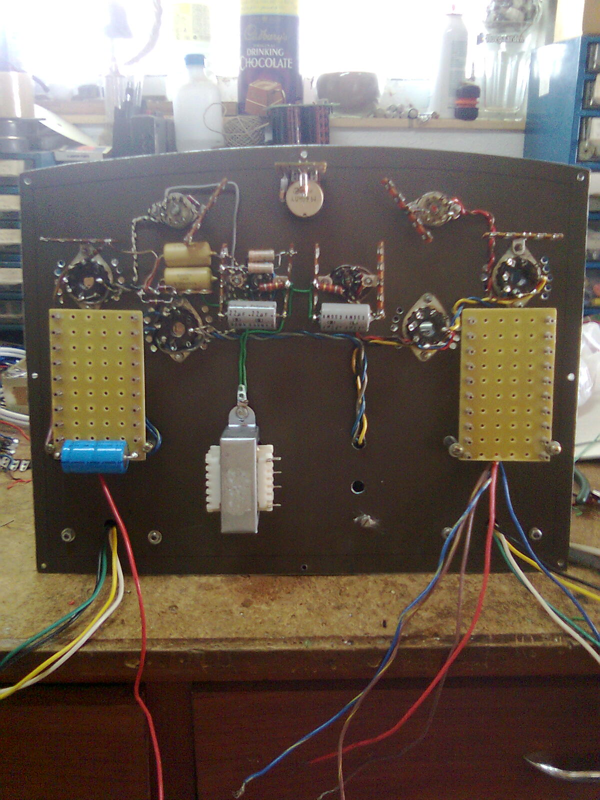

EL34 PP PROJECT
Here are so fotos of my latest project...
E88CC as input tube
ECC804 as phase splitter
Well, it is a newbie project,but i am not very happy with the sound ,it seems doesnt have enough power, but i will post the schematic to get your opinion about it, maybe i havesome mistake in there!
Thank you for your comments

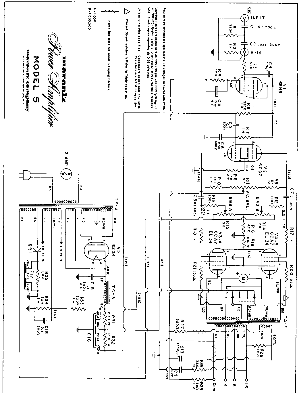

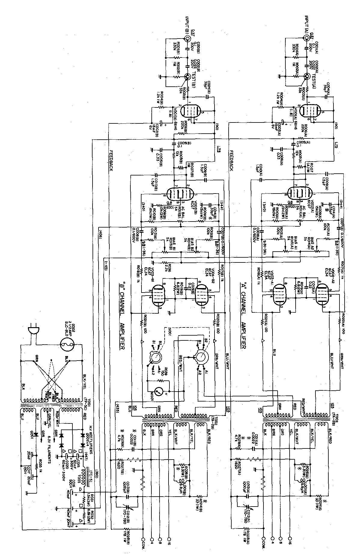

Apply output global feedback from the output of the output transformer back to the 1st stage 330 resister. Try 22k and 100p in the feed back loop. You will loose a little gain, but it will be far better behaved. I prefer fixed bias in the outputs... but then even the Marantz 5 an 7 use global feedback .
