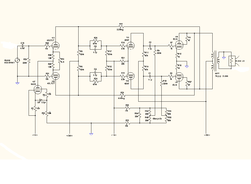

Now the difficult part. ou described your schematic in an earlier post (for the PP AB1 Triode) does a diagram of this exist somewhee on the web? So far the one ckt that looks interesting is the one by Allen Heath called the PP-1C from this site (http://www.vacuumstate.com/). I hear that a PP-2C is also in the works. Dave (Planet 10) posted it on another thread.

Hi Ray,
That looks like an interesting circuit. I might build it with a SS current sink. I see you are partially cathode bias and fixed bias. Best of both worlds?
Also, I see -15V for the grid bias circuit? I can't see the value clearly.
-Chris
-Chris
I see you are partially cathode bias and fixed bias. Best of both worlds? Also, I see -15V for the grid bias circuit? I can't see the value clearly.
It's fully fixed bias. The 10 ohm resistors in the EL34 cathodes are just there to measure the quiescent current (50mA = 0.5v across the resistor).
I was afraid it might not be legible. The main negative rail voltage is -115, a bit less for the CCS because there's some decoupling.
It was quite legible. the voltage rails look like -110V on the 6AU6, -350V, -115V and -500V on the OPT. Are R13 and R15 10 ohms? what wattage?
Some questions...
Hi Ray_mote, i like your (or TL's idea) of the feedback done in this way! 🙂 It seems like a really nice amp to build!
The -350 and -500 should be a +350 and +500? And at the signal, max 500mV? How can the sensitivity be reduced, when say I have a preamp that already has an output of 3.5V (from CDP of 350mV)? IS your first resistor after the signal a 220K?
Is there also a way to implement adjustable feedback? I guess not that easy because the feedback loop is also the B+ for your 6SL7s right?
Sorry for the noob question, thanks for helping! 🙂

Sorry for the typo. Should be Ray_moth. I could not spot the typo so late at night (or should I say early in the morning)...
You're right about the voltages, of c ourse - problem of legibility. Sensitivity can be reduced by increasing the value of the resistor between the cathodes of the 6SL7.
Also, as you say, the input grid resistor is 220k and could be made lower but should not be increased, because the Miller capacitance of the 6SL7 will cause treble roll-off. Most people would probably say it should be 100k or less; however, I have a 250k log volume control before it, so I'm limited in the value I can use here. I wouldn't recommend a volume pot without a "back-up" grid resistor, because if the pot wiper doesn't always make perfect contact, it will upset the bias and cause noise.
Not really. the main plate load of each 6SL7 triode is a 120k resistor. You could reduce the 2.2Meg cross-coupled NFB resistors to, say, 1Meg without causing instability or upsetting the DC conditions too much. I used to use that value but then decided to reduce the NFB until it gave just enough damping for my speakers.

What if R38/39 (2.2M) were replaced by a 1Meg resistor and 1M pot in series? Wont that make NFB variable?

Thanks Ray_moth.
Can you explain the purpose of the one resistor between the cathodes of the 6SL7 (it looks like R30 4.7M?)
How about if a 100k log vol pot was used? I guess a 470k would do the trick nicely?
I noticed your grid stoppers for the 6SL7 and 6SN7 are 10k and 2.2k? Any reason why since I see most folks use 1k or less?
I also tried (but could not find) any info about the anode to anode resistance of OPT of EL34 in triode mode, any info on this? I only saw Lundahl's paper which states that it should be higher than the 6.6k of a UL connection.
I guess having a good quality pot in the FB loop enables some adjutability. In this subject on resistor quality, I guess all the signal path components should be of a high quality? i.e. R25,26,34,35,16,19,7,8,38,39 and C19,4,5,2,3.
How does the amp sound like? Any improvements down the road like using CCS biasing (if it improves at all...)? What kind of PT should I be looking at if I wanted to build this?
There are a couple of 6SL7-6SN7-EL34 schematics, but yours seems the most interesting, which tubes are you using?
It's a 4.7k resistor (legibility problem again!) It moderates the effect of the individual 1.5k cathode resistors and is a convenient way to control gain. Originally, I didn't use it but that resulted in too little gain. Rather than reduce both of the 1.5k resistors, I used this parallel resistor.
Yes, that would be fine. The only reason I used a 250k log pot was because I didn't have anything smaller.
I didn't have any scientific reason for my choice of stoppers. I just used values I'd seen in other circuits. I notice that a stopper of 10k or bigger is quite common for the input stage. (I must admit, I don't really know why!)
Mullard suggests 5k P-P for EL34 PP triode mode. I use 7k p-p, because that's what I had available. The OPT was actually intended for EL34 pentode PP, @3.5k p-p, but I have my 8 ohm speakers on the 4 ohm tap, giving me 7k. That is OK for triode and results in slightly less power and less distortion. 5k p-p would be better.

I'd be careful of putting pots in the NFB loops - a voltage drop of 150v is involved. A better idea to make NFB variable might be to use a 10k pot between the cathodes of the 6SL7 in each channel. The quality (and physical size) of resistors is very important. I like metal film in the signal path adn wirewound in the power supply. If you can, use minimum 1 watt resistors everywhere, except in places where more than 0.5w dissipation is called for. Resistor rating should be at least 2x the expected dissipation
Claus Byrth's paper mentioned that EL34 in triode would require 8-10k, quite different from Mullard... 😕
My PT is just about big enough tol supply the two channels. It's an Amplimo toroidal design, giving 340v @700mA, 6.3v @6.8A and 50v @100mA. I use a voltage doubler to get the required -106v neg. supply.
Then how did you get -115V? 😕
I use a supplementary filament transformer (Amplimo toroid again) to get sufficient current for all the heaters, which includes 3.8A for a pair of paralleled 6D22S TV damper diodes acting as a B+ slow-start device (in the negative line, which avoids nasty high voltages on the top caps). My B+ rectifier is actually an SS bridge of 4 x MUR4100E ultra-fast recovery diodes. B- uses 2 x MUR4100E in a voltage-doubler with 220uF caps.
I can do the trick by manually switching on the B+ with another switch 1 minute or 2 after the filaments right?

Hi Ray_Moth,
Sorry to bug you again. For the filament supplies, I am guessing that you use the main PT for the EL34s, and the supplementary one for the 6SL7 and 6SN7 right? Where do you connect the ground of the supply to?
Another question is how much current are your sinking from the 6SL7 and 6SN7? A SS CCS would do just fine here right? How about the cathodes of the 6SN7, would it be better to have CCS here too or not necessary?

You guess correctly. Ground is connected to a centre tap, created from a pair of 1k resistors, in the case of the 2 windings used for EL34s and for 6SN7/6SL7s. The third winding, used for 6D22Ss and 6AU6s, is connected to the negative -105v rail because the 6D22S can tolerate up to 600v heater to cathode but the 6AU6 can only tolerate 100v.
6SN7s are drawing 3.2mA per triode, 6SL7s 0.9mA per triode. The cathode current of each 6AU6 is about 3mA, because of the screen current.
SS would be fine for the CCS. You could then use a much lower negative rail voltage, of course. I'd be inclined to use a MOSFET, e.g. IRF820.
I don't think a CCS for the 6SN7 would give any real improvement but it wouldn't hurt to try it.
