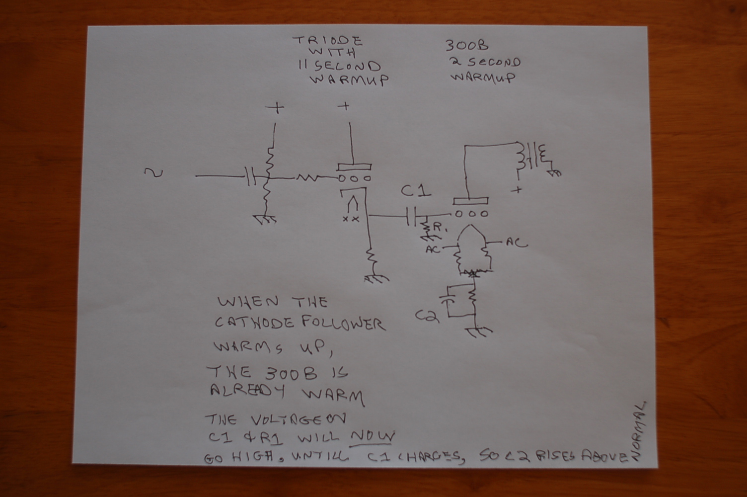

Cathode bypass capacitors. The OEM value seem to be 64V From what I read 50-, or even 35 volt could suffice? Anyway I do have 4x polyester caps 100uF/100v that I can make fit, but it will not look nice and it will limit access for measurements, so I will not put them in until I am done playing with other modifications.
Yes, 35V caps will work as long as you are careful when you adjust the bias. 35V / 390 Ohms = 89.7 mA (bias would have to be severely mis-adjusted to have this much current).
g1 coupling capacitors: I measure 152, 154, 160, and 160 volts over the 47K anode resistors of the phase splitters. The common 1K resistors measure about 6.6 volts. The note on the schematics expect this to be 7volt. Anyway, this calculates to an anode voltage of the splitters of approximately 170 volts, so I would expect the 400volt rating to be plenty. Still the PCB is prepared for physically larger caps and I do have some 330nF/630 volt in the drawer. Is it recommended to put these in or should I get hold of some 470nF? BTW: These measurements indicate about anode-cathode voltage of about 160 and about 3.4mA in each triode. Is this OK for an ECC82/12AU7?
The question is, will the power supply rise to more than 400V before the tubes warm up. That could potentially put more than 400V on the caps. That is why I recommended higher than a 400V rating. I would not change the coupling caps capacitance, the feedback loop is counting on a specific phase shift from the RC networks. Changing the uF value might change stability. 160V x 3.4 mA = 0.55 Watts is OK for a 12AU7
Phase splitter: for each grid measures either 1M or 150K to GND. There left and right circuits use different parts of the valve for inputs. Right channel splitter has input on pin7, left channel on pin2. 1M resistor is located close to the coupling cap with about 2cm (3/4") of PCB track between resistor and socket. 150K resistor has half this track length.
I do not see any 1Meg resistor in the schematic. Where is it? Asking for advice on a circuit that is not the same as the schematic does not allow for proper analysis. Changing grid resistors can change the RC network, and the stability. Also it can reflect back on the gain of the two splitter halves (you want the same gain for the 2 halves. The splitter cathode resistor is not a current source, and the 2nd half of the splitter gets its signal from the resistor summing network (the uneven EL34 grid resistors makes up for this).

Changing from one triode to another could require a lot of changes to the rest of the circuitry. You are working with a circuit board, and certain other fixed components, such as output transformers, power supply, etc. Changing to a cathode coupled splitter, and the consequential loss of gain, will change the feedback open loop to closed loop ratio. Damping factor, frequency response, distortion will all change. After you get this amplifier working with new components, solve the EL34 internal shorts, etc. you should enjoy the amplifier for what it is. After that you can start on a new amplifier design from scratch, with different topology, or different tubes, etc. That is a major project.
