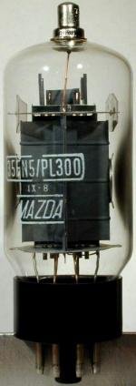

EL300 = 6FN5 / PL300 = 35FN5 tube

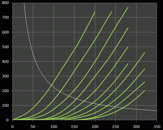

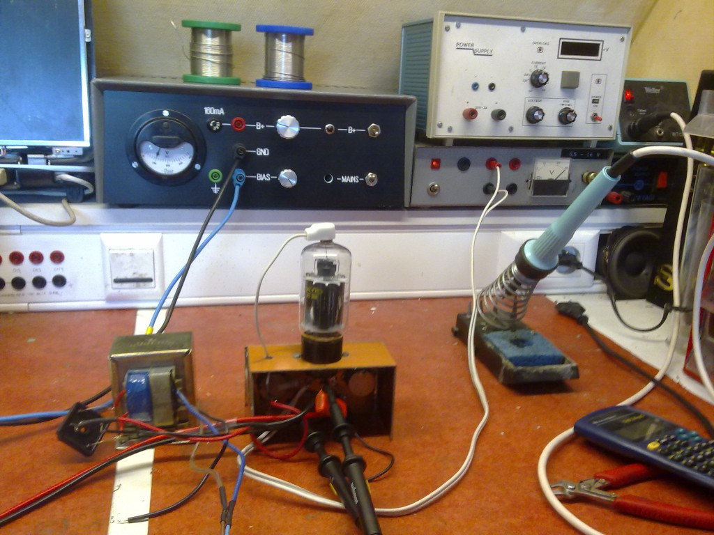

Tadaaa!
Left most curve is 0V, from there on i used 5V increments.
Dissipation curve drawn is for 22,6 W (17,6+5) but I believe this tube can handle some more...

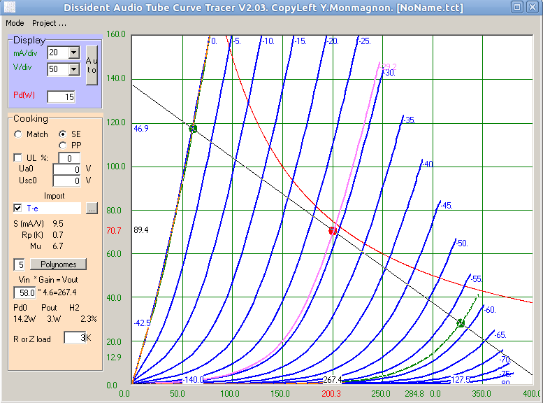

Now how do I calculate mu, rp, ideal plate load etc?
