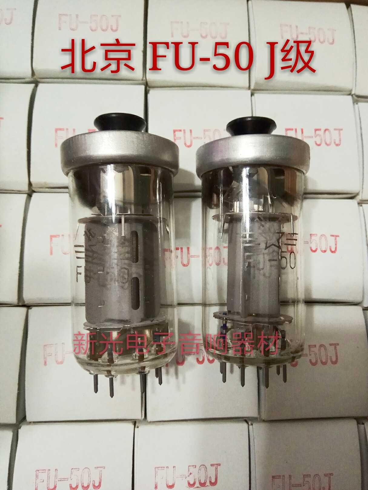

It looks like to be EL152 made in Germany by Telefunken but I am thinking that it is impossible for a company from China to have such a large stock of NOS EL152.It is a real EL152 on the picture.
I highly doubt china made EL152 tubes..
They imported some western tubes in those days , for the army maybe ... could be genuine .

OldHector, the answer to your question probably is the fact that the EL152 is Telefunken's own successor of good old LS50. Besides the heater it is identical to GU50, P50, name them all.

Sadly, it doesn't. Other heater (12.6 V vs. 6.3 V), other envelope, other base. EL152 requires a very unique 10 pin socket. Besides the E/FL153 (same tube less the supressor grid) I don't know of any other tube with this base.
