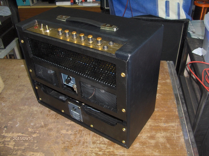

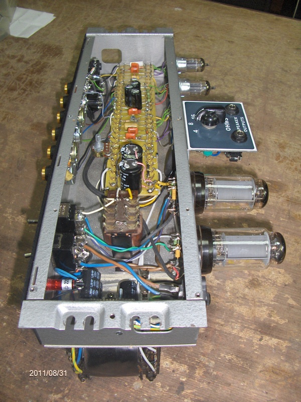

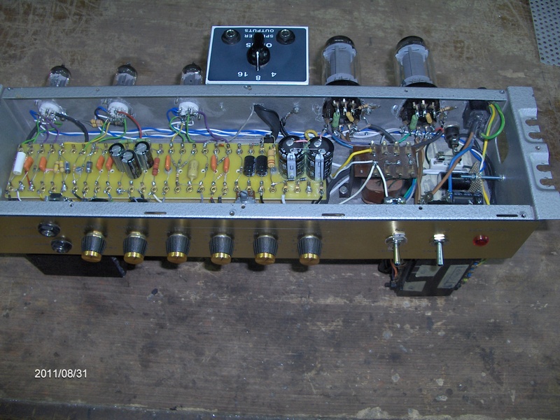

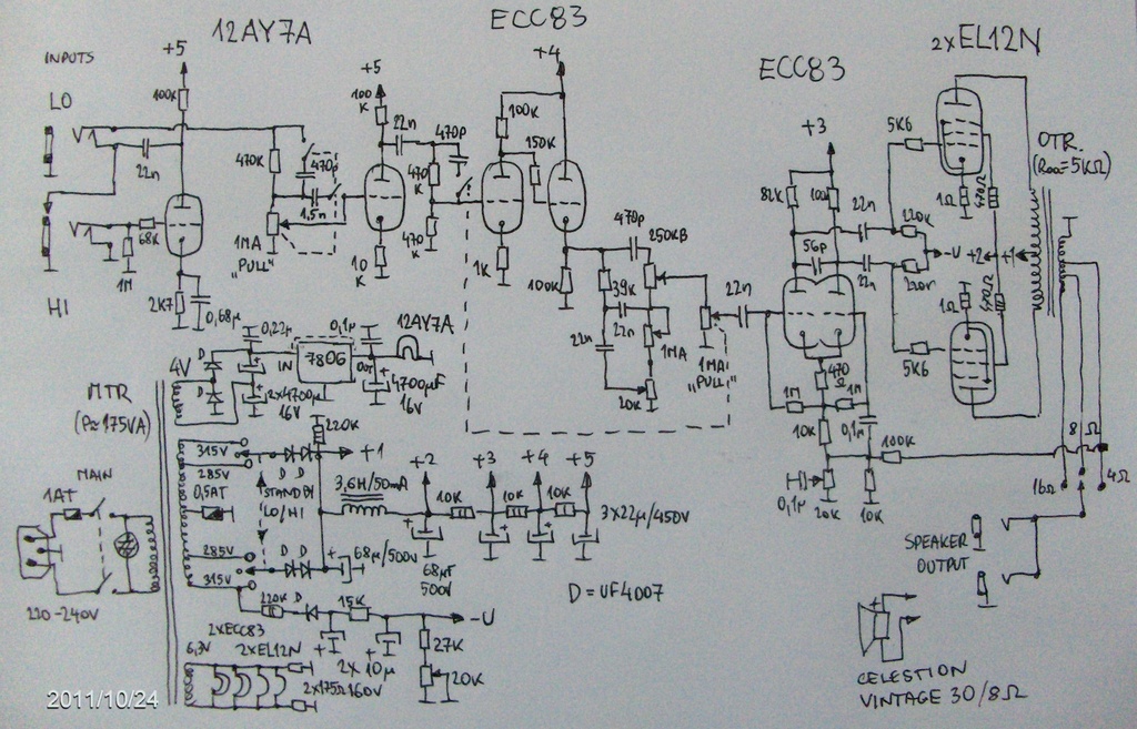

Just finished clone of MARSHALL JCM800 (model 2204 with small modification) with 2xEL12N in output. Guitar sound is bether than any amp that I build before (more than 400 amps for guitar!)! First I tray with 12AX7 on first position (normal, ECC83 Philips/1977Year/NOS) with perfect sound, but have too much gain, and than try 12AY7 (Electro-Harmonics; new production) with less gain. EL12N are NOS tubes from Germany (DDR; RFT production; NOS from 1959 year!).

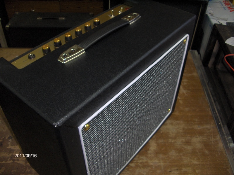

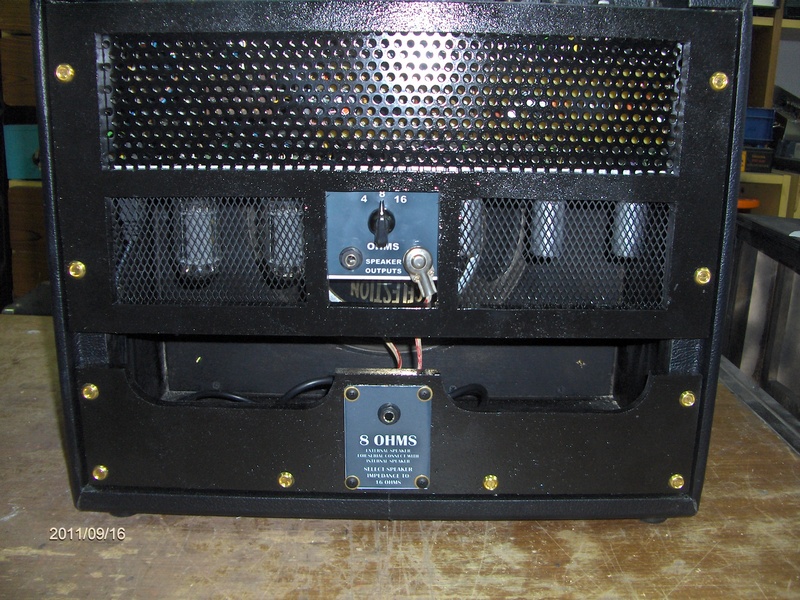

Yesterday I put amp in box with speaker (Celestion G12Vintage-60W/8 Ohms). Output power is >40W in normal pentod-mode and ~12W in triode-mode (screen to plate via 470 Ohms/2W).
