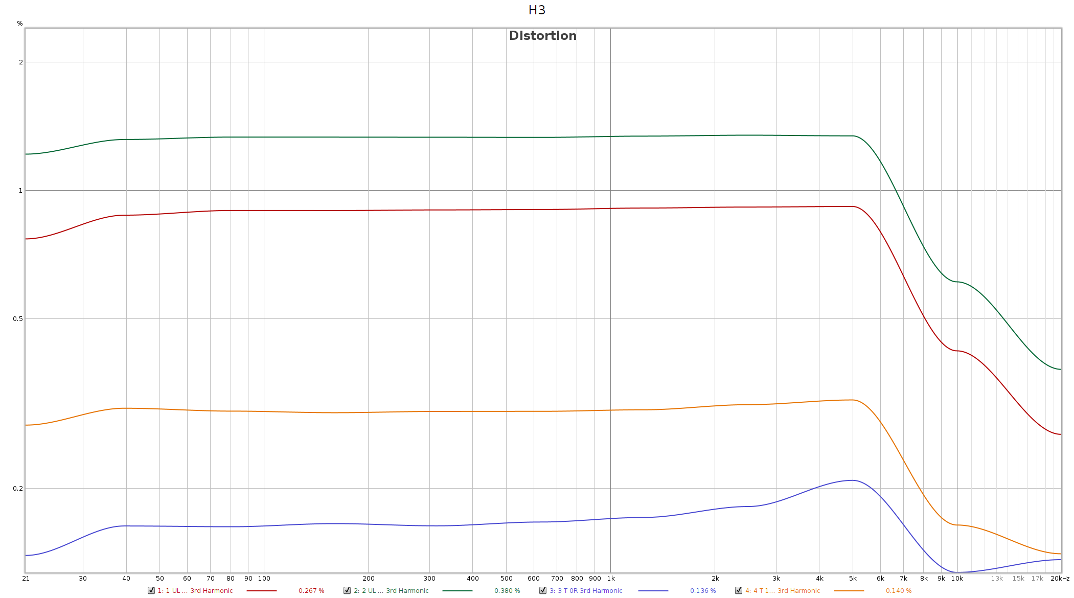

For my previous test I used the Behringer UMC204HD as a DAC/ADC. The output level is not that high and also gets distorted the last few dB's so its usable range is even lower. I found that the resistor value of the Harmonic Equalizer did nothing to the harmonic distortion (signature).
Based on the similar idea as in the post above (distortion created in output tubes) I again focused on the HE resistor, but now with an oscilloscope over it. I found that there was indeed a H2 visible and with increasing input signal of my Topping D10s it became significantly larger. Low and behold: The harmonic distortion of the output depended on the value of the resistor. Turns out 0R is better than 33R! And then I remember this from 'Valve Amplifiers' by Morgan Jones: "Sadly, the author’s experiments indicate that although the equaliser affects all valves, it isn’t always a positive effect."
For the results, see attached graph for the H3 level. The drop at higher frequencies as because the clock of the d10s DAC is different from the Behringer ADC.
The HE resistor is 33R, not the 18R mentioned in the graph.
1) UL 0R
2) UL 33R
3) Triode 0R
4) Triode 33R
And to make matters worse, I had a ~500R resistor in the other channel, which I kinda forgot about as they "didn't matter anyway"...

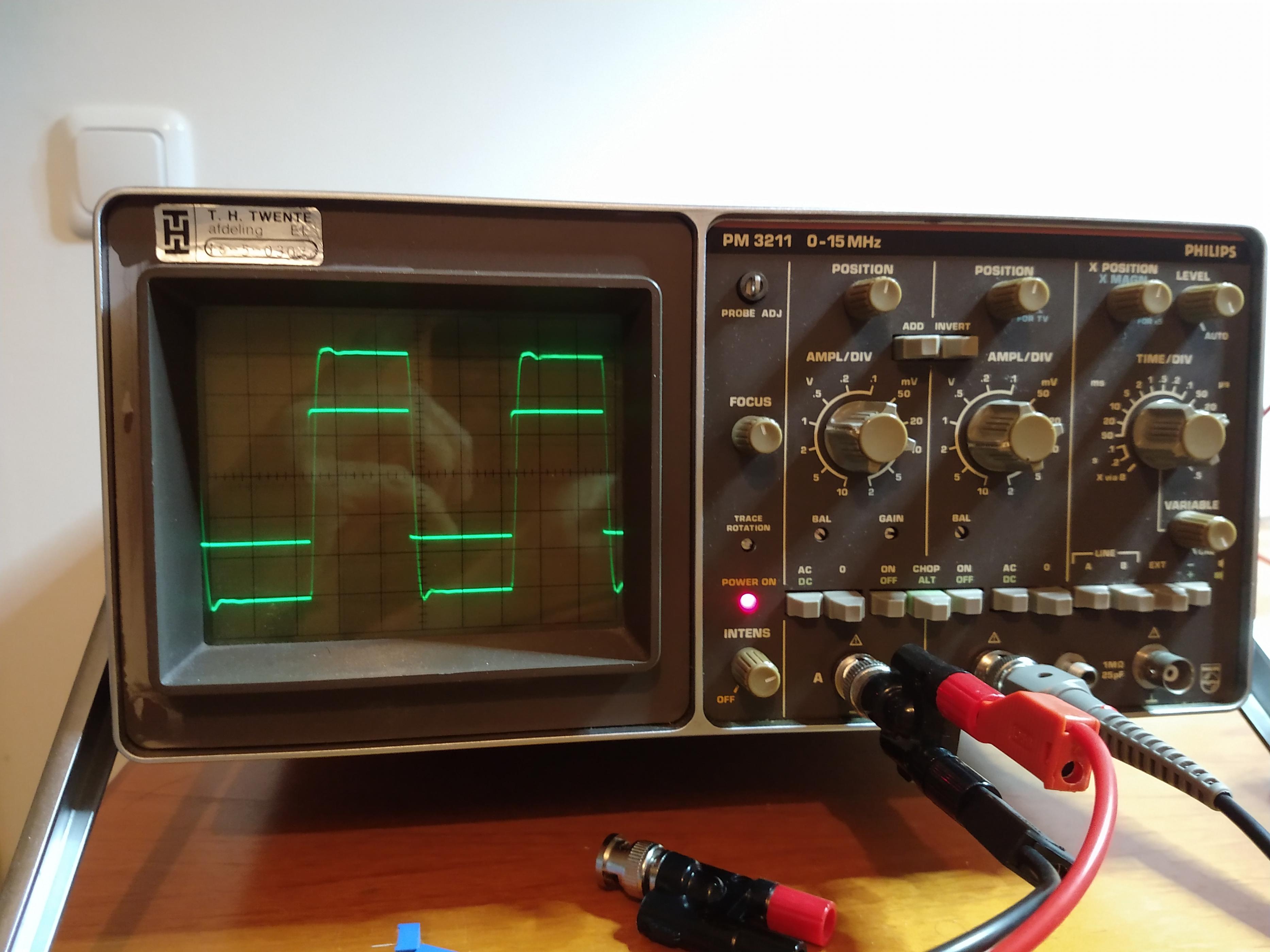

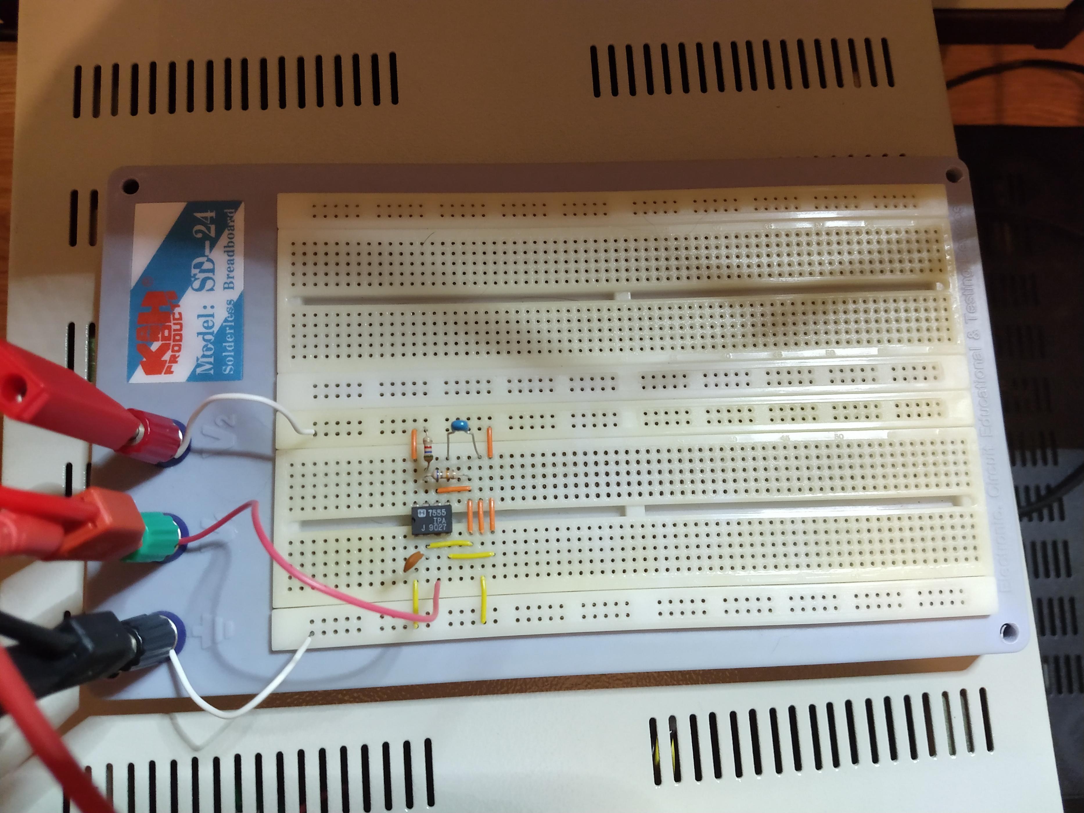

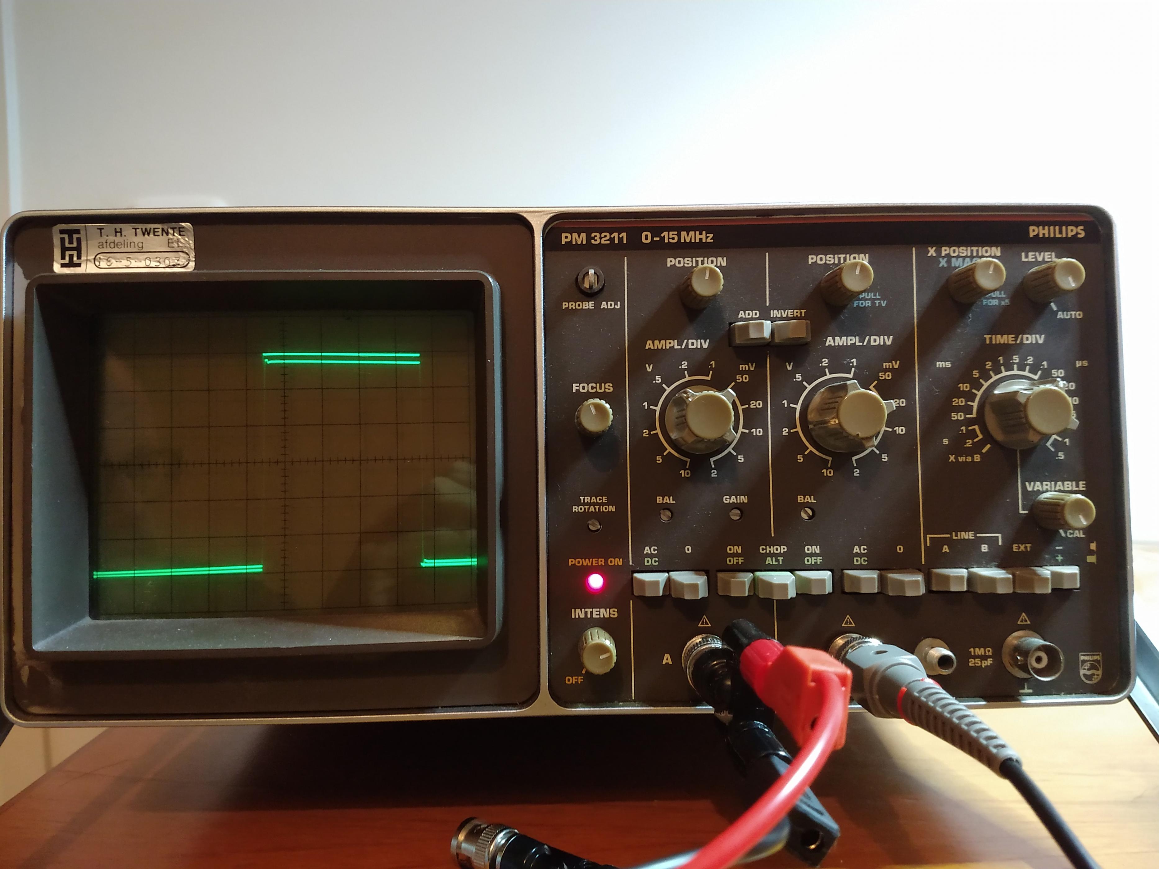

I managed to build my own square wave generator from a 755 that had been lying in a closet for at least a decade.
Images are for 1kHz, 10kHz and 10kHz with the feedback resistor bypassed.
