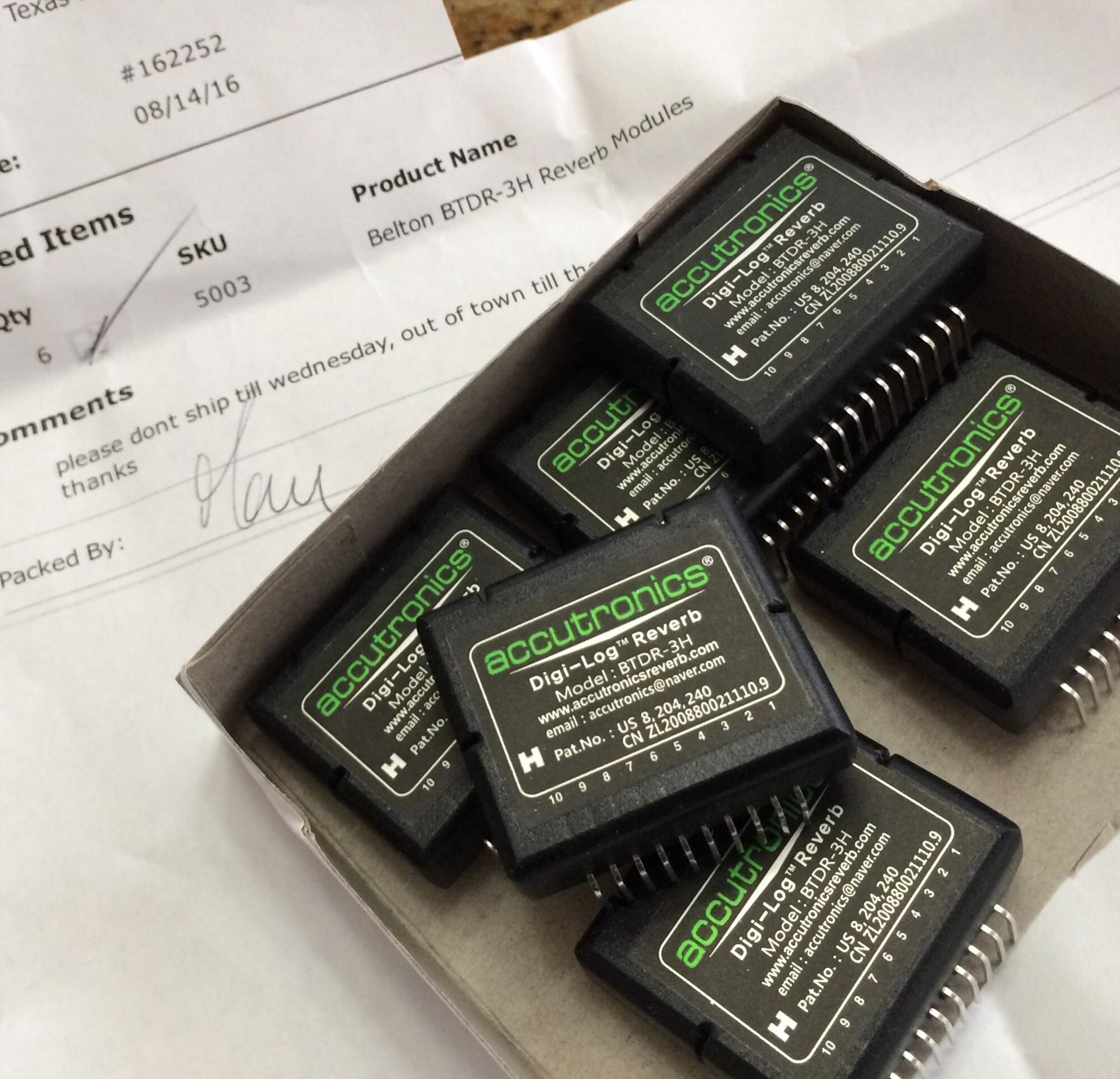

Please remember that the Belton brick, which is being discussed in this thread.
a) is NOT a Digital anything, period, so bringing digital reverbs into the discussion is irrelevant
b) it has a "defect" built-in in on purpose, to make it better simulate a coiled steel wire *spring*, and does it quite well.
If given the choice, I would use a real spring, but my Plan B would be a Belton Brick.

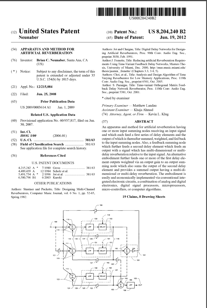

Their patent says otherwise.
said delay elements are implemented via one or more integrated circuits having an analog-to-digital conversion at an input and a digital-to-analog conversion at an output which are capable of providing said delay times.

Here is the brick patent. It does sound good with the intentional dither.
I just personally prefer the spring.
https://patentimages.storage.googleapis.com/b6/4a/1a/3cbfa35d17ebe6/US8204240.pdf
While looking for information on the price of the Beltron reverb module in Canada, I stumbled across this little write-up on the history of the Accutronics spring reverb: https://www.sweetwater.com/insync/accutronics-reverb/
