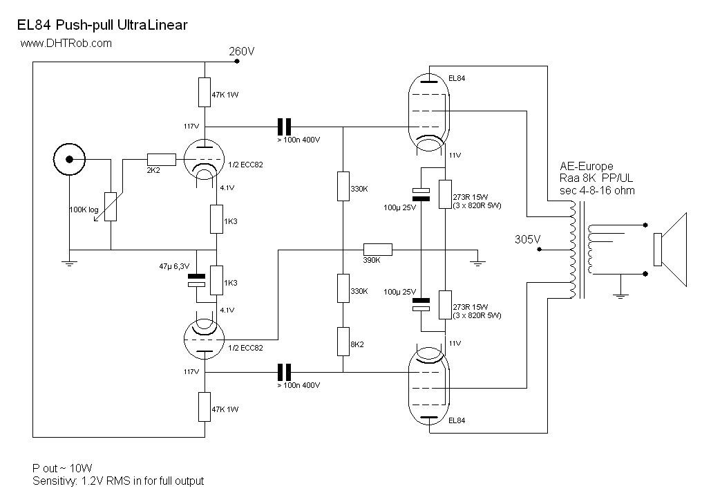

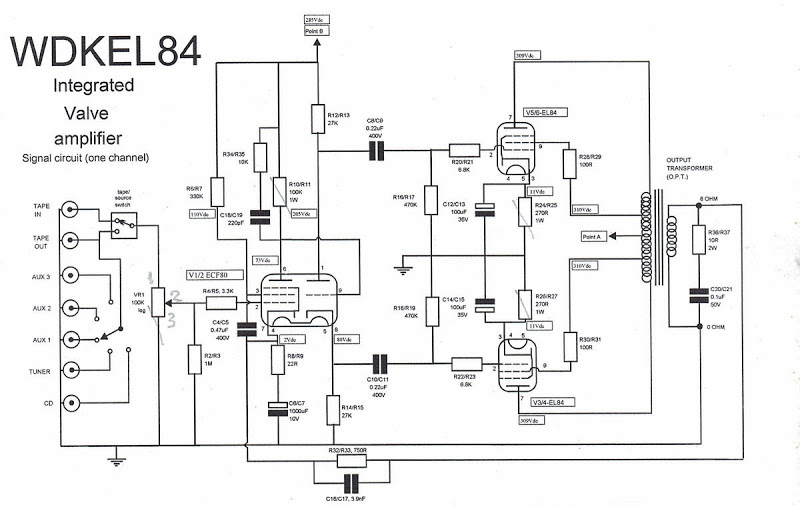

Have just bought myself a Hammond 370HX and two Hammond 1650E output transformers for a el 84pp prosject .But which amp shall I build? My first thought was the KEL 84pp, but I see that there are plenty of different schematics out there. Which of these two?

Since el84 need little in the way of signal swing, and modern sources can provide healthy signals on their own, the pentode input of the kel is probably unnecessary.
The 2nd looks to be a simplified variation on El Cheapo.
There are 3 EL84 PP that have been developed on the forum. Baby Huey, El Cheapo, and The Red Light District. I would recommend one of those.
We built a variation on El Cheapo (triode Class A) and it is stellar. I have the biasing LED construct for the Red Light District, but would build baby Huey next.
You have to work really hard to make a bad EL84 amplifier.

Like another poster said, the first circuit might have too much gain. The second circuit might not have enough, depending on your source. The second is a quasi Quad II-like design. The Quad used pentodes, the ECC82 is a low Mu triode.

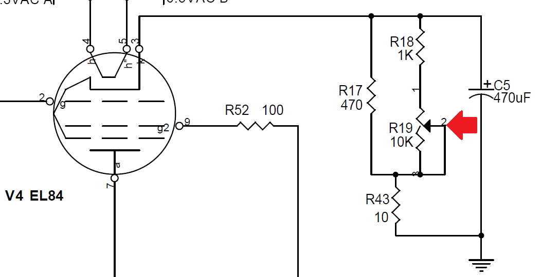

If you want to make tube bias adjustable without going to fixed bias see the attached circuit used in the DIY Tube Dynaclone.

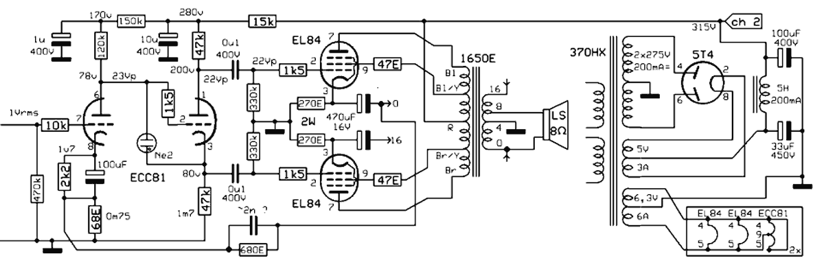

Well I don't like either one.
The Hammond has 0-4-8 and 16 ohm out.That is 4 ohm is the middle of 0-16, nice to make a cathode feedback output stage.
After some calculations and looking at the curves, this is what I cooked up.
The 5T4 is second choise, GZ34 is better but very expensive.
The connections to the 0 and 16 is a 50% chance, Hammond doesn't give the phase of the windings, could be the two have to be crossed.

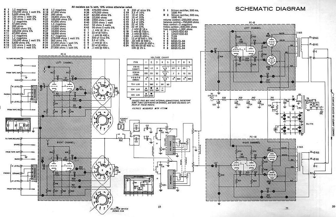

How about this circuit? The P10 section-

I see that the power transformer gives 275v x 2 on this curcuit. My Hammond 370HX have the same output. If I use an 5T4 i can use my Hammond transformer and get about 300v out?
Hammond: 275V for 200mA DC
Without load the voltage from the transfo will be higher, say 290V (+5%)
Rectified you get 290x1,4=400V. With a load the voltage drops, lower transfo and loss in the tube.
Two amps are good for ~150mA DC.If there is still 280V on the transfo (not full load yet) the DC would be 390V if no loss from the tube.
How much one loose depends on the quality of the tube.Educated gess, 315V left.
Mona
The last EL84 amp I built used a Hammond 272JX, 300-0-300 volts. The newer 200 series Hammonds have pri taps for 115 and 125 volts IIRC. With my ~120VAC line and using the 125v pri tap, the filament voltages were 5.9 volts and 6.2 volts. The rectifier was a Sovtek 5AR4/GZ34. The total HT draw was about 190mA, the EL84s were running a bit "hot" at about 40mA each.
First cap after the GZ34 was 47uF, then a Hammond 1.5H 200mA choke, then a 150uF cap that supplied the OPT center taps. The EL84s wound up with about 307 VDC on their plates. Maybe a little high but OK on Russian EL84s.
So, with your power trannie (275-0-275) there might be a bit too much drop across a 5T4. The GZ34 has a fairly low drop, as rect tubes go, and might be a possibility if your B+ is a bit lower than desired.
