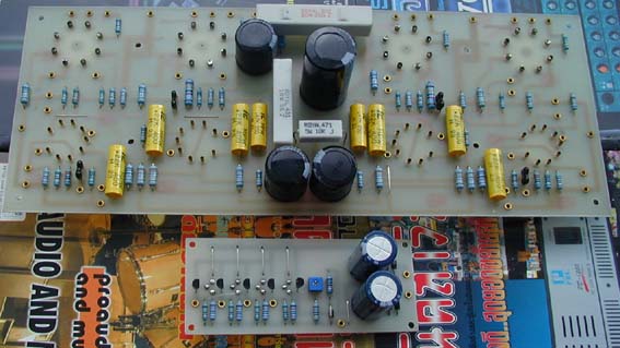

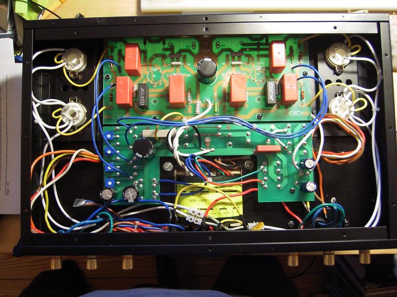

I have made a picture of the inside, have a look. You can see that i already used a blank screw to fix the psu middle to the chassis. I scraped the paint away from the chassis at this point. Maybe looks a little messy. The red caps are WIMA MKP's, which are used quite often in audio circuits I believe. The black Visaton is the 1uF MKP from the input stage (screen bypass of 6F2 not coupling cap!). I used it because of it's 20mm mounting distance but it's designed for crossovers so I guess it will be ok. Of course I changed the output terminals and got me some real RCA inputs along with. These Terminals are hell to solder, I found out (I want to connect the wire to the inner rod and not to that flimsy thing besides).
Ah, and if you winder how i mounted the amplifier board, that's etched flipped-over! So my copper side faces upwards, but as you can see it's better for me anyway! I wonder why it is designed to be on the other side in the first place...
How have you done the feedback resistors? Switching them😕

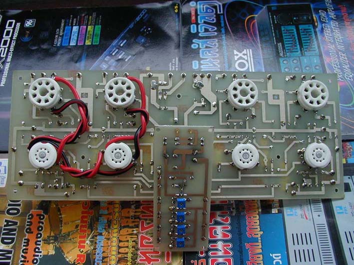

uumm, no. I mounted the tube sockets at the foil side. This is possible because the pins are standing outwards a bit. I'll check it once again but I think I got the pins right.
You know I did not just flip the board, it is really printed mirrored left-right! A pruduction fault.

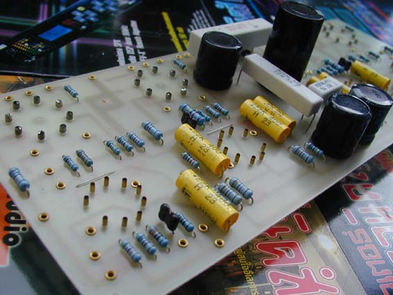

Well if that's the case then MY pcb is the production fault or yours is a revised version! Dang! Hey, wanna swap boards 😀
Here's a pic of mine looking from the topside/front:

After looking more closely at your PCB where the tube socket mounts, everthing looks spot on!
9AE starting at top right pin as seen in picture, going clockwise:
1 - triode anode
2 - pentode grid
3 - pentode screen grid
4 - filament
5 - filament
6 - pentode anode
7 - pentode cathode, suppressor grid G3
8 - triode cathode
9 - triode grid
Looks great! 😎

What exactly are you using for tube sockets? I'd like to try that someway-day! What's that small board with those eeh hemm transistors (FET's I hope)? Yeah I've made quit a few pcb's in my day... got about 5 gallons of ferric chloride and a nice stash of blank boards that's been calling my name!
Looks like a circuit for the bias, but what are the transistors for. Ahhh, I think I know now, current sources?
