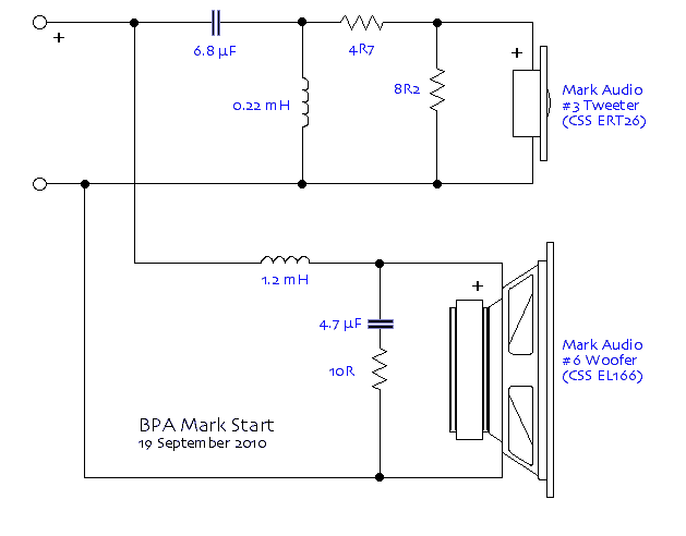

The 1st thing i thout to mwntion was the Woden TL for these with the Mark Start XO (which can be used in any case).
http://p10hifi.net/tlinespeakers/Woden/downloads/EL166-MAno6-ML-TLs-280411.pdf
I have a sim for an 18 litre miniOnken but have not drawn it up.
BPA has taken down the XO drawing, but i drew my own.
dave

Thanks for the XO drawing, Dave! I found the Woden TL too but it's rather big and I live in a tiny apartment 🙂 I'd happily pay/donate for the miniOnken though.

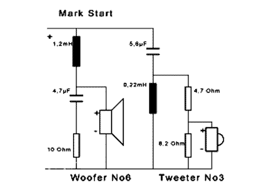

I dug up an old copy of the original mark start xover and it shows the tweeter cap to be 5.6uf instead of 6.8uf as in your drawing, Dave. Know which one is right?
The BPA image of the XO has 6.8, but at its native resolution it could be read as 5.6.

O.K. I'll admit I had to google "native resolution". On my drawing it's clearly 5.6. Google couldn't help me with "native imperial" though. Folks just don't use that term around these parts. I'm sure your email will clear it up for me. Thanks
Oops- my copy is from oaudio.de. I'd post a link but I got a warning from mozilla. Maybe they misread it.

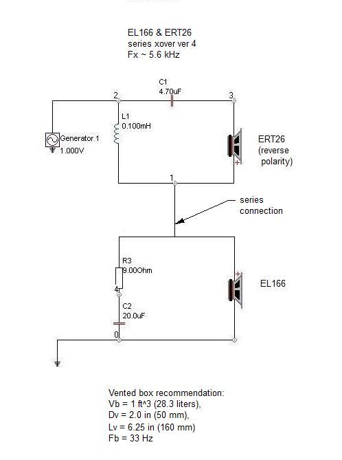

Hello Lohengrimas,
It's been a while since your original post. Not sure if you have found anything that you want to build yet. I dug around in my files and found a design that I did for a friend about 6 years ago.
The box was vented, 1 cu. ft., and tuned to about 33 Hz. The crossover is a series. Hope this is useful . . . and not too late. 😉
Dave R
