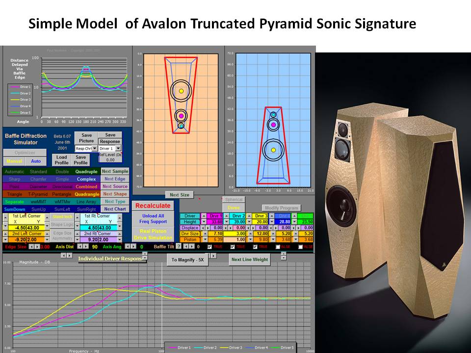

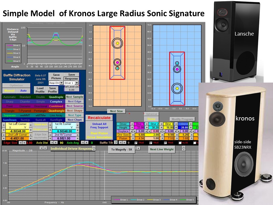

LineSource, whilst not dismissing stepped baffle designs, seems to suggest that maybe their usefulness is a touch overrated; Giralfino is deeply sceptical; you find them a crude solution and we both find them ugly! Obviously, If I thought that such designs might produce something wonderful, I'd use fine detail to try and overcome any aesthetic deficiencies - if...

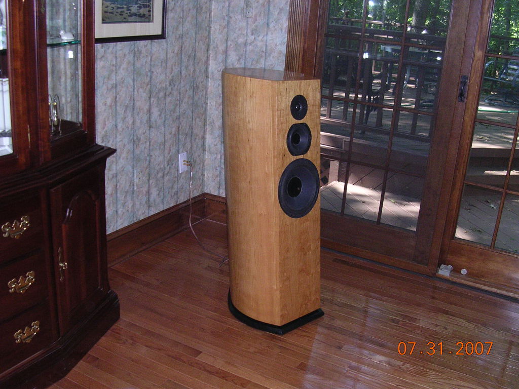

Hi Paul,
They were a custom job, 10" sealed woofer, 5" mid, dome tweet,
I did the cabinet design and Rick did the driver measurements and crossovers. They are one of the best sounding speakers that I've heard. I've gone to HiFi shops to listen to expensive speakers and have not been impressed, except for the cabinet work, for big bucks you can get a real pretty cabinet and finish. Of course comparing an optimized home system to speakers in a store isn't really a totally fair comparison. I have heard some of Rick's commercial kits and they sounded great.
In my cabinet design the time alignment of the drivers was achieved by driver location and slanting the speaker at an angle.

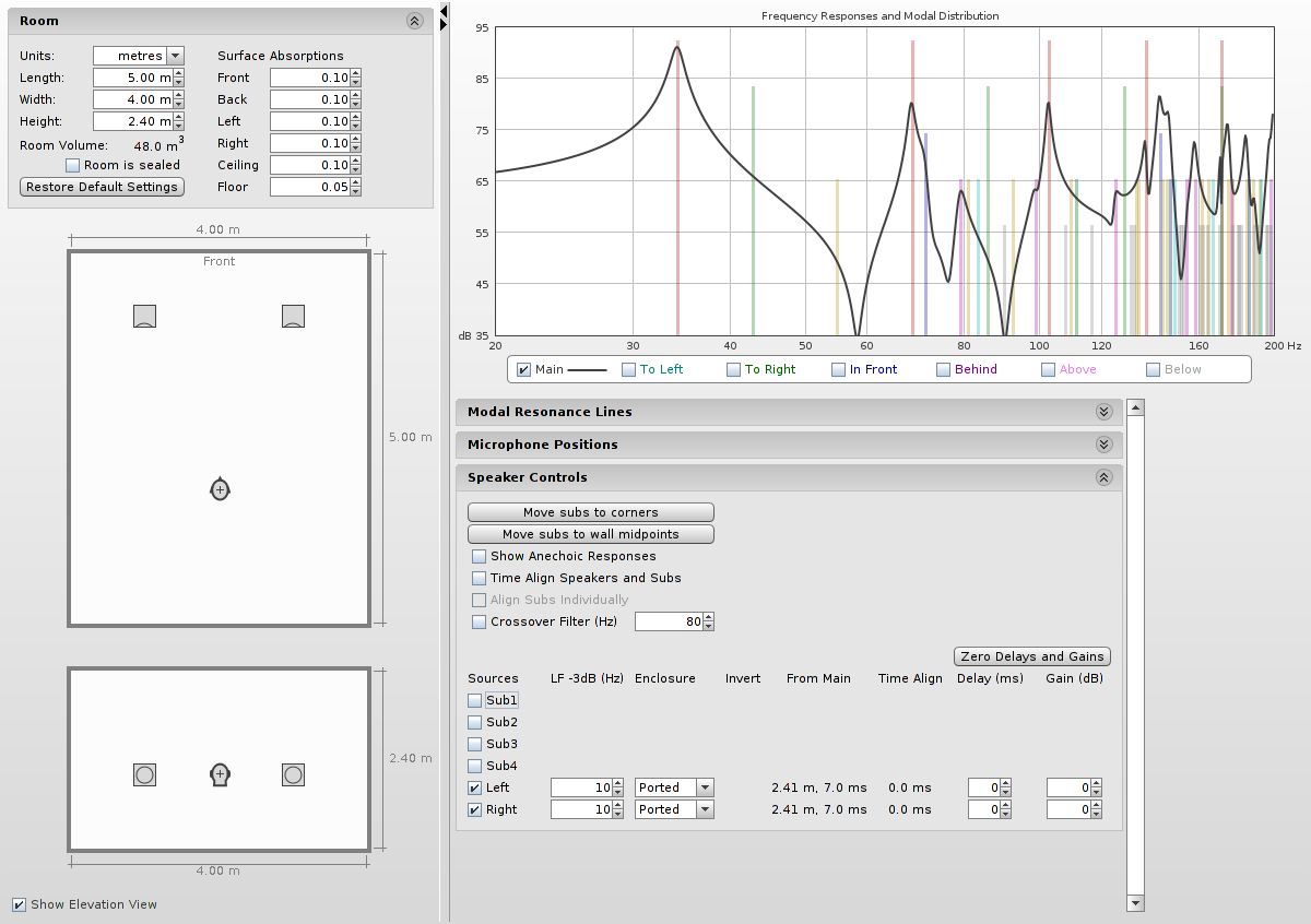

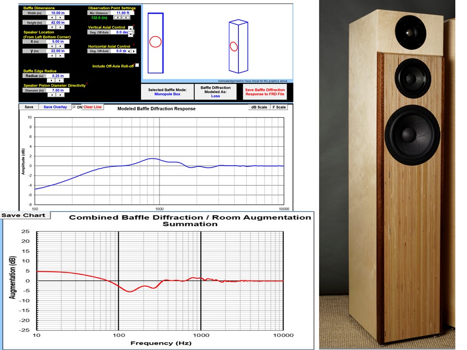

In post #11 LineSource posted pictures of what looks like a nicely balanced and good value speaker (assuming sensible crossover). I don't know the details or how well documented it is?On the basis of your last response, I hope I'm right in assuming that 2 x 7.5/8 woofers per speaker (re "most commercial designs") have a decent chance of achieving the same objective as a single 10/12 - obviously, I should explore this a little more. If this is the case, then I'm in a good place to weigh some of those twin woofer Selah design's (starting with the "Essenza") against the SBA 10 - interestingly, both designs use the Satori drivers.
At low frequencies what you hear is principally the room. Unlike at higher frequencies the speaker details are relatively unimportant. Pretty much all that matters is how much air can be displaced while keeping distortion levels reasonable. Reasonable would be below 1% possibly 3% THD since we are not particularly sensitive to distortion at low frequencies.I'm not quite sure where transmission lines stand, as far as "high fidelity bass" is concerned. In any case, the epic "Thor MTM" thread suggests to me that it might be rather a tricky path to navigate....
High fidelity bass is about distributing subwoofers to control the room response. If you don't do that then you won't hear high fidelity bass. For example, a pair of main speakers with a flat frequency response down to 10 Hz in a typical room are going to sound like the plot in the first attachment. A single subwoofer placed behind the listener, inverted and delayed by the time of flight from the mains will give a response more like that in the second attachment. Of course this is not what a typical audiophile would do with a single subwoofer but it is what pro or someone with knowledge of room acoustics is likely to do. The software, Room EQ Wizard, is free to download and is useful for understanding some basic subwoofer layouts.
Only measurements at different angles on the final speaker will produce accurate SPL curves, but simulators provide excellent information for early decisions. Diffraction simulation of different baffle designs (large edge radius; truncated pyarmid, small edge radius narrow box) help the designer select the desired sonic signature. Baffle/room simulators cover speaker placement and room gain.
Attached simulation shows in-room bass for two 8" woofers(like Sony SS-AR1). (WxHxD: 320 x 1055 x 450 mm)
The Kairos and SB10 use one 10" woofer. A 12" woofer is sometimes mounted on the side panel.

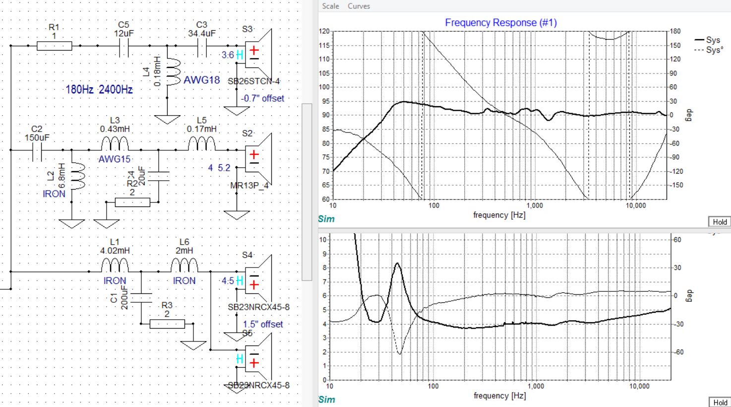

SB Acoustics 3 way
one = $366 drivers + $90 crossover
1" SB26STCN-C000-4 $40
5" Satori MR13P-4 $132
2 x 8'' SB23NRXS45-8 2x $94

So thanks for gently nudging me forward. Not too clever at interpreting graphs, as I'm sure you've figured already, but I take it that thumbnail 1 = bad and thumbnail 2 = good and just to let you know that it's still me, here's a really silly question for you:
If, as you suggest (and I've heard it said before), a sub is better thought of as a means for controlling room response, can a sub do this AND act as substitute for a 10/12" single woofer (or 2 x 8" ones), or would it be better to see it as more effective when working alongside balanced 3 way 12/10 - 5/6 - 1 speakers such as the SBA 10?
Thanks for the tip re EQ room wizard - even if in the end I just use my ears - which, by now, are probably in much better nick than my brain.

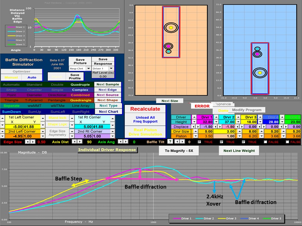

Hi Paul,
This is an example of a sloped baffle for time alignment, in this case due to driver placement the slope is about 8 degrees from vertical to give good alignment at the listening position. This is also taken into consideration in the crossover design. The woofer position was determined by in room measurements that gave the smoothest response in the room these were intended for, then the mid/tweet were mounted as close as possible. The slope was determined by doing the math from the design listening distance (~ 16-18 ft) to the acoustic centers of the drivers. Simple trig, built a spreadsheet model and adjusted the angle to yield the minimum difference between the distances between the acoustic centers and the design listening spot. The wider baffle for the tweeter and mid did seem to give things a more spacious feeling compared to narrow baffles that I've heard/built. Later I fitted the baffle area around the tweet/mid with felt with the idea to reduce diffraction. I'm not sure if it did much, but it made me feel better. No sub needed. If you can build your own cabinets you have a lot of freedom with design.
Paul
Paul

There is more to it than that. The plot illustrates how a sub can absorb axial room resonances but there are other considerations. If you cancel a lot of sound to get an even response then that even response is going to be quiet. So you need a lot of cone area so that the sound that isn't cancelled is loud enough. It also uses symmetry to cancel some of the modes but real rooms are often not symmetric requiring subwoofers in more than one place. So in the real world good implementation tend to use perhaps 4 subwoofers and some DSP so that the subs can act differently at different frequencies.So thanks for gently nudging me forward. Not too clever at interpreting graphs, as I'm sure you've figured already, but I take it that thumbnail 1 = bad and thumbnail 2 = good
Struggling to interpret graphs will cripple your ability to gather evidence and lead you to being blown this way and that by marketing and nonsense.
