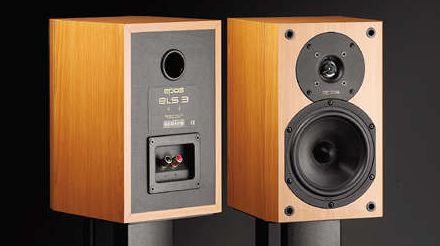

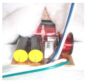

From the datasheet, the design philosophy behind your Epos ES22 speakers seems "odd" by today's design knowledge.
1) The tweeter uses only 1-capacitor for the crossover, and the tweeter is located several inches above the midrange on the front baffle such that lobbing will occur.
2) The 6" poly-plastic cone midrange is run full range with no crossover components.
3) The 6" poly-plastic cone woofer uses a single inductor for the crossover.
I would not expect "audiophile grade" sound from this design.

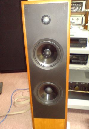

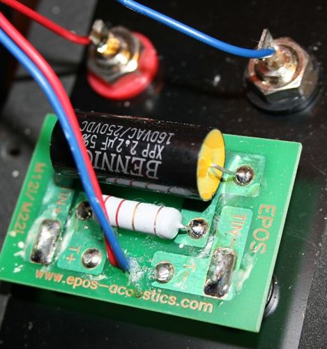

lupo 1, you are right. We ARE fanatics. Here is your ES22 (below) for reference. 😀
Epos is a tremendously interesting company. Now owned by Michael Creek rather than Robin Marshall.
I'm not sure I actually agree with Robin Marshall on everything, but I listen to his ideas. What he did tremendously well, was build well-behaved polycone bass units that needed little filtering to work well. One of my earliest speakers was the Mordaunt Short MS10i, which bore a close resemblance to this Epos ELS-3 design.
I think you can see the pedigree. Robin tended to use very simplistic filters, as in the famous two way Epos M12i. A mere 2.2uF capacitor plus a slightly mysterious 47R resistor on the tweeter.
As it goes, Michael Creek tends to use more complex, steeper filters these days with the same well-behaved drive units. Which to me, means they go louder with less distortion.
All a trade-off. Who knows who is right? 🙂
But, as a hobbyist, I think I could have great fun giving your ES22 a more complex filter. They are too good to throw away.
