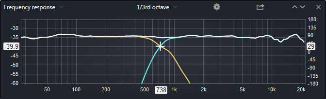

- these filters were added:
Butterworth 30, 36, 42, 48 dB/oct
Linkwitz-riley 36, 48 dB/oct
Bessel 30, 36, 42, 48 dB/oct
- now, when the mouse cursor is over a graphic, you can display its position by pressing the SHIFT KEY

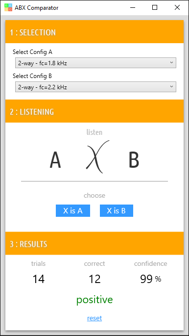

ABX Comparator
We tend to be influenced by our prejudices and this is especially true in audio. What we see or what we know changes what we hear. The ABX test is a tool to compare two filters blind, and thus to reduce bias. Within EKIO the ABX Comparator allows to compare two configurations blind. It can be used for example to determine if one can hear a difference between two different cut-off frequencies, different slopes, different target curves, and so on. This is a very interesting tool that often surprises. The ABX Comparator is available in the Full version of the software.

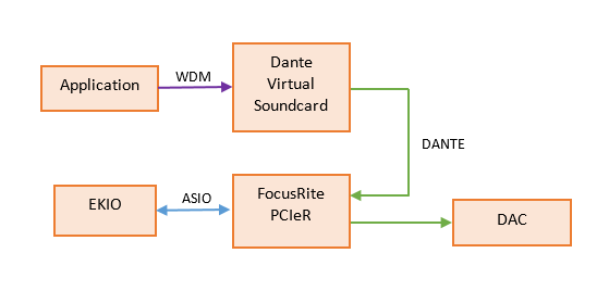

According to the information available on the FocusRite website, there is no routing function that would direct the WDM audio stream to the PCI card. It seems that to do this, you have to use Dante Virtual Soundcard. It allows to create a virtual sound card on the PC that receives the WDM stream and propagates it on the Dante network.
