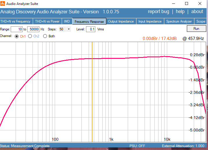

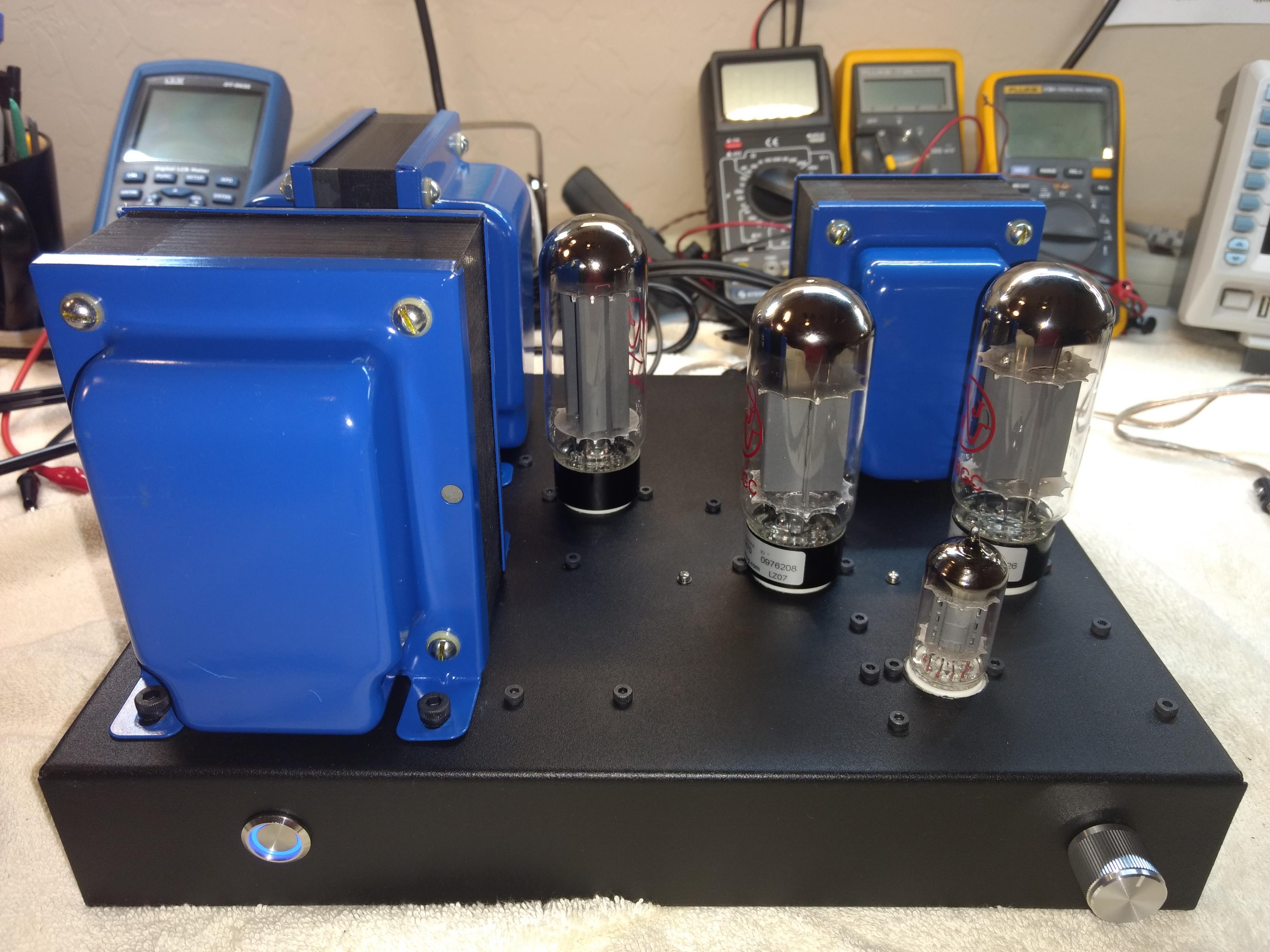

I just completed the 30 Watt Mono Block Amp build. It works but has some issues:
1. reduced headroom
2. high THD
3. frequency response
These issues are probably a result of my inexperience in building. I am hoping that someone on this thread is willing to help me work through these issues before I build the 2nd Mono Block.
30 Watt Mono Block issues resolved
I've discovered that the feedback circuit was the cause of all of the issues with this amp. Once corrected, the amp performance is excellent(see attached analyses). I am very happy with amp and can't wait to build the other mono block as soon as parts arrive.

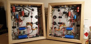

Hello again - im very grateful for your reply thank you , i have fitted all the tag strips by means of riveting to my 4mm alloy top plate , the face of the top plates are now painted - so as are the rivet heads , in theory all the tag strips are grounded to the top plate but i guess i will still run the ground wire around them albeit slightly modified i believe this will be fine but i will do something with the audio grounds - my speaker posts and audio in rca are fitted to my oak plinth and not the top plate so already isolated from the tag strip grounding , i will put some pics up sometime soon of my work -- im really pleased to know your happy with the circuit
Chris

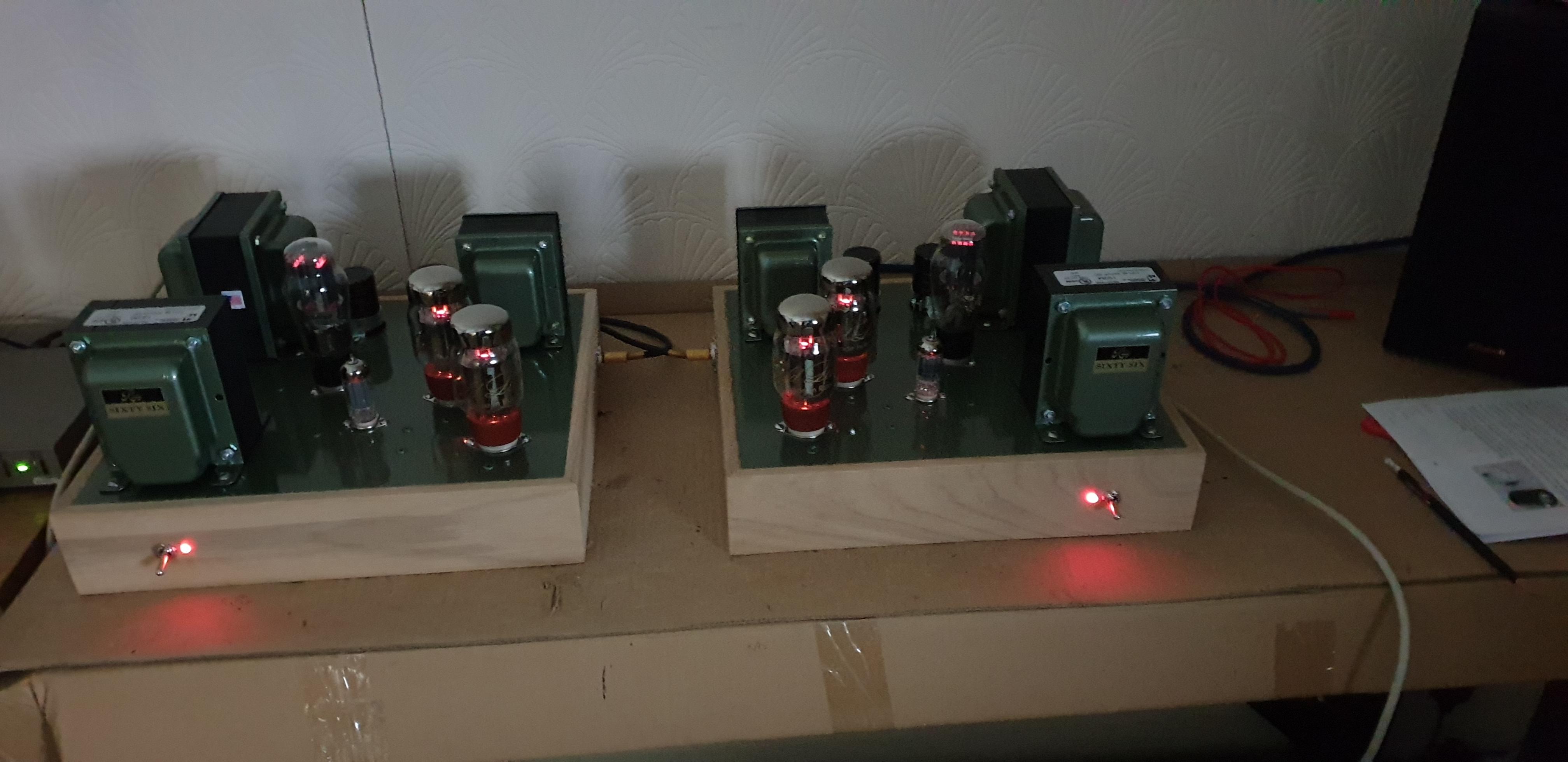

kt66 blocks

well they have about 10 hrs so far - they sound incredible , fantastic vocal ranges with really great bass and sharp high range - all voltages are spot on and very quite - nothing humming through speakers at all the mains transformers have a very tiny amount of humm - im really over the moon with them -- no problem feeding them either just a crappy workshop preamp just now - so thats my next project !! but as i said before i need help with adding a tape loop in

A couple of things could cause negative feedback problems. If the output transformer secondary were connected in reversed, you would wind up with positive feedback instead of negative. To determine if connected correctly, disconnect the feedback loop at one end. Either listen to or measure speaker output voltage with a tone. Connect the negative feedback loop and the level should drop slightly. If the secondary ground leg is not well grounded, you may get some weird feedback characteristics. A note on grounds: The circuit layout drawing does show all ground points wired together. It is not good to depend on the chassis for a common ground. Besides the possibility of terminal grounds becoming loose or corroded over time, copper is a much better conductor than a metal chassis.
