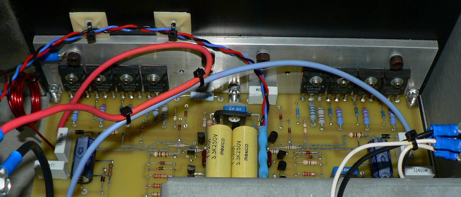

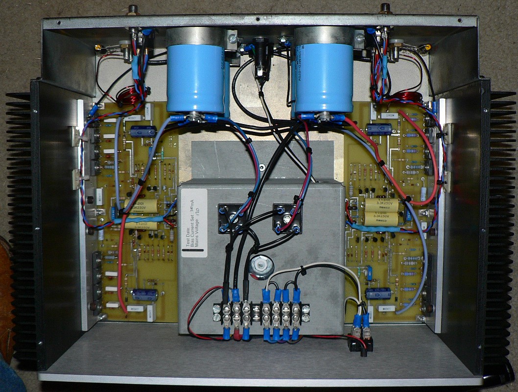

Well in less than 24 hours things have gone from okay to oh sh** I'm fully screwed. Tonight I went back to the MUSE160 power amp and it had a buzz - plus heat on the right channel AND a slight hum came from the right speaker. I switched off, unplugged the speakers and measured DC offset: it was wild ... from 12mV to 140mV on the LEFT channel and 1.2mV to 50mV on the RIGHT channel. Left it for a few minutes to scratch my head and have a damn good Scotch and then came back, connected up speakers and measured again; it was now around 40 to 50mV left and 8mV right. Connected a source (CD) and ha ha ha ha ha ha - now I suddenly have really bad right speaker distortion 🙁 WTH???
Swapped to the Threshold SA/3 right away just to see if it was the Muse amp or if I had fried a speaker - no - speaker is fine- but the Muse's right channel is 'toast' in some way. I have no idea why but I'm really getting the idea that 'him' upstairs doesn't much like me much.
Anyone know of a good tech repair shop in Colorado because I'm not going near anything electrical for a while. Oh, I almost forgot to mention - the central heating thermostat died earlier today ... and after taking a few pics to post ... uh huh you guessed it ... the flash stopped working on my camera.
Anyone got a handy solid wall I can drive into 😡😡😡😡😡 Or poetically a spare length of good STRONG COPPER wire they're not using 🙁
Some Muse160 pics : probably unobtainium transistors ?

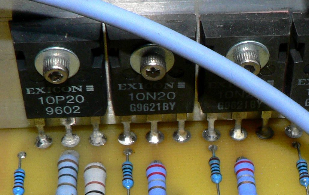

What you write are most possibly the HF oscillation in the preamp I mentioned earlier in this thread.
When the amplifier now was running with NO load (unplugged speakers) the HF oscillation damaged some transistors in your right channel.
The soldering of one of the transistors look like it have been running very hot.
If it is HF oscillation that causes the problem the damaged transistor are often broken in such a way that it is left "open".
Check for the voltage over the emitter resistors and I would expect that both either PNP or NPN transistors are broken.

The transistors: do the letters/numbers beneath 10N20 and 10P20 mean anything? I've Googled the numbers but only get results for 10N20 and 10P20 with no other letters / numbers. I've not seen these transistors before but from Googling I saw them in a review of a Belles amp.
