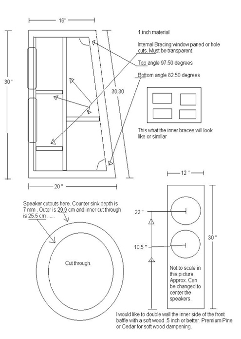

Its ok 😀 a little love and some comprimise and we settled on this. I will do it in real wood. The layered plywood stuff with the good outside sheet. Know what i mean ? I have a good carpenter so ill get it miter cut and stuff to hide as much as possible. have to order 4 d10g from HI Vi now. Going to have a stereo pair. I dont want to bother trying to tame anything in my room with a bass reflex box and this is the best i can do sealed for under 600 bucks. All i need now is a good X-over 12 or 18 db for 100 hz and ill be set for a bit. Have to keep these Krk for a bit i guess.
Anyone know if the KRK Rokit 8's are using HI Vi ? If you look at my Pic thats a rokit 8 and i swear that it looks like the cheap Hi Vi 8 inch on the Solen website. Sealed enclosure Q is .656 Fb is 51 Hz. In room should satisfy all concerned. I know i satisfied all concerned. Now i have to run around and try and find sheets of 1 inch Pine and convince her THATS better looking then birch. hehe
