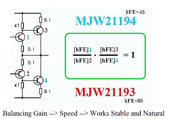

:bigeyes: I think I've solved the mystery! :bigeyes:
This circuit that Stee is talking about is a measuring filter for
an elektor T-class power amp from 2004! This explains the high voltage tolerable op-amp input.
Stee seem to have taken this device for measuring distortion in D/T class amps and rebuilt it to an amplifier!!!!!!
Do'nt know what to say! Are you joking with us,Stee? 😀
Stee!
I dont think your idea with this amp is stupid, not until you have explained to us who are wasting time trying to understand. I cant see the point with this config!:bawling:
Why are you modifing an old elector measure probe circuit, why not a ordinary pre-stage? Is it because you had the Pcb:s at hand?
yes sure
use an existing driver is more easy
specially if it's nice (full balanced as Rotel)
and there is PCB ready😎
often happens that the technicians are lost in the details
losing sight of the overall vision:
did you ever wonder why the CFP oscillates spontaneously?
you know why the EF architecture is the most popular? (but minor of CFP)
know that complementary bipolar power devices
have a large difference in gain?
my message is that the solution is ready
no matter if the key is from Elektor
please edit your amplifier !
this is not stupid genius:bigeyes:
I now can see the point, too (but haven't played it through).
But, Stee, WHY are you obscuring you basis idea with laconic posts and misleading schematics and thread title?
Why not nailing it down to the core of what this idea is all about, right in the first post?
- Klaus

who wants to edit the layout of CALIDARIVM
to improve it can do
for example, new OP-AMP Input
keep in mind that the driver resistance
depend on how big the heatsink
the lower the resistance that the final pilot
the lower the distortion of cross
important to note that the signal passes through a single point at the output stage
and that the NFB resistance has no capacitors
the whole scheme is completely complementary and...
CFP balanced stage is a really brilliant idea:xeye:
can drive that also with a nice voltage amplifier as A-100
http://www.audio-gd.com/enweb/pro/diy/MD.htm
other important feature about the Elektor ex-filter is again a
CFP on output stage: the high speed of this configuration
create a very accurate feedback
