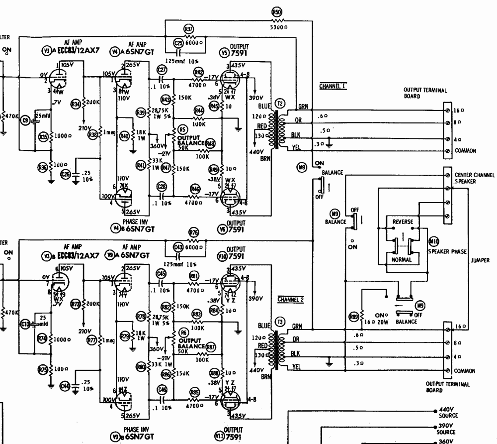

Relevant section of ARC schematic for comparison.
Here, 4 ohm GND served an actual useful purpose.
