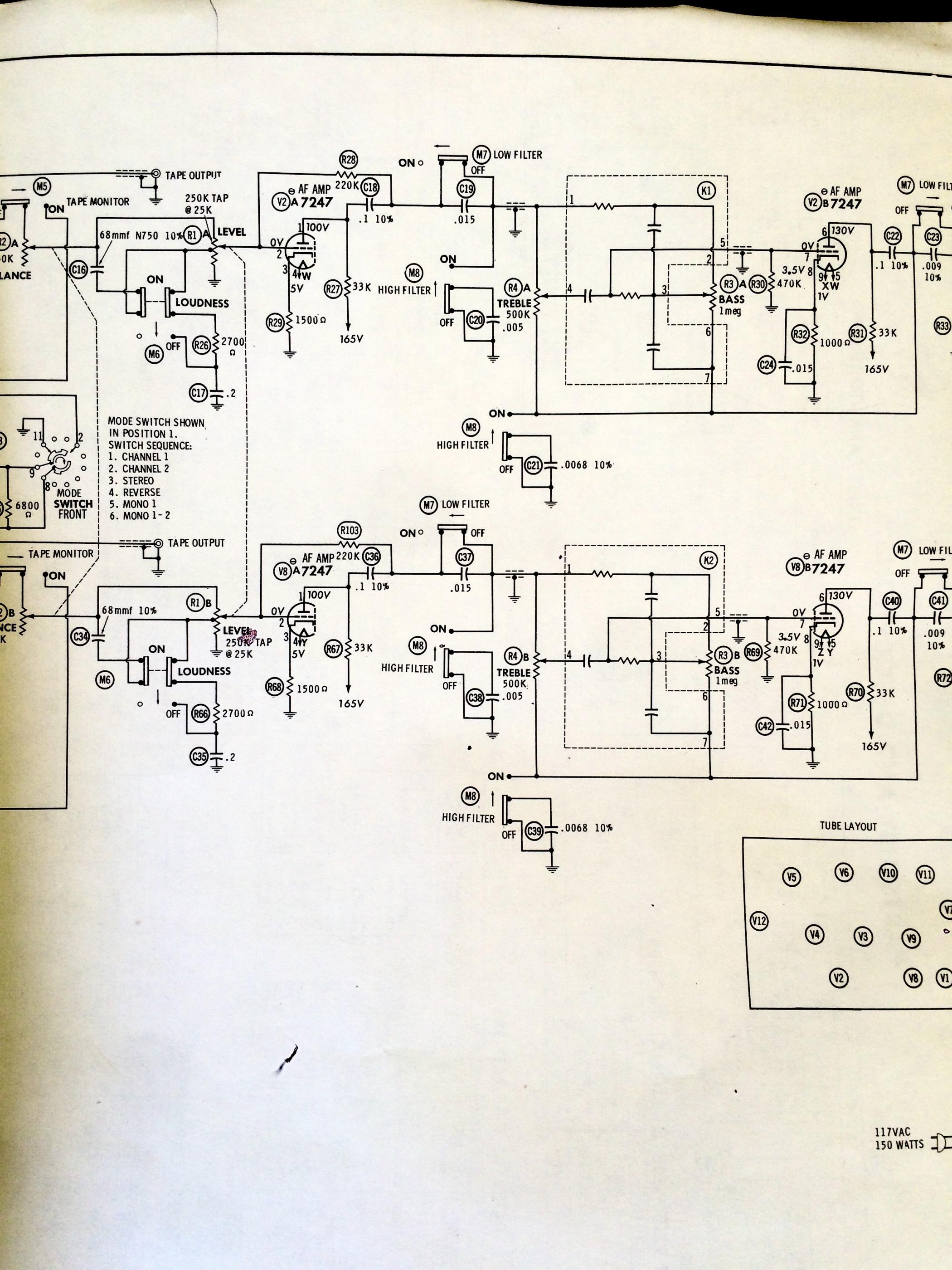

Hello all, I notice a lot of vintage tube intergrated amplifiers did not come with preamp out puts and my Eico St70 is one. I'm putting together a triamp system for a set 3way of speakers im building. My idea is using the Eico's phono and preamp section to drive all of it,use it's amplifier section to drive the midrange drivers and solid state amps on the low and hi frequency drivers. My problem is I need pre outs for the solid state amps. I'm not an engineer nor a designer but I can sure read and understand schematics. I've attached a couple pics of the Sam's Eico schematics for reference. Here are my thoughts. Could I come off V2b (7247) section behind the .1 capacitor before the low filter switch or go before the .1 cap add another .1 cap in series with the new pre out jacks, will I need a 47k resistor to ground at the pre out as well? Or will I need another gain stage? Is all this possible? Any advise will be much appreciated guys.

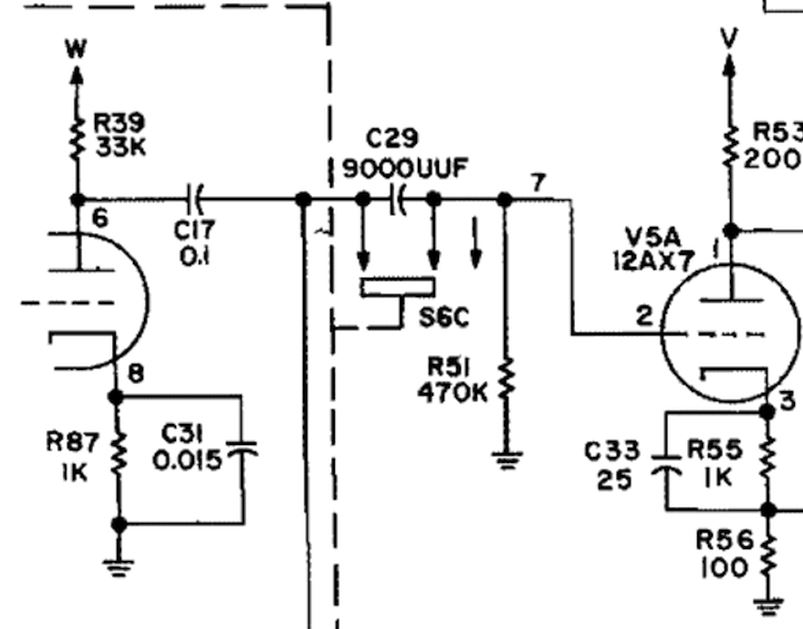

In order to retain the full signal shaping capability of the preamp, you need to break in before the power section, just after switch S6C.
Are you planning on a full preamp-out/amp-in implementation?
In any event, you really need to buffer the preamp O/Ps you are creating. Cascoded DN2540N3-G (TO92 case) depletion mode MOSFET pairs rate to get the job done for you.

Hi, if I am not mistaken the ST70 has tape switching. You can use the tape monitor jacks for a preamp signal. Here is the description from the EICO manual. I quote from the manual.
"The TAPE OUT1 & TAPE OUT 2 jacks are intended for feeding signal out to the "line" recording Inputs of a tape recorder. These are indedpendent output for channel 1 and channel 2, respectively. They are unaffected by the LEVEL, BALANCE, BASS, TREBLE, HI FILTER, AND LO FILTER controls. "
I guess if you intend to use any of those functions in your signal then another solution like Eli's needs to be considered. cheers.

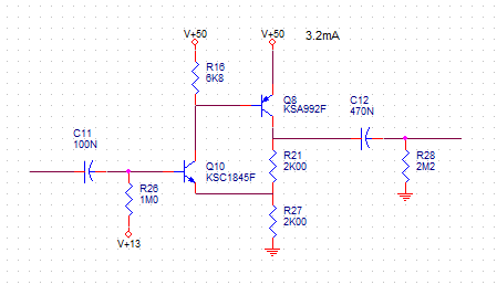

Here's a buffer-with-gain example design that might be useful. It can be altered to operate on a negative supply rail by simply swapping the transistors. Gain is fixed at 2X (6dB) by using equal-value divider resistors at R21 and R27. Q8 collector should settle around 1/2 of the supply voltage, so Q10 emitter is at 1/4 supply voltage and its base bias is 0.6V above that. Input bias current is around 1uA, so the "V+13" source might need to be adjusted slightly higher. That bias source can drive both buffer circuits. It can be a simple divider off the V+50 rail, with a decoupling cap to ground. There should be plenty of dynamic range even if DC bias conditions aren't perfect, but I recommend 1% resistors at R21 and R27 to insure gain matching across channels. Output coupling cap value is a function of downstream load impedance, of course, but I wouldn't go under 0.47uF.
To make a unity-gain buffer, just short out R21 and replace R27 with a single resistor of 3.9K. The bias source becomes 25V in this case. A minor flaw of the unity-gain case is that oscillation can occur, especially when transistors with good RF characteristics are used along with high bias current. If that happens, just insert a small resistance in series to Q10 emitter. It's unlikely with these transistors at this bias current.
