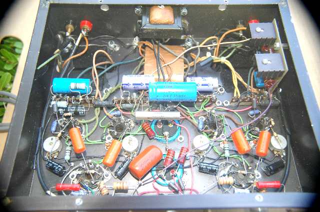

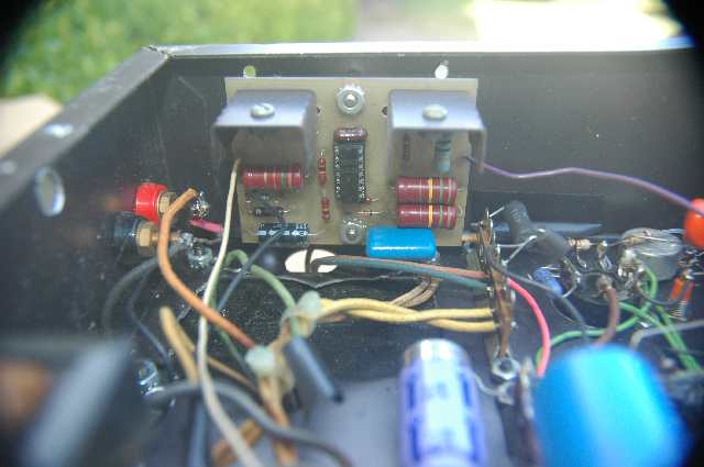

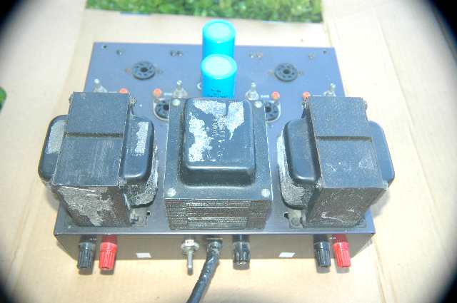

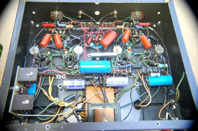

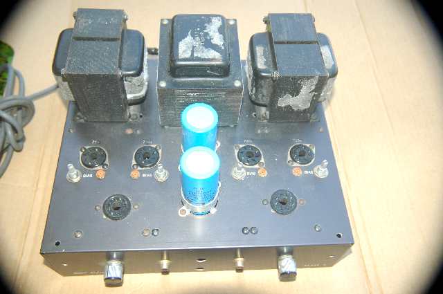

Some Pics
Pics of custom power amp using EICO Iron.
The thing tacked to the side in the top left picture might be a aux power supply, but I'm not experienced enough to know at this point.

I was looking at it after taking the pictures and there are only 6 octal sockets showing. I knew that, but the implication of it had not sunk in.There isn't a rectifier tube, so the power supply is all buried underneath. I'm going to have to make a schematic of the amp to understand what is happening. Is there a sensible way to do that or do you just dive in
and stay away from the fridge?
A another problem I have now is that I need to find (be told) what *Octal* tube (or tubes} can go in front of each pair of the 6P3S-E's output tubes (I propose to use).
This tube would be the equivalent of the 6AN8's in front of the KT88 in a Dyna Mark III.
The Mark III is a 6 tube(ignoring the rectifier) power amp also.
I believe it is OK to discuss this amp on this thread as it is about the use of EICO
iron.
Is there a site with an English data sheet for the 6P3S-E ? I haven't found one yet.
Any help would be sincerely appreciated.
Thanks, Victoria
Yours is a third order threadjack so I wouldn't be too concerned about that. But if you were to start a fresh thread it might get wider viewing. Up to you.
I start by drawing the power supply on one sheet, the phase splitters and power tubes on a second and the front end on a third. That compartmentalizes things and makes the inevitable revisions less tedious.
I don't have a ready answer for you on the phase splitter or datasheet. Once you get things drawn, the selection of a phase splitter will be easier. LTPs with CCS are very popular around here right now and might be worth investigating.
