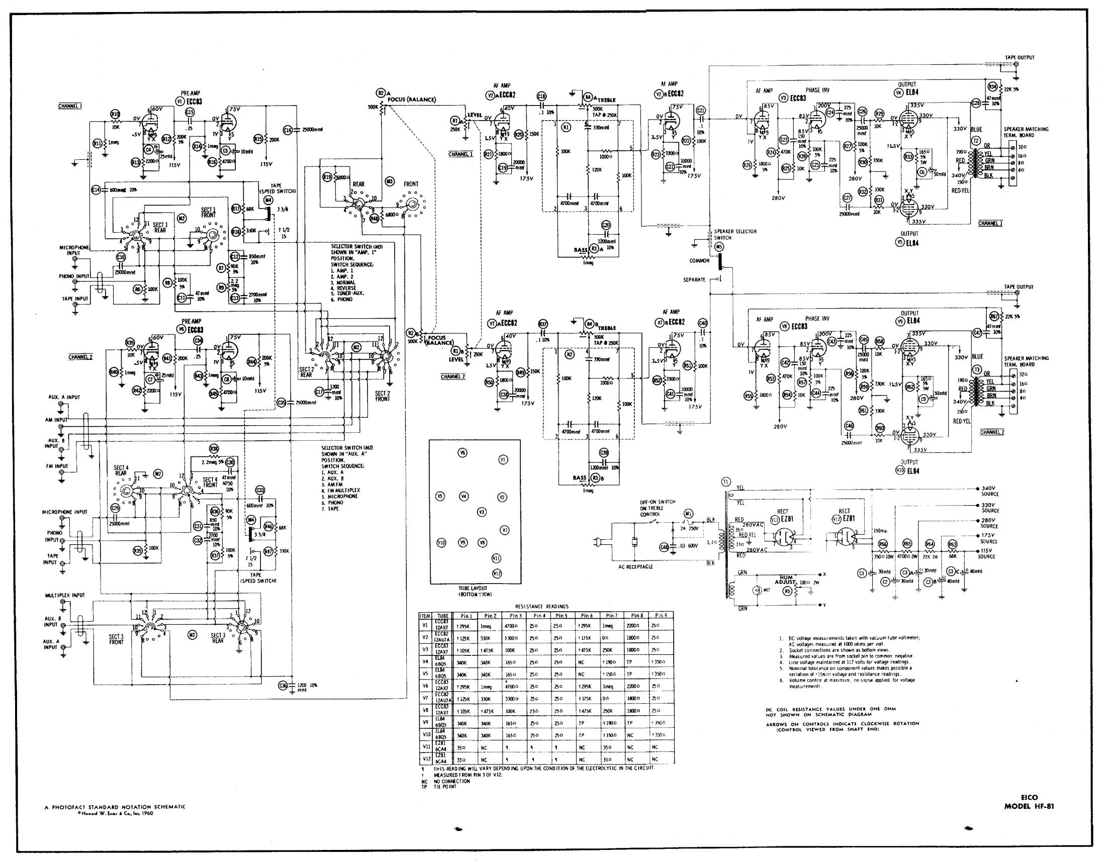

I'm a newbie restoring my first amp, and it happens to be an EICO HF81.
As you know, the "Tape Out" section is basically a "Line Out" without any volume control or any of that sweet treble/bass tone control. I have zero use for a Tape Out, and I'm guessing *most* people don't use a Tape Out anymore.
I've always wondered how to go about tapping the circuit where I could effectively make a "Pre Out" instead- one that maintains the active tone stack and volume control functionalities.
Has anyone done this with an Eico HF81?

Did you actually try it out? The schematic shows the tape out jacks as being wired after the volume and tone controls. In fact, they're in parallel with the input to the power amp section.
Yes, the schematic (uploaded) shows preamp out, not proper recording, jacks.
However, I'd be cautious about using them, unless they are buffered. Notice that those jacks are driven by 12AU7 section plates. The I/P impedance of many modern (particularly SS) devices in parallel with the HF81's power O/P section will load those common cathode sections down. 🙁
Like many units from that time frame, the HF81 has tape head I/Ps, which are (IMO/IME) irrelevant in today's environment. I will repeat a suggestion I've made numerous times. Hard wire a single set of I/Ps to the low level mag. preamp section, which is locked to RIAA. 50 plus year old, corroded, slide switches in mV. level signal circuitry constitute a prescription for trouble. All other I/Ps should be line level. An inexpensive Lorlin brand rotary switch can be purchased from Mouser to modernize the source selection capability.

I think you could get away with a tube amplifier of e.g. 500k input impedance without much trouble, but not much more. But then there's the issue of switching off the internal power amp, which should be done if not being used...or loaded at the output. As to the other suggestions, good ones, but probably not suitable for beginners. The HF81 is one of the more collectible integrateds out there amongst the vintage tube guys, so the effect of major modification on value should also be considered.

jmsent- I see the tape out wires once tied to the mono/stereo switch (now bypassed), so I guess it really did maintain volume and tone control…weird set-up :scratch1:…..but now that I know it's an unbuffered output- I'll just leave it be.

It seems clear that the Sams schematic has the preamp outputs mislabeled as tape outputs. The Eico schematic probably is correct. And those preamp outputs might be fairly robust because there's a feedback loop around the driving stage. Perhaps the Eico manual would offer a preamp output impedance spec?
I should have spotted that the low level mag. preamp section uses AC heaters, sooner. :sorry: If a DC heater supply for those 2 tubes is not going to be undertaken, use the Sovtek 12AX7LPS in those sockets. The 'LPS is genuine 7025 equivalent, which contains spiral wound, hum bucking, heater wire.
BTW, constructing a buffer is not that big of a deal. Even opamps configured for unity gain will be quite transparent, provided they never clip. A suitable bipolar PSU can be constructed from an inexpensive AnTek power trafo, 4X Schottky diodes, some caps., and 7815/7915 3 terminal regulator "chips". Pick an opamp with JFET I/Ps whose reputation is good. Such a buffer would be a good idea too, if the preamp out jacks were altered to be true recording O/Ps. "Ripping" vinyl to computer resident digital files would be a recording O/P use.

If you use an op amp buffer, put some protection from positive peaks from the inputs to the B+ line to the op amps. Depending on the dv/dt on turn-on and off, you could get peaks above the supply voltage for the op amp. They don't like that very much at all! You should probably protect for the negative polarity as well.

Easy. Look for a unity-gain-stable part with jfet input and a good strong output, low noise, etc. High dollar parts would include the opa2107, ad8620, opa627, probably others.
On a tighter budget a pair of opa604 chips might be just right.
If you have 12v or better yet 12vct heaters in this amp (I am not familiar and didn't look) you could run the buffer's supply off of that. It will use almost no power compared to a single filament. It doesn't need to be regulated, just well filtered. Does need to be a dual supply if you want to avoid capacitor-coupling the output buffer as well. you can use a tle2426 or another cheap opamp to create a 'virtual' ground between the power rails.
The output from the amp will be capacitor coupled but there might still be a turn-on thump. strapping a couple zeners across the inputs might take care of transients for you.
From there it's just a 500k resistor from non-inverting input to ground, tie output to inverting input, and apply power. The opa604 has a facility to trim output offset (since it's not a precision part) so you might add the trimpots for that.
