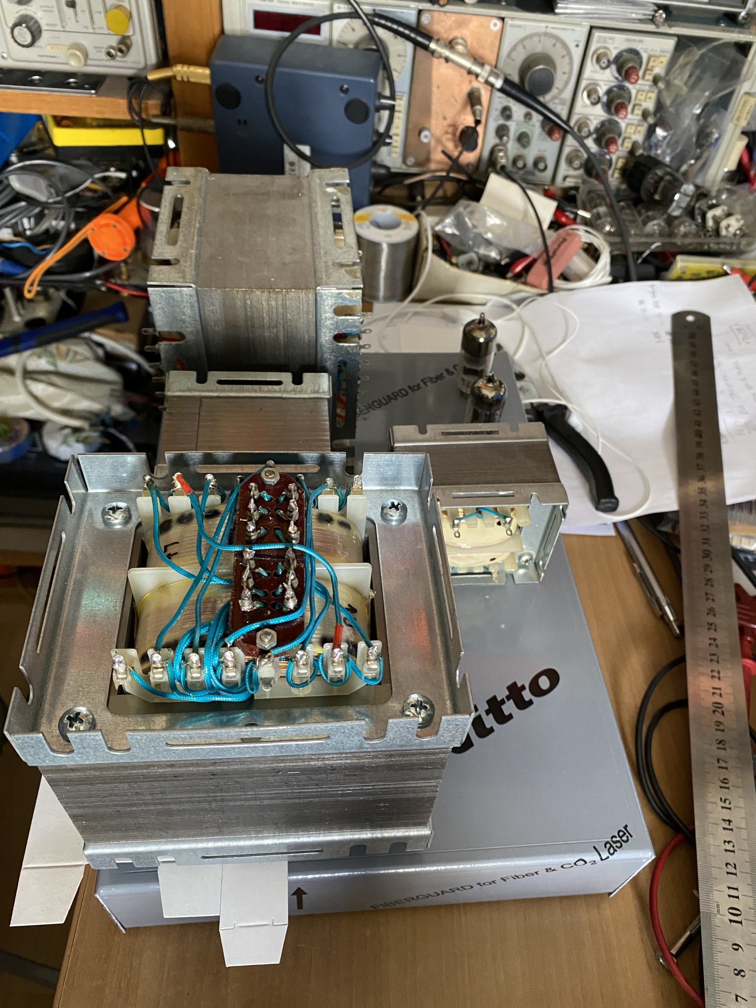

I would definitely propose this guy! I know him in person and he is winding all my transformers. He is capable of very good quality transformers and he is a very knowledgeable guy! Highly recommended from me as I have used a lot of his opts and chokes. Also he can listen to your very specific needs and design customizations and last but not least all done with excellent craftsmanship and very low prices. His personal e-mail is thermioniclab@gmail.com if contact him outside eBay mention my name and you are going to save even more on his prices. Check this one he built for me a while ago based on my split design…
