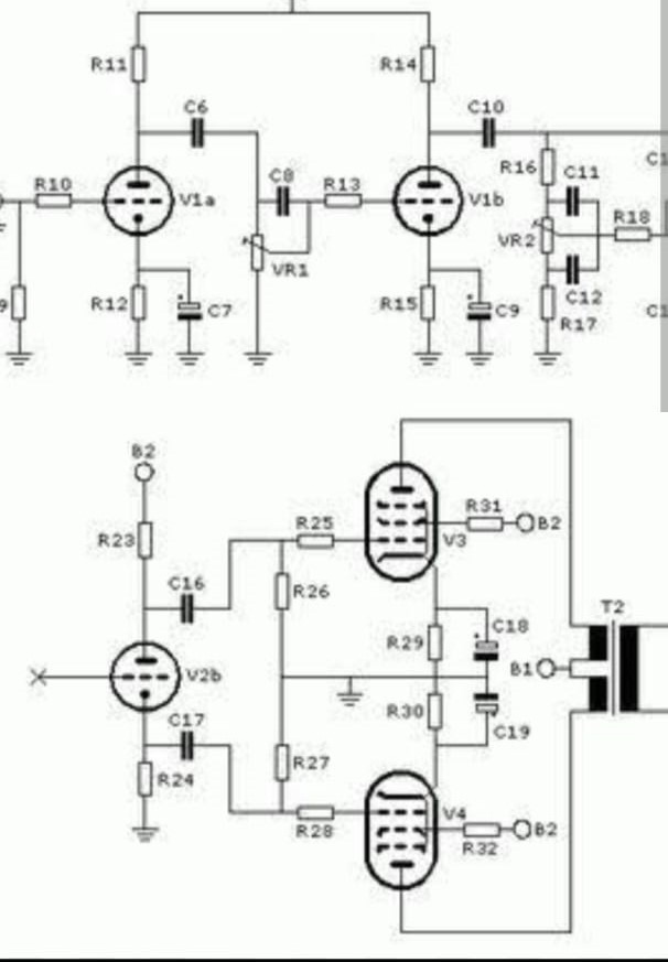

We (myself and my son) are now building a new amp, an ambitious one, with two speakers. The circuit is attached. The problem is that none of the electronics shops are able to wind a EI output transformer for our specifications, Viz , Center tapped primary rated at 0-200V-0 and 25W and secondary at 0-12V at 25W. We are thinking of using two 8Ohm speakers in parallel (4Ohm in total). In the absence of a output transformer, what alternatives can we use?.

Your "specification" for the OPT using voltages is completely incorrect. In fact I am not even sure where it could come from, perhaps you misunderstood information on repurposing toroidal power trannsformers as tube output transformers? Those winders could still be very capable of winding OPT's if you give them proper specifications.

Transformer spec is meaningless and the schematic is wrong.

The proposed schematic has multiple errors, so maybe the best plan for the immediate future is to choose an existing proven design, and work from there. Zillions of EL84 amplifiers have been made, and nobody complains about their results, so you have really good odds of being happy with your project when finished. Several other recent threads on this board have thrashed over different schematics' choices, but you won't go too far wrong with anything with push-pull EL84s. They're easy to get right, and not expensive, in the larger scheme of things. Maybe stick with something that isn't critically dependent on long loop feedback, which is fine, but not especially new-user-friendly. Maybe even begin with something with the output valves connected as triodes - this reduces performance demands on the OPT and might even allow removing any loop feedback, which makes success easier. At a loss of 3dB peak output, but might be a good trade-off for a next project.

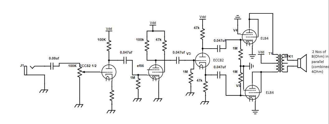

Coming to the schematic, i can't spot whats really wrong. I have referred many push pull schematics before and this is the simplest i have spotted. An example is provided below. Am i going wrong in the amplifier section or the push pull section? Please correct my errors.

Your first schematic had way too many errors, "correcting" means erasing it and starting from zero.Thanks for your replies.

The second schematic is incomplete.
Search for EL84 schematics pulled from books , not random Internet sites, or this very Forum.

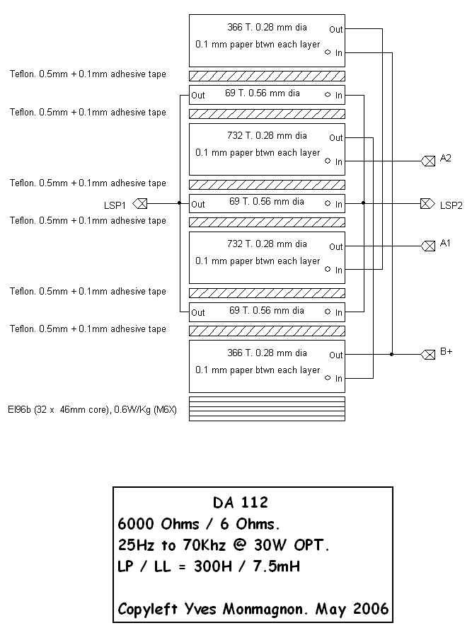

The transformer winding design shown above can be made by any competent winder.
As-shown it's nominally 6000 ohm to 6 ohm speaker, so 8000 ohm to 8.
For a 4 ohm secondary, change secondary turns to 49
Notice it's split into 3 secondaries which are then connected in parallel.
Please do not mention "Volts" any more when talking OTs, the proper parameter is "ohms".
