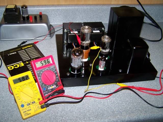

Pulled the tubes and inspected them,nothing visible floating around in 3 of them,one had a tiny fleck,of what appears to be mica,it's fairly translucent. So there don't appear to be any grid/cathode 'floaties' in the tubes.
I tried to peer inside the plate structure,with a nice backlight,but couldn't see much.What I did see,appears to be intact,and in good shape.
So perhaps that is a bit of evidence against the arcing theory.
I might connect the 'scope to the grids (with the output tubes pulled) and sit and watch it for a while...see if it drifts/bounces/anything.

Not entirely correct. B+ on both is 800V. KT88 screen is 600V, EL 34 is 500V. Something is obviously wrong above this - first off by the poster saying ... the 6L6 schematic calls for -72V and I have EL34s at -76 so it should be underbiased. 6L6 <> EL34. This is the number one newbie error - they see a schematic with a cathode R of 680ohms and assume at ANY B+ that 680 is the right number... This shows that in general the poster doesnt understand bias and how tubes are different.. as such, there could be many unmentioned problems... 50ma per tube wouldn't pop 10ohm Rs... so......... .something else is up.
680 ohms?
There is no (large) cathode R here,like in a self/cathode bias setup -except the 10ohm R's,mainly to measure/adjust the cathode current,since this is fixed bias.
I cranked the bias adjustment pots for the most negative voltage at the grids,which is ~ -80V,If I recall.
I then slowly brought them up to ~25ma (250mV) per tube,measured across the 10ohm cathode R's,just for initial testing. This resulted in approx -76V on G1.
I don't have any 6L6GC tubes on hand (except for some 'questionable' 6L6GB's,and like George said,I'm not about to put those in this amp.)so I used these EH EL34's I have for my ST-70.
I admit I didn't look up the specs on the EL34 before putting them in,I had assumed that they would be OK,since I remembered the Va rating to be in the 8-900V range. If I had seen the lower screen rating,I would have thought twice. -My bad.
However,I wonder how Fred ever managed to run trouble-free with 6L6GC's at these voltages?
Exactly,thus my post.I'm kinda stumped,all the voltages check out,and are nice and stable,(including Vg1) with the output tubes pulled.
I just got done 'scoping various stuff..no anomalies yet,that I can find. -there are some funky transients on Vg1 at turn-on,but that's why the standby switch is there I suppose,to give time for the voltages to "settle" and the heaters to warm up.
One other person (oldtubes ?) mentioned that B+ regulation isn't needed for PP operation,since any hum tends to cancel.
That's true,but not my reason for considering it..600V B+ is just too darn high,it seems. If I could drop it about 100V or so (+500V B+) with a regulator ,then the tubes would be a bit happier. Plus everything else in the amp is already regulated (it needs to be since it's direct-coupled.),so why not!

Okay, so the first issue is the high B+ voltage. I'm thinking about adding some resistance in there,to help lower it a bit (maybe increase that 10ohm resistor.)
Also,I think a regulator might be a good idea,to help drop some voltage.
I'm also considering going to Pentode,or perhaps Triode connection,if I can find a suitable set of tubes to use,and drop/regulate the B+ (and Sg2) voltage to a suitable amount.
Does anyone have any suggestions for B+ regulator circuits?

I remember well this "pop" noise from the speaker together with a "yellow shine" in the valve from my own experiments when I did exceed rated screen voltage limits too much. This is arcing from grid2 to grid1 and from my experience the valve is lost, it will arc again the next power up.
The small 10 Ohm cathode resistor is mainly to protect the output-transformer, not the valve.
Before you consider any changes to the original circuit ( I like it ) make sure to get a new quad of suitable output valves on hand.
I have been using 6CA7, EL34, 6L6GC, 6550A, 7027A, 8417 up to 500V B+ in UL-mode with no problems so far, but would never torture them with 600Volt B+.
KT88´s will suck too much heater current, what remaines to try is a KT77.
You will need a new valve set for your ST-70 anyway.

So,I got some chinese 6L6GC tubes from Mikkel (mcs),and plugged them in the amp.
I am unsure of the make? Perhaps Mikkel will chime in.
B+= ~650V loaded. (unloaded it's ~740V!)
Bias current is about 45-55ma per tube.(Just the rough initial adjustment to get them 'close enough'.)
At 50ma (32.5W) they just start to show a slight bit of color along the fins. At 55ma they are blushing a fair amount.
I have also removed half of the filtering capacitors in the B+ supply.
So,now we're down to 23.5uf->5H->110uf,in an attempt to lower the B+ voltage a bit. I'm not sure it's helped.
I need to find a smaller film cap to try as the first C position.
