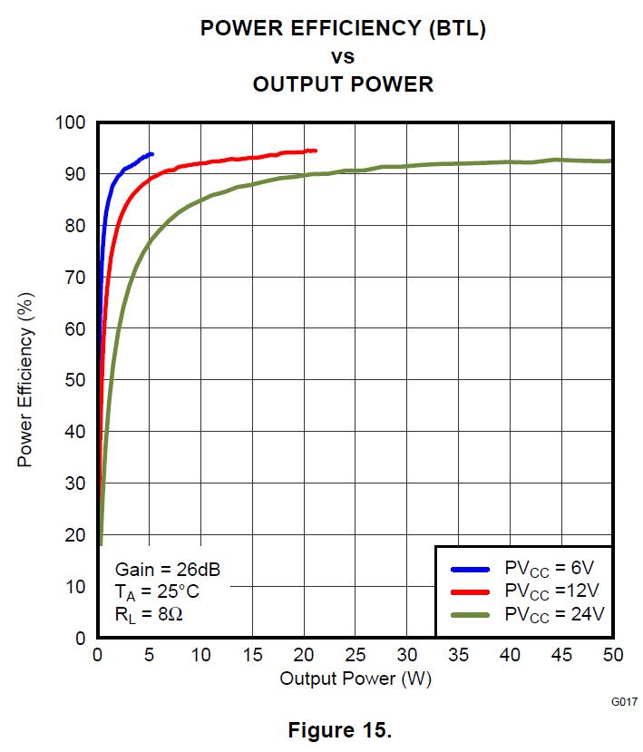

Hi Dug,
I am operating at about 90W.
Hence, I am wondering whether I have been doing things right.
Thanks.
Thanks.
