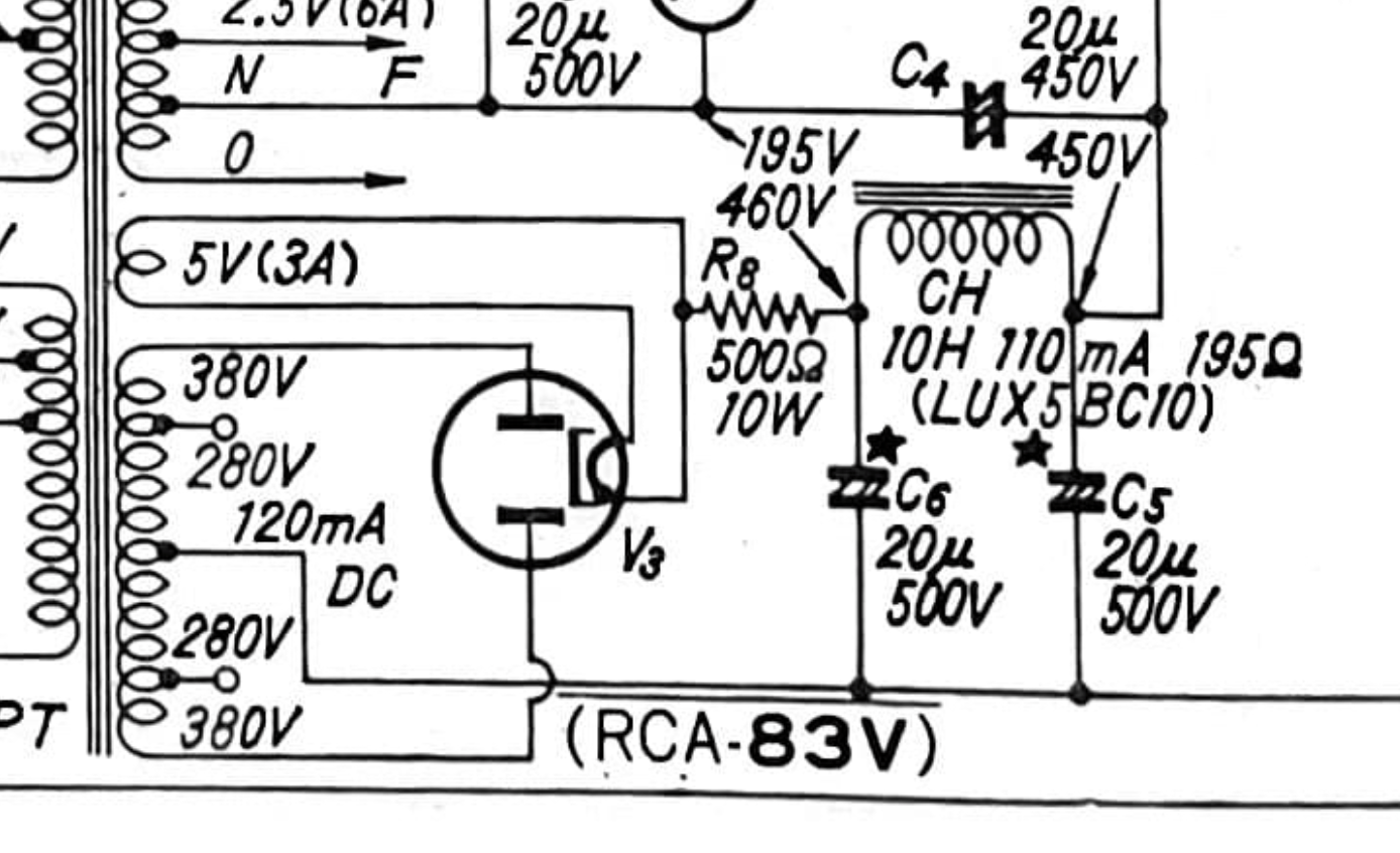

Can't the voltage after the rectifier be dropped with a resistor before the first cap and choke? Like in this old Asano 2A3... I'd be using a 5AR4 instead of the 83V and feeding it 420V instead of the 380V... Or is this just too much?

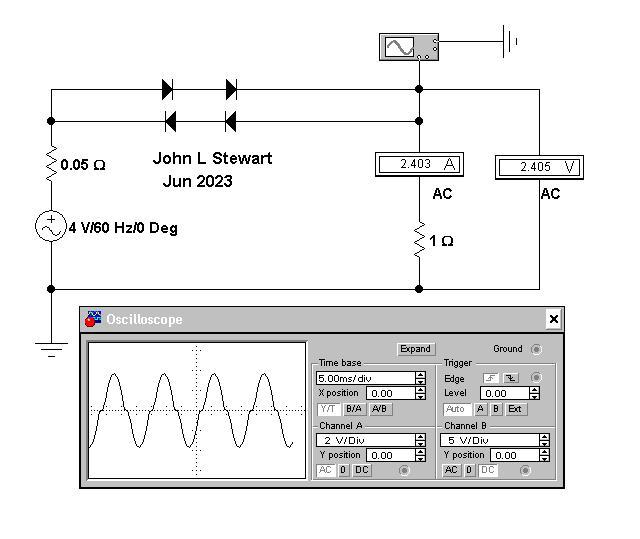

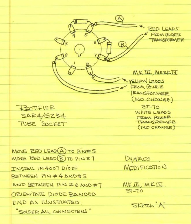

Another way to reduce an AC voltage, for your scrap book.👍
The 0,05R is the transformer winding resistance. The One R load is equivalent to a 2A3 filament, 2,5A at 2.5V.
The meters are measuring RMS. The diodes simply shorten the conduction period for both positive & negative of the AC waveform.
But lots of harmonics of the line frequency, not suitable for some loads.
I put another scheme on DIY a while ago, I'll pull it up later, 😀

Hint: Use a Schottky bridge, it has less voltage drop than conventional silicon diodes, and that allows a higher resistance voltage dropping resistor, which in turn gives more filter action with the second 22,000uF cap that follows the dropping resistor.
B+
Want to reduce B+ voltage?
Move the input cap, 20uF to right After the choke.
Then, put a small cap before the choke (1uF, 2, 3, 4uf? as needed).
Take out that 500 Ohm resistor after the rectifier.
Then put in a 100 Ohm series resistor after the choke, and a 50uF cap after the 100 Ohm added resistor. That will get the ripple voltage back down to as good as, or better than it was in the original circuit.
And . . . your power transformer will run Cooler!
So many ways to skin the proverbial cat.

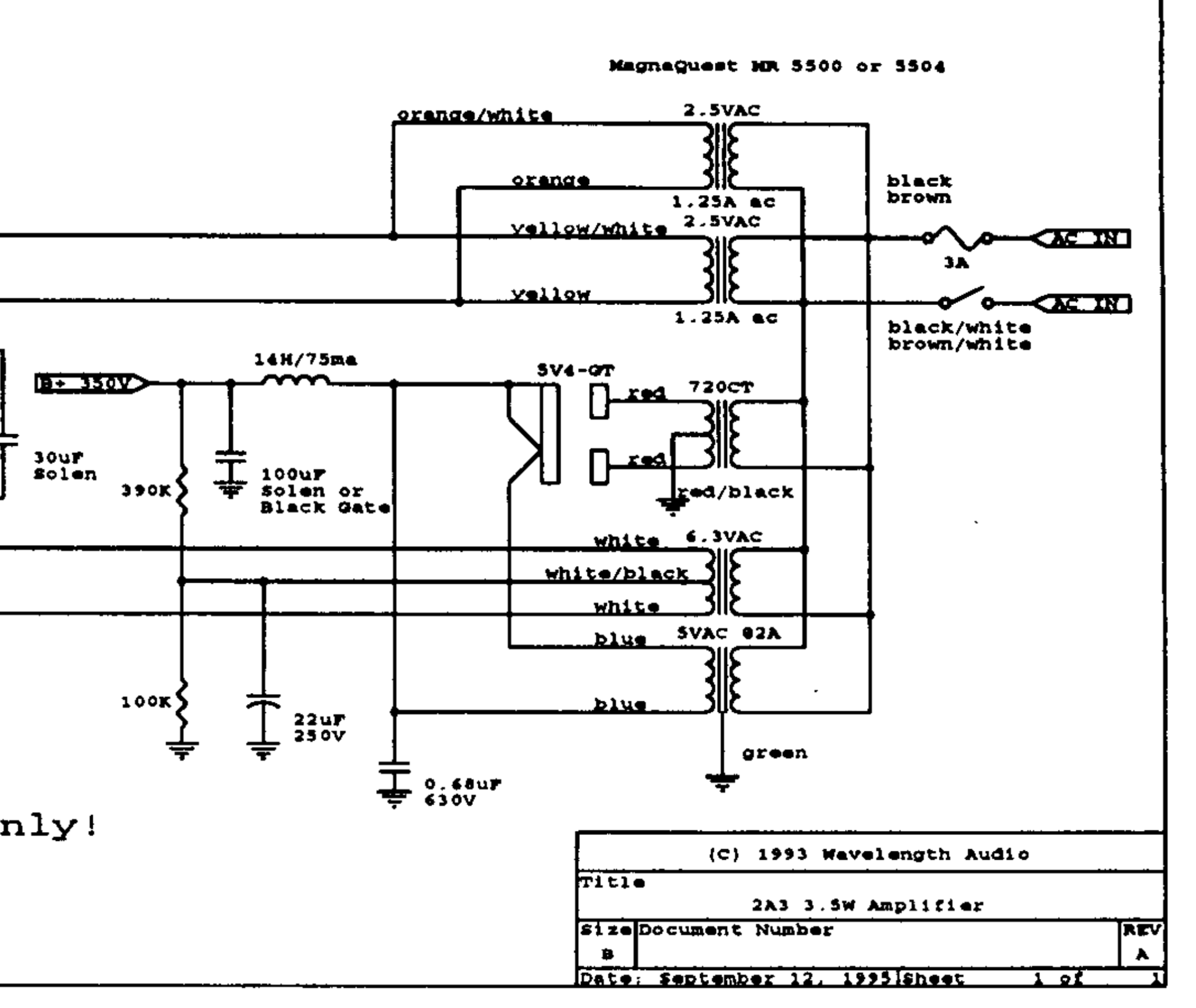

I am keener and keener on the idea of the Baby Ongaku (see attached PS schematic) as opposed to the original Asano Loftin White... The Baby Ongaku has a choke input which as you mentioned might be a nice match for the PT-240 though it outputs 420V when this design is asking for 360V on each leg.

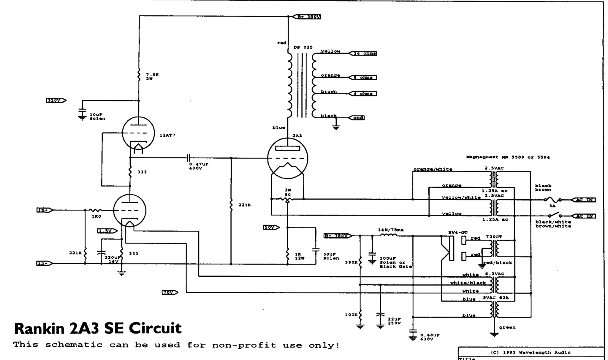

Is there anything else I'm missing regarding implementing this transformer in the Rankin Baby Ongaku? Hope to order this weekend... I guess its about 30-60 days to wind it for 120V.
Pls tell this Geezer of age 90 what is unique about this circuit that the designer feels must be protected.😀
There has been little new in toobz for about 70 yrs. All the valuable patents have expired in most countries.
Except maybe in the US, where anyone can sue for any reason, If Lee Iaccoca of Ford & Chrysler were alive we could ask him.👍
The circuit should perform OK. But will not be outstanding,
