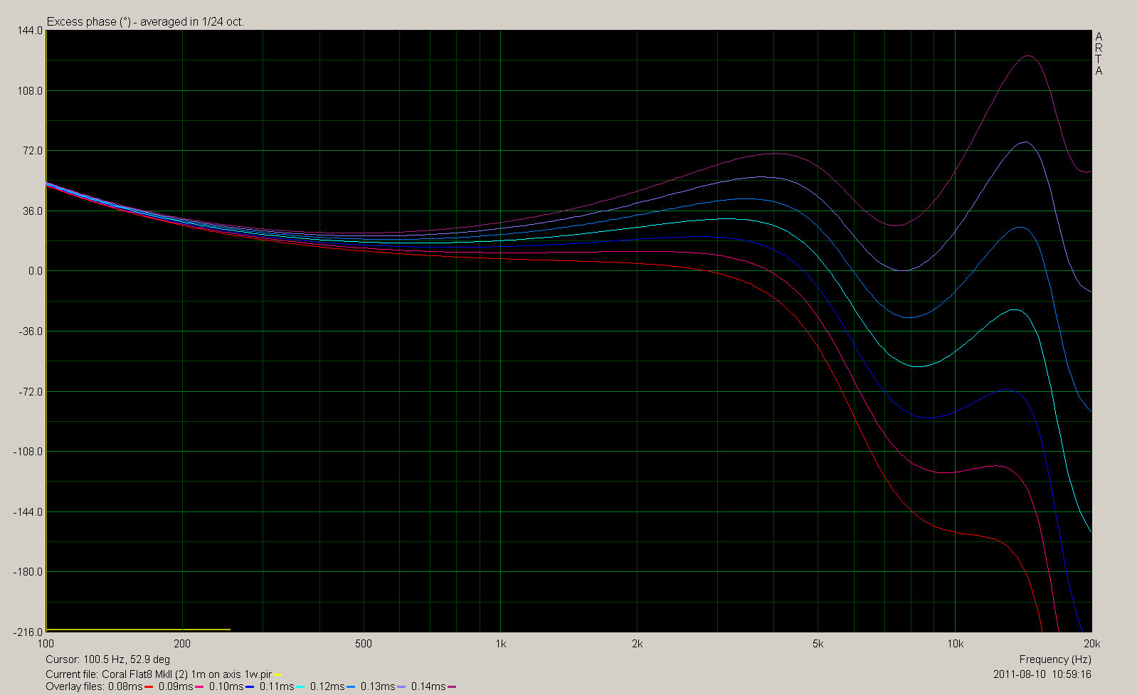

Image 1 is excess phase of two 8" dual cone full range drivers. Red is a Fostex FE207E, yellow is a Coral Flat 8 II, both measured 1 metre on axis. Both have the same 3.9ms window time and same delay time estimation for absolute phase.
The total delay estimation relative to microphone distance agrees very closely (within 10mm) with my previously estimated acoustic centres of the drivers, and the calculated (hilbert) minimum phase response tracks parallel with actual phase up to ~2Khz before diverging, so I think I have the absolute time delay fairly close in this measurement.
I find the difference in excess phase between the two drivers quite interesting. Both have a 160mm main cone, but the Coral has a 80mm curvilinear whizzer with a 30mm aluminium dust cap directly attached to the VC former, while the Fostex has a 60mm conical whizzer with a 35mm paper dust cap attached to the whizzer paper.
Prior measurements of a very similar Coral missing its dust cap and later missing its whizzer cone show that the main cone rolls off quite steeply at about 6Khz, the whizzer cone rolls off gradually at around 12Khz, and the dust cap rolls off at about 16Khz, all of which seems to fit in nicely with the observed excess phase. There should be a mechanical crossover between the two cones at ~6Khz, but there may also be a second mechanical crossover between the whizzer and radiating dust cap somewhere around 14Khz as well, as the kink in excess phase suggests.
On the Fostex it would appear that the crossover between the two cones is quite a bit higher in frequency ~8Khz, and the fact that there is no significant kink between 10-20Khz (and the fact that the Fostex has much inferior response in this region) suggests that the dust cap is not independently radiating and just forms a part of the whizzer cone...
Image 2 is 0.01ms increments in the phase delay estimation for the Coral driver, there is no distance where it can be reduced to minimum phase, the closest you could get by just adjusting the delay would still leave a +/-30 degree variation.
I suppose you could argue that a dual cone driver is really a coaxial 2 way design which just happens to share a voice coil, which is true, but at the end of the day its still just a single driver with a voice coil and some type of cone structure attached to it, so I imagine that non minimum phase would be possible for some more exotic designs as well, and in fact that any time a driver is large in wavelengths and non piston in operation there is at least the potential for a non minimum phase response to occur at high frequencies, even if it doesn't generally work out that way.
All of this just serves to further illustrate what a nebulous concept acoustic centre is mind you... it's a virtual source not a real one, and it's only valid or useful within certain limited constraints.
