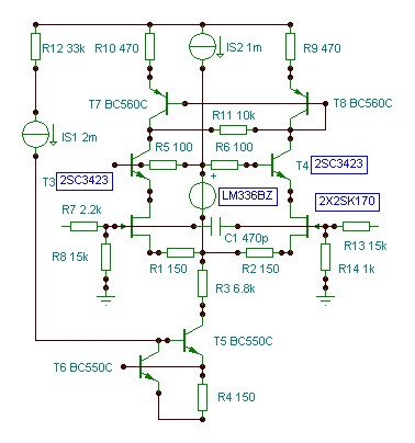

Hannes,
are you contemplating?

Hannes,
listen, the parts have to be selected very carefully. I have only looked at the voltage amplifier section (114pdf), we should forget about the original design, those many capacitors make me feel sick. The question is what can be implemented practically. The suggested input stage would fit easily, except the current mirrors.
OK, keep U403 (until you are able to buy some much better Toshiba JFETs), but use 2SC3423/2SA1360 instead of 2N6718/2N5416.
The VAS stage is somewhat peculiar, I do not know the idea behind it, but I am extremely suspicious about that kind of trickery - could be converted to decent cascode.
I would make an experiment with bypassing the VAS.
Have you measured the rail voltages?

Hannes,
I feel the U403 is perfectly used here
Listen further, please. 2SK170 was developed for audio having exceptional sonic quality, linearity, amplifying ability and noise figure, features very hard to combine (as high Gm brings about high capacitances). A well-matched complementary pair is provided too, which is even harder to do. Only Toshiba has managed to accomplish all that. These devices have no equivalents.
It is not about the differential VAS. The single VAS performs poorly, looks poor, it`s the poor man´s VAS. The hole amplifier should be balanced. But this theory of special frequency compensation to achieve high slew rate does not make sense. It`s rather a special mess. Just think!
Would question the concept
Why? Gain should not be a problem with high load impedances, you could even apply GNF.

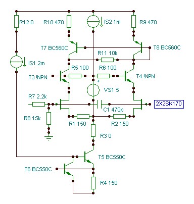

Lumba, I can't argue that the 2SK170 isn't a nice part 😀
However, I really don't want to introduce global negative feedback in an amp that features a feedback-less output stage. And I'm sure that we agree 100% here!
By the way I have some U402 lying around here - once more thank you very much Marcel! - it would be a nice opportunity to bring them to good use.
Have fun, Hannes
Hi Andrew,
we are discussing possible solutions, the values are probably not final, R8/R13 set the input impedances, R11 the gain. R7/R14 are not important for balance but may be equal. LM336BZ-5V would be fine here. T3/T4 dissipate around 50mW, smaller types can be chosen.
