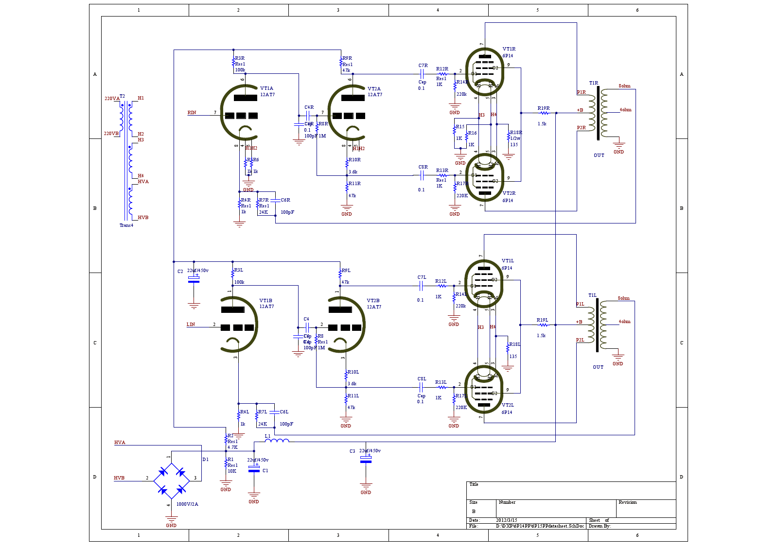

Hi All,
I have been lurking here for a while and learnt plenty reading the topics here.
I have a couple of EL84 push-pull amps that I bought off fleabay a while ago, they are supposed to be "Suppo" but their internal layout and schematic seems a lot different to ones I've seen posted here.
I've managed to work out why they've chosen most of the values on the board, but I can't work out why they have 10K screen resistors, so when it's running normally with 300V B+, the screens are only seeing ~250V.
Would there be a technical reason for this? Does this suppress the valve/tube from providing its full output? Finally, would there benefits in raising the G2 voltage closer to what the EL84 spec sheet says for class AB PP operation? (which is 300V B+ & 300V G2). Should mention that it's currently running the std Chinese 6P15s.
cheers!

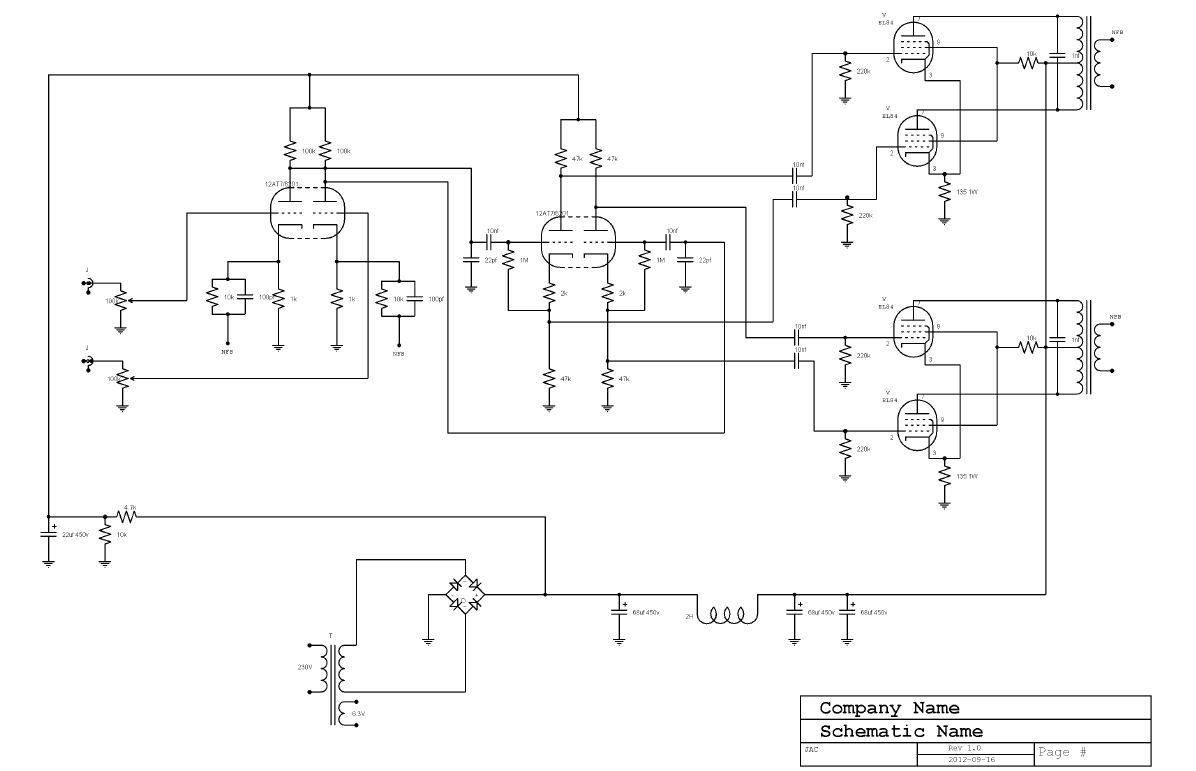

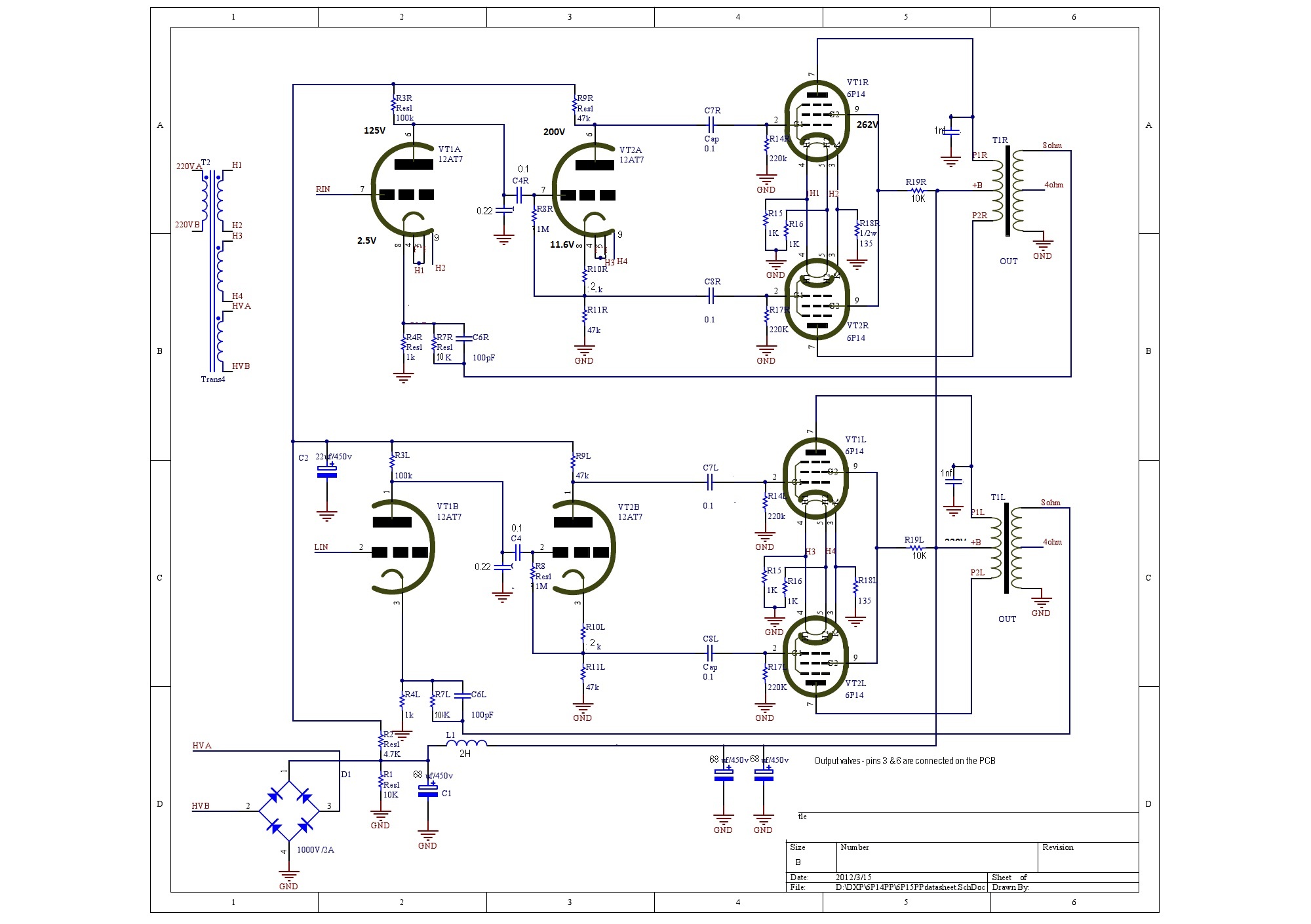

Yes a shared resistor for both output valves. A bit remiss of me to not include a schematic, but as I the OP was when I was at work, it was a bit tricky 😉
The first image is the schematic as provided by the seller. When I popped the lid off I noticed there was some significant differences so the second image is the original schematic modified. That got a bit messy I thought so I sketched out my own schematic, which are the last files.
Are there any gotchas or pitfalls I should look out for if I increase the G2 voltage by lowering the resistor value?
Cheers, Jacob

The only thing I am a bit dubious about is the 1nf cap on the OT. It looks like a bit of a sticking plaster to solve instability issues, but its only on one side so its introducing high frequency imbalalance which equates to higher distortion. In the original it looks like it should be across the whole primary of the OT. It looks like a poorly implemented zobel without the series resistance.
I would take it completely out to see what effect it has.
Yes you could restore the original 1K5 screen resistor, which should increase power output a little.

Hey Shoog,
argh, my bad I just noticed on review I posted an older image where I had the 1nf in the wrong place 😱 It is actually across the primary of the OT.
I've done quite a few mods to one of the amps I have and the other is stock as a comparison. They sound pretty good for how cheap they were!
Ok thanks I might try the 1k5 and see how it goes.

Strangely I note on the 6P15-EV datasheet (I have a set of these) that although the general "electrical characteristics" show 150V for G2, the absolute max rating is 330V. The Chinese 6P15s look a lot like the Russian ones but I have no idea about the spacing & thickness of the G2.
It does appear that they've chosen 10K resistors to be "safe" as on the PCB of the amp in one corner it has a list (printed in copper!) of suitable output valves (marked with a tick) and there's quite a few, so limiting G2 to around 250V means if people tube roll it wont smoke their new valves 🙂
I've bypassed the shared cathode resistors for the output valves, so it looks like it might be worthwhile trying lower screen resistors if the combination of unbypassed cathode & screen resistors might create a distortion modifying effect.
Just as a general question, does anyone see any glaring errors/issues with the design? I know it's not cutting edge but it seems to perform quite well, although I haven't used the scope to do any real measurements yet....
