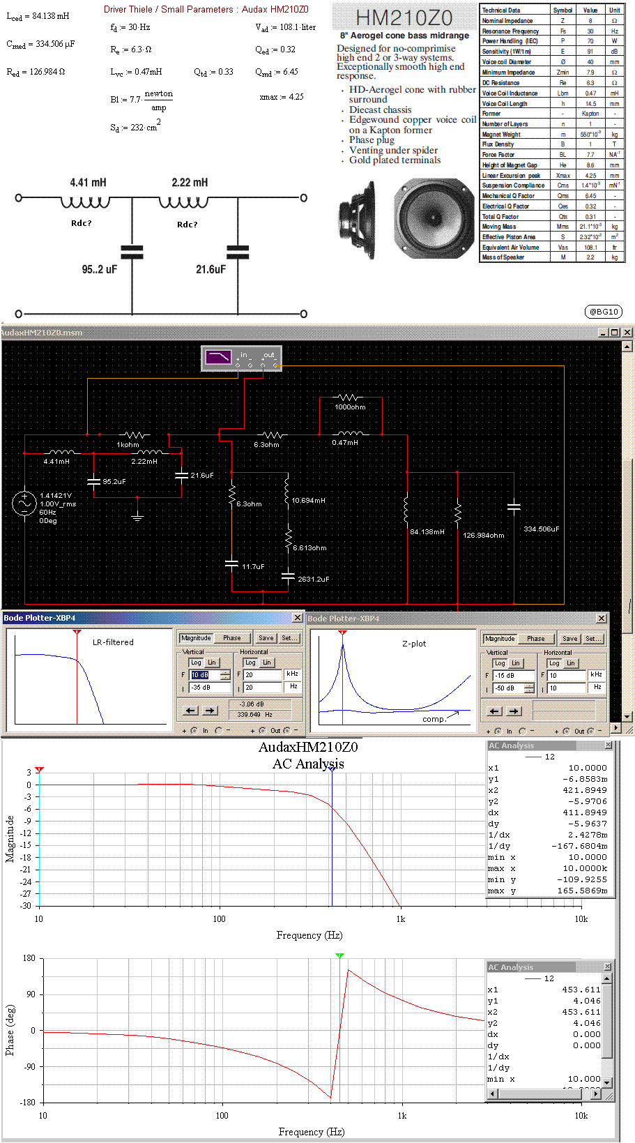

Hi Alex,
Have a look at my picture where you will find other component values for the resonance compensation:
Note that the filter you proposed doesn't include any DCR values in series with the coil inductors but is a must when simulating real filters.

I think you'll be OK with a cheaper high DCR inductor as there'll be a series resistor in your resonance peak filter anyway. Just subtract DCR from the needed resistance, and make sure the structure can dissipate the power that will present across this resistance.
This is where a circuit simulator of some description could come in handy, or just use your hands and feel.
You can use an electrolytic capacitor as this filter doesn't work at high frequencies, and components here won't affect the sound too much.
BTW, you may be able to get the same result without the impedance compensation using different values in your filter, but you should manage good results this way too.

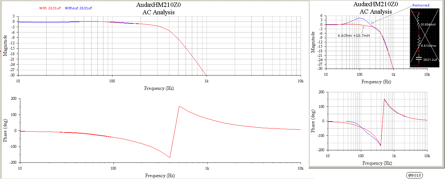

The impedance peak filter is in parallel with the driver. The amp will probably apply enough damping that it has no additional effect. Remember that despite what it looks like, the fact that the impedance peak causes the filter to produce a sound level peak is just a coincidence that it resembles the driver resonance. Any interaction between the low pass filter and the impedance is unintentional and arbitrary.
The peak is an interaction between the high capacitive reactance above woofer resonance and the crossover. This is a real effect that give the most trouble when the woofer motional impedance (resonance bump) is tall and the crossover point is relativley close.
I'd second what AllenB said about itterating the values for your best result and also using high DCR inductors if you go for conjugate correction. Even with optimization you may still be fighting the effect.
Don't forget that you can try an acoustic resistance blanket over the back of the woofer to knock down the impedance peak. That would make life easier.
This isn't a resonance per se, but an interaction. If you find values or a different topology that gives flat response in the region, then you are done. No extra feedback or other fixes required.

You are right, the capacitor reactance can be neglected but the filter proximity to the natural resonance is still affected by the leftover series L + R -branch as seen in the picture:
b 🙂
