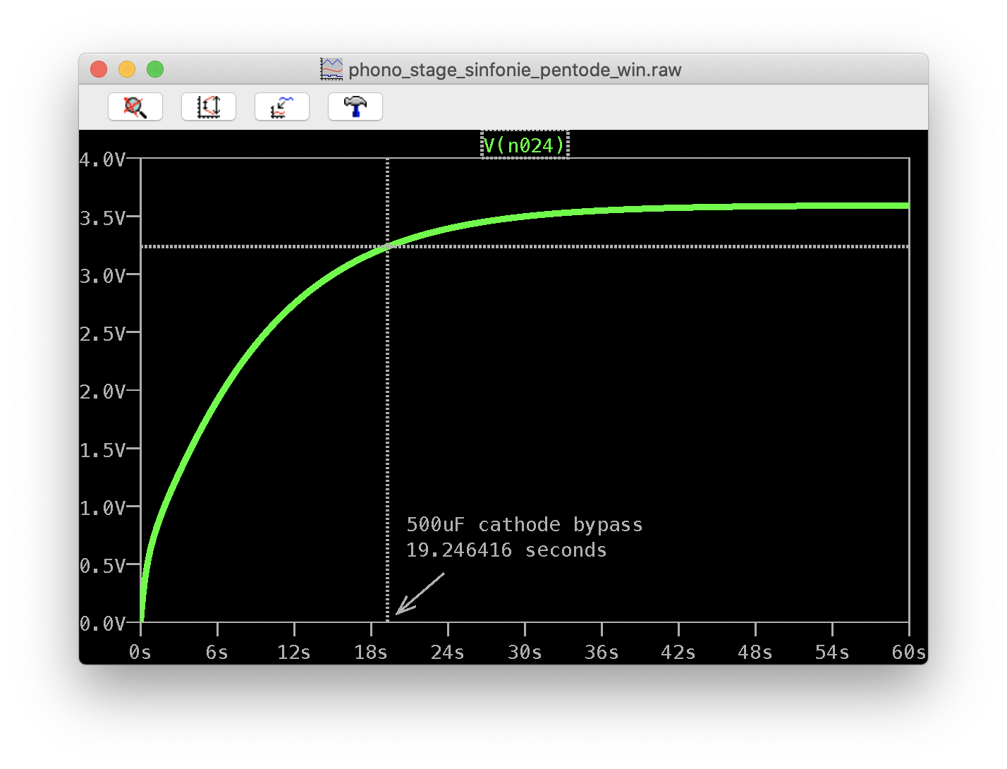

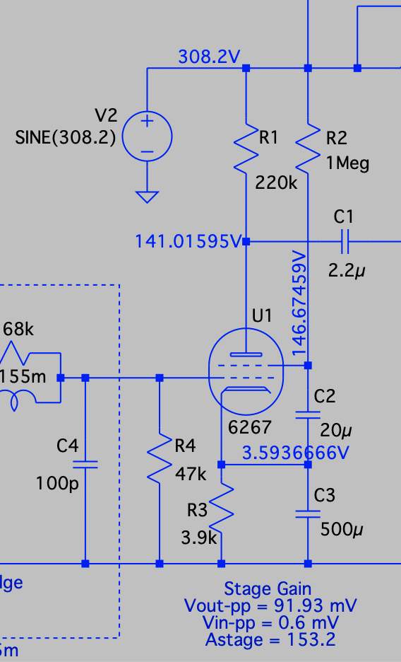

I changed the bypass in my model to see how the charging looked. I tried out a 1000uF too.
With a 100uF cap, it took about 17.6 seconds to get to 90%.
With a 500uF cap, it took about 19.2 seconds to get to 90%.
With a 1000uF cap, it took about 21.5 seconds to get to 90%.
Interesting that there is so little difference in time despite the huge difference in cap sizes.
