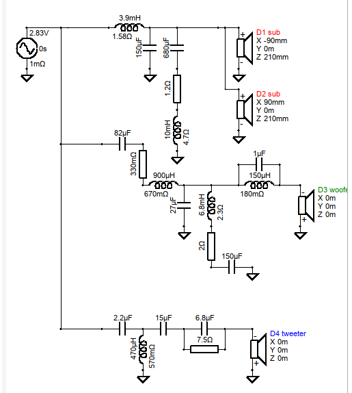

This is what I will build up now. Components I found in my stock marked in green, the missing just ordered...
