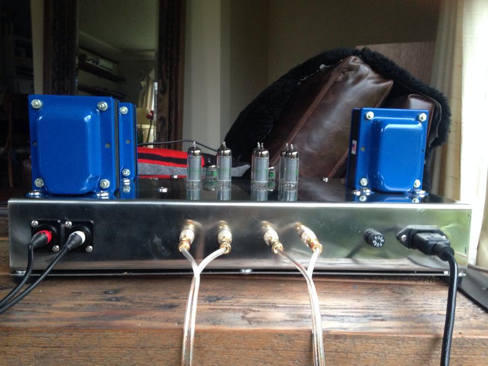

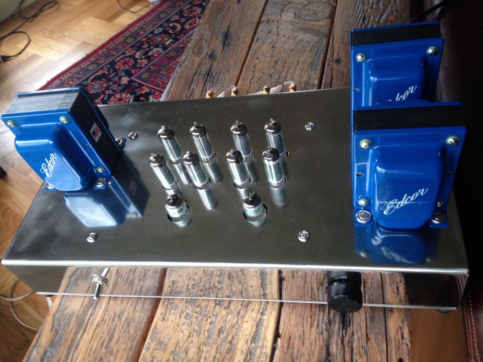

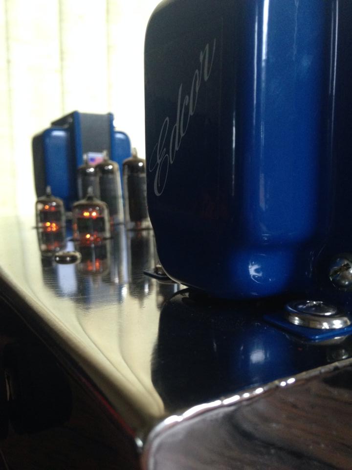

Hey All,
The XPWR227 works like a charm. Notably more power in the low end, much more than I expected. With the O'scope on the output, I manually fiddled with the location of the PT, and wasn't able to create much noise difference even if I shoved the PT right up next to the tubes. Chalk it up to the end bells? Maybe the valves working in push-pull are less susceptible to gauss fields than a single bulb in SET taking all the gauss field? I don't know, and I don't have a similar SET on the shelf to compare it against. After the fact it seems that transformer location just wasn't as important on this kit than I expected. In the end I just shoved the PT against the left side with room to work, and on the centerline between the two OTs. So it looks good. When my own camera is not on the fritz I'll try and get a good pic of the wiring.
I used screw-down jumpers at the transformer junctions so I could swap things around during the build, and if I ever have to replace anything. That worked out like a *charm.* Super easy and quick to pop things in and out. The Pot is a mil-spec one I found with huge lugs that were easy to solder and a nicer feel than any I've encountered so far. An IEC filter input so the rig would have a ground and some noise dampening; it does a remarkable job quieting noise on dirty metropolis AC. The noise level in the city was just the same as the noise I get at my house, (which is off grid, battery bank, finely stepped inverter, VERY clean AC.) So that will be integral to every build I ever do *ever* again. Interestingly, the left channel has almost exactly twice the noise as the right channel in *both* builds (my personal one having a much different chassis layout and stock transformers) so maybe it's induction on the PCB? It's not terrible; with the volume Pot pegged and no input signal I have to strain to hear some hum in the left channel, and there is none in the right.
I didn't wire the output transformers for ultralinear, nor did I swap out audio caps. But I may go back and do that on my personal rig this winter.
What else.... Amphenol RCA jacks, pretty cheap for the quality, easy to solder up, and built to take a nuclear blast. I think I used Dayton banana jacks, also pretty cheap and nice to both install and solder. I could have used low-profile ones with the chassis space I had, and in retrospect I would have preferred something that didn't stick out as far. (3/4"? Not really bad.) The plastic bushings to keep the signal away from the chassis are sturdy enough that they won't deform or break, but they require a very close drill bit size. Jumped the fuse on the board, and wired a panel fuse directly off the IEC before the switch. The chassis is Stainless scrap from around the yard, I had the box fabbed at a local place and did all the drill work myself, then polished it to a high shine, but kept the deep dings and scratches to give it some class.
This is my second build with the S-5 L16s, and I am pretty impressed with them, though I expect I'll be doing point-to-point from here on out. Again, this was a gift for a lady, and she is pretty happy with it. Paired with a set of KLF 20's, there is certainly more volume than she will ever use, short of DJ'ing a block party. Probably more speaker than amplifier, but maybe someday I can go back and swap it out with a pair of 300b SET monoblocks.....
Thought you all would enjoy the photos; they are my meager thanks for your help and contributing to the thread, I learn so much here, and it keeps me excited for the next project. And the next one. (And the next one.) Love this place!
Cheers!
-Aaron
