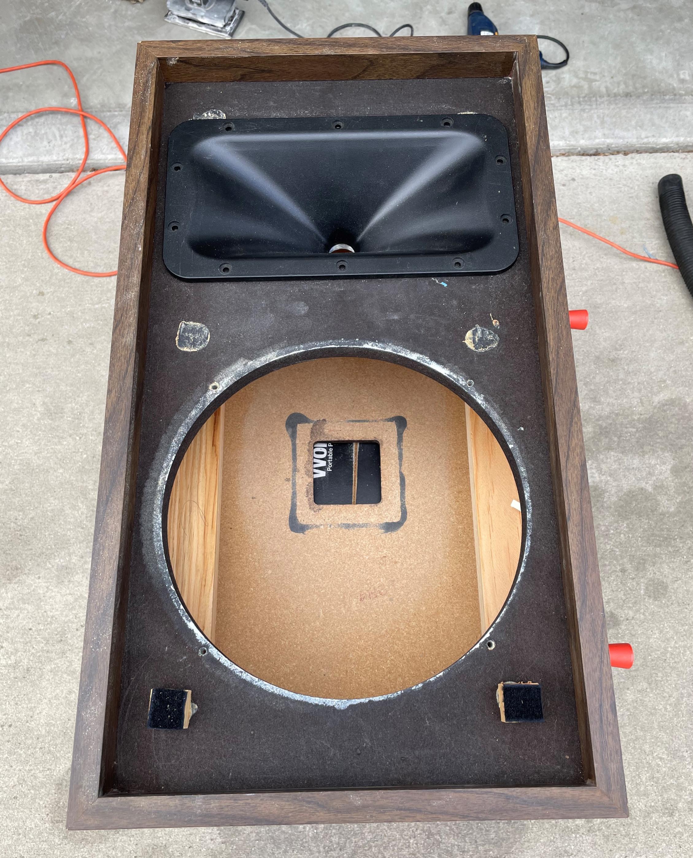

My story of an Econowave conversion of Utility Large Advents

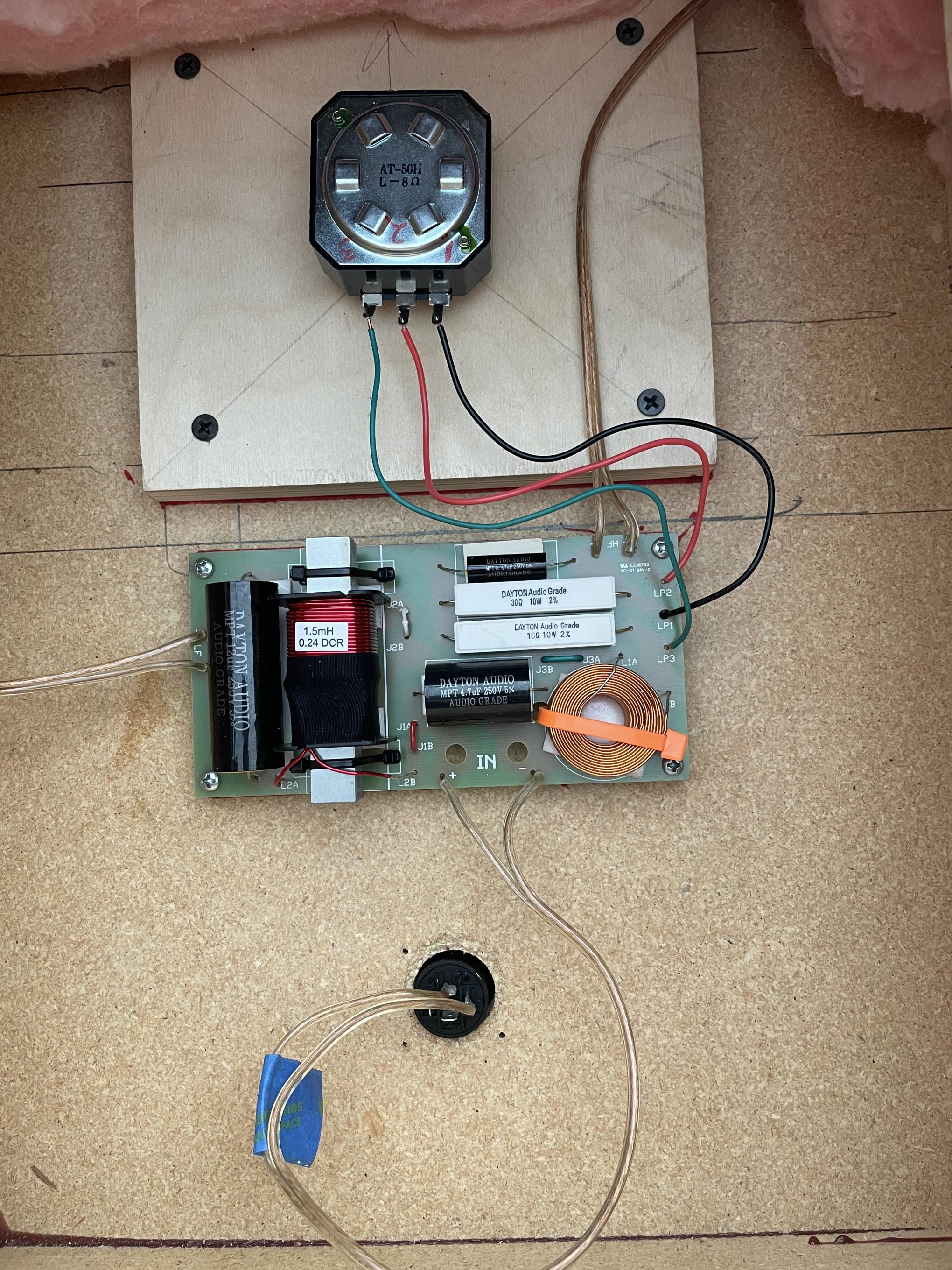

How: To understand the specifics of converting the common Large Advent speakers, read Ross Hershberger’s detailed build thread from 2008. PCBs to build the crossover are still available; check out the last page of this thread. A pair delivered cost me $32 and comes with detailed instructions and a Parts Express parts list – very efficient! Skills and tools needed are modest: soldering iron, jig saw, drill. If you want to flush-mount a Neutrik SpeakOn NL4 instead of binding posts, you’ll need a 2” forstner bit and 1” paddle bit - see photos. I used a pair of Pyle type PH612 horns with Selenium type D210Ti because I had a pair on the shelf.

Recently I built a pair of Wayne Parham’s Four Pi speakers with recycled cabinets. I used Wayne’s crossovers, JBL 2226H woofers and the B&C DE250 drivers on Wayne’s H290C waveguides. I didn’t expect the small (relative to the 2” exit compression drivers I’d been using) driver and waveguide to impress, but the Four Pi so successfully integrates the compression driver with the legendary JBL 2226 that I could be satisfied with that combo in any setting. They contend well with the Tannoy dual concentric drivers I’ve been using in bookshelf systems.

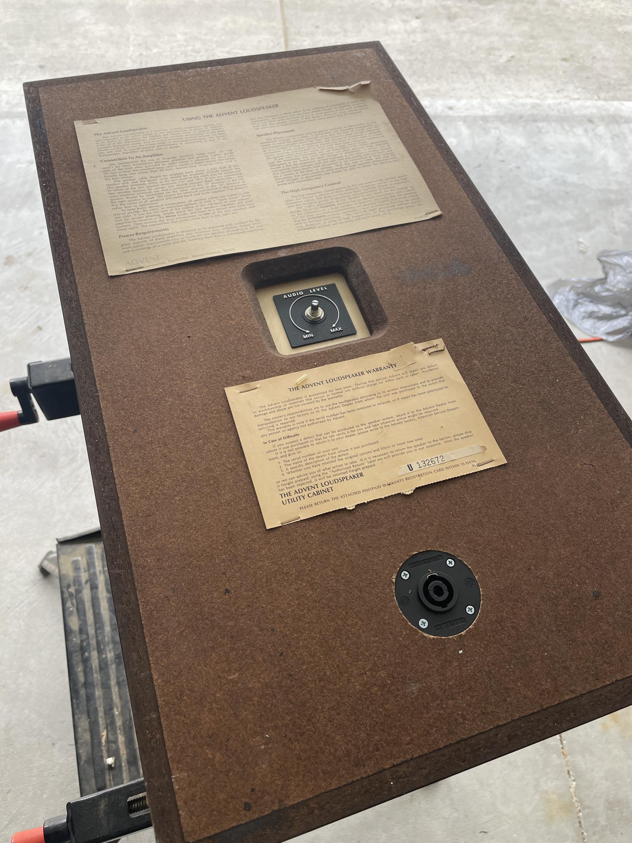

Trying the Econowave version of Large Advents was the next logical step in scaling down the two-ways I’d grown to love. These were sold in massive numbers for years and turn up regularly. I got a pair in excellent condition for $50 at an estate sale two blocks from my house, but of course the woofer foam had long crumbled. I had read that the Masonite woofers are tricky to refoam correctly, and also knew that using the wrong foam would raise the Fs from the spec’ed 17hz to something that would no longer perform so well in the sealed cabinet, so I took mine to a very experienced local guy. I followed Ross Hershberger’s build closely but chose to use a single NL4 connector near the bottom of the rear panel. I like to keep the back flat for easy transport and to avoid anything easily bent or broken.
Results: when I finished these I put them on top of the Four Pi speakers in my workshop, played them for a couple of hours and went through the gamut from Ella Fitzgerald and Coleman Hawkins to Bombino. Even elevated as they were the bass was palpable and solid. Imaging was immediately 3D on a Mapleshade recording. Switching from the Four Pi to these indicates that a better pair of compression drivers would yield audible benefits, and I may play around with that.

What crossover design did you end up using? I was able to find a myriad of filter designs, but none seemed specifically designed for the Large Advent woofer, nor did I find any with frequency response measurements with the Large Advent woofer. It seems that most of these are somewhat generic filters with the recommendation to tune to taste. I've got a pair of absolutely trashed NLA Utility speakers that I was considering restoring, but honestly, going in the Econowave direction sounds more interesting.
I bought a pair of the ZilchLab crossover boards from wiredbecker. See FS: Zilchlab Econowave Crossover PCBs
These were designed with the Large Advent woofer, as I understand it, but you can also change a couple of component values for more efficient woofers. I can't see why you would go any other route. The L-pad is pretty close to center for me using the Selenium DT210Ti with plenty of range to go with too much or too little HF. Most importantly the integration at crossover seems very very good. I was listening to Walter Davis, In Walked Thelonius, this morning, and a piano recording of that quality really shows up issues. Just SOUNDED GREAT.
