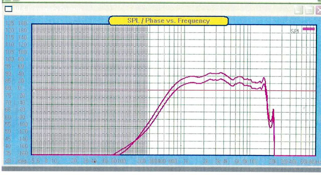

1) He also stated that it did not require HF compensation. His measurement is below. It needs at least 6 dB of HF comp.
2) Despite being too small to match directivity with a large woofer, the CTC spacing will still place the vertical nulls within the pattern of a smaller one.
1. An error. It happens (..obviously). 😀
2. What design are you talking about here?

ZilchLab said:
You're saying EconoWave will not mate well with a 15" woofer. Despite the fact that JBL does that in some products, I agree; it won't play low enough to match directivity, no matter what driver is used with it, I don't believe.
You also seem to be arguing that, being asymmetric with a "short" mouth height, it won't mate up with a 10" or 12" driver either, as it loses pattern control in the vertical at a higher frequency than in the horizontal. That's not fatal, either, and Wayne has documented the utility, indeed, advantages, of narrower directivity in the vertical, compensating for this by placing the vertical nulls to augment the pattern in this region.
Actually it *might* mate well with a 15", rather it just seems *highly* unlikely, and most notably JBL didn't manage it. (..it would probably be a rather unorthodox arrangement however.) The same of course is true with 12" and a 10".
This is what I'm saying:
I think that ctc spacing between acoustic centers for the drivers, (specifically at and near crossover freq.s), likely will be a problem IF the actual crossover removes the primary resonance for the horn.
In other words, to use this combo (compression driver + waveguide) to it's best effect requires suppressing the major point of resonance and diffraction from the horn which occurs at around 1.8 kHz. Basically it needs to have an *actual* crossover at around 2.5 kHz with a very steep filter, OR even higher in freq. with a filter that is less "steep". Of course combing may not be a problem at higher freq.s because of vertical directivity from both drivers/waveguide, but that won't be true near the crossover (at least for most drivers).
Here is Brandon's decay plot of the compression driver + waveguide:
http://493531664873718246-a-1802744..._0XULuBOCzbQMVFkKGbUQFiUgNQZM6kFghQzTq4W5Cw==
Finally you have to consider both the linear decay of the partnering (10,12, or 15" driver), and its off-axis response at various horizontal axis for a smooth summed response. Most 12" drivers for instance start into their primary break-up right above 2 kHz. (which isn't quite high enough in freq..) They also don't have quite enough loss in pressure off-axis (at lower freq.s) to sum well with the waveguide (and possibly a little to much loss in spl at higher freq.s). Worse, the steeper the filter the worse summation off-axis.
I'm not saying you couldn't find a driver that worked well, rather that I haven't seen one.
I agree with you on the H100. I had thought it's lower freq. extension was more than what it is. The recommendation I gave is worthless.

ScottG said:
Though perhaps my thinking is shot here as well. :cannotbe:
For starters, several of your links are returning "Insufficient Privileges," but I believe I get your gist.
I assume the CSD you linked is to BMS4540 on Pyle PH612. The impedance plot (not provided) would indicate where the primary resonance is; that driver is not recommended to be crossed below 1.9 kHz, as I recall. It seems as though you are arguing that the primary resonance should NOT be highpassed out, but then pointing to it in the CSD as indication of how bad it is? That combination looks clean above 2 kHz to me.
As example, here's an actual JBL product using the EconoWaveguide (with a JBL driver) crossed at 2.2 kHz:
http://www.jblpro.com/catalog/support/getfile.aspx?doctype=3&docid=668
Despite the obvious minimization of C/C distance with the 15" driver, the vertical nulls are very apparent in the crossover region. However, look also at the horizontal -- why is it sagging at 1 kHz? Not for the reasons you suggest, rather, because the woofer cannot support output to 90° beamwidth there; the directivity match is not optimum, much as is also seen with the Selenium 15" you link. 2.2 kHz is clearly too high a crossover frequency, and that small JBL 2412H compression driver cannot deliver the requisite SPL at a lower frequency, even though the waveguide itself would support it. Those were JBL's design tradeoffs for this product at its price point. The performance compromises of the more expensive variants in that product line may be seen differently.
The subject QSC is a rectangular waveguide, no? Why are you suggesting shaving its "diameter?"
In any case, despite its larger size than EconoWave, it is clearly losing pattern control below 2 kHz, more so in the vertical due to it being asymmetric, as well. In this instance, we do have the impedance measurement (but no CSD) evidencing a DE250 resonance peak at 1.6 kHz, which may become an issue crossing in that region or below once the requisite HF comp is applied, much as is apparent in the CSD using that driver on XT1086, which I have posted elsewhere in this forum.
