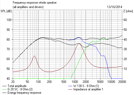

Those are a tiny 4-5L volume. So why is this sort of thing the "World's favourite speaker"? It's because 5" bass is actually quite easy to filter with a dome tweeter. The acoustic centres are near enough aligned. It comes out near 3kHz LR2.

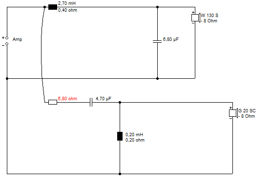

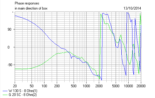

I ran a sim with a couple of similar drivers on a narrow 16cm baffle and 7 Litres closed box. You need some hefty baffle step and it's very inefficient. The bump at 1.3kHz is a cone edge resonance that most 5" drivers have. Also the small box really isn't right. Every 5" bass I looked at had a Vas around 15 litres. Which to me says lumpy bass on anything smaller than that.
These sort of speakers are fine in a small kitchen, but stuff like the PMC Twenty.21 at around 12 litres transmission line is nearer the mark IMO. For the technically minded, the PMC uses SEAS 5" paper drivers and SEAS 27mm metal domes crossed over at a lowish 1.8kHz. Little bit of familiar time-alignment there too in the sloped baffle. It's a continuum with a bigger box!

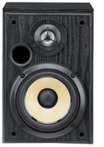

Look at something like the Sony SSMB-100H. I have a pair of these I bought for $40. I spent $3 on polyester caps to replace the electrolytics and added some free foam. They sound a fair amount better, but not "great". I could never make a speaker of any quality for less than I paid for these. Just making the cabinets would take a few hours and $50 worth of plywood plus parts....
So at the really cheap end you can't beat commercial. For anything over a few hundred bucks, DIY can start to compete, as long as you are willing to spend the time learning about speakers, which isn't exactly cheap.

Ooh, my inner geek is talking to me...😱
It's saying you could do something with those. 5" polycone and that nice little Sony mylar cone tweeter in 5L reflex. 😀
Just a stupid single capacitor on the tweeter, I expect. This is commercial, after all...😛

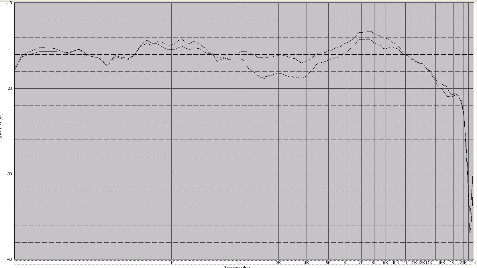

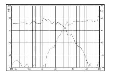

They are actually quite flat - this is the response with no cal file on my ECM-8000. The cal file brings down the 6k peak some and brings up 20kHz as well. The one with the dip matched the other after the caps were replaced with polyester. I found these to be the most neutral of the speakers I listened to at Best Buy that day. 😉 Note, the scale is much tighter than xrk's scale, so it looks lumpier.

Well, I would hope the frequency response IS reasonably flat. But that has very little to do with a good sounding speaker. A necessary, but not sufficient condition, I think we'd agree. 🙂

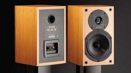

I was more interested in the DC resistance of the drivers and the actual crossover currently fitted. Here's how the Epos ELS-3 does 4 ohm polycone bass. Quite interesting, IMO.
1.5uF cap on tweeter - woofer is crossed over by self inductance 😉

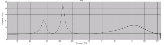

Sony seem to have a knack for drivers that work reasonably well on simple crossovers. But this is a cost constraint. I have no doubt they could be improved dramatically up to being something revealing and undistorted.
I'm also quite sure they sound pretty good as they are. Adequacy may be enough. Alas we can't take it further without knowing the impedance of the drivers.
