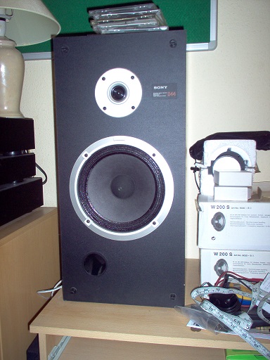

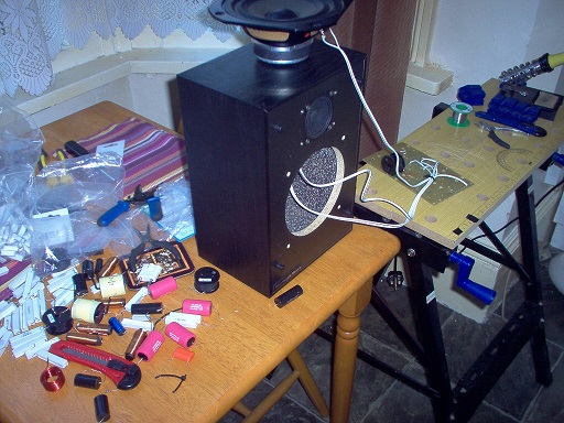

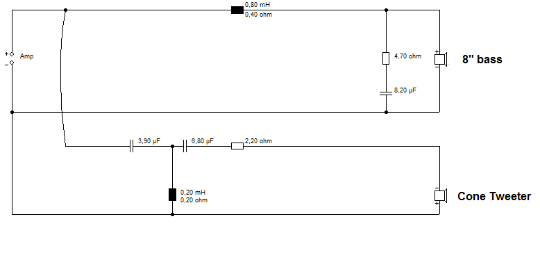

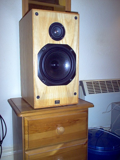

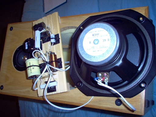

Here's a couple of 8" bass speakers I bought second-hand. The lovely wooden £60 Monitor Audio R300-MD had fried SEAS 19TAF/G tweeters. Which rather kick-started my hobby! The simplistic filter was something I improved using a KEF Celeste III idea, which has almost become my standard filter. And the little £6 Monacor HT22-8 cone tweeter is excellent.
The Sony E44 were £20. The retro-looking high efficiency drivers are superb if you add a good crossover, instead of the mere 2.2uF single tweeter cap originally fitted. Terrific detail and dynamics.
I usually add some rubber and cork panel damping aka acoustic underlay, and some wadding behind the bass chassis. It's an old trick with closed box to pad the back of the woofer with some touching firm wadding, which stops chassis ringing. 😎
I was overly influenced by Troels Gravesen's TQWT with the small bass coil on the Sony. I think I shall next make it bigger for more bass. Next project is a 5" reflex polycone design, probably with metal tweeter. Oh wait, that's rather Continuum, isn't it? 😀

All that will need is a coil and a shunt capacitor and resistor to be reasonably flat. The voicecoil inductance is important though. High Le will fight your efforts to filter. Hence a bit of final tweaking always required. I find my expensive £70 LCR meter very useful too.
For all that, I have my disasters. This 10L MS15 box was just plain too small for a 6" driver. Bass is poor.
