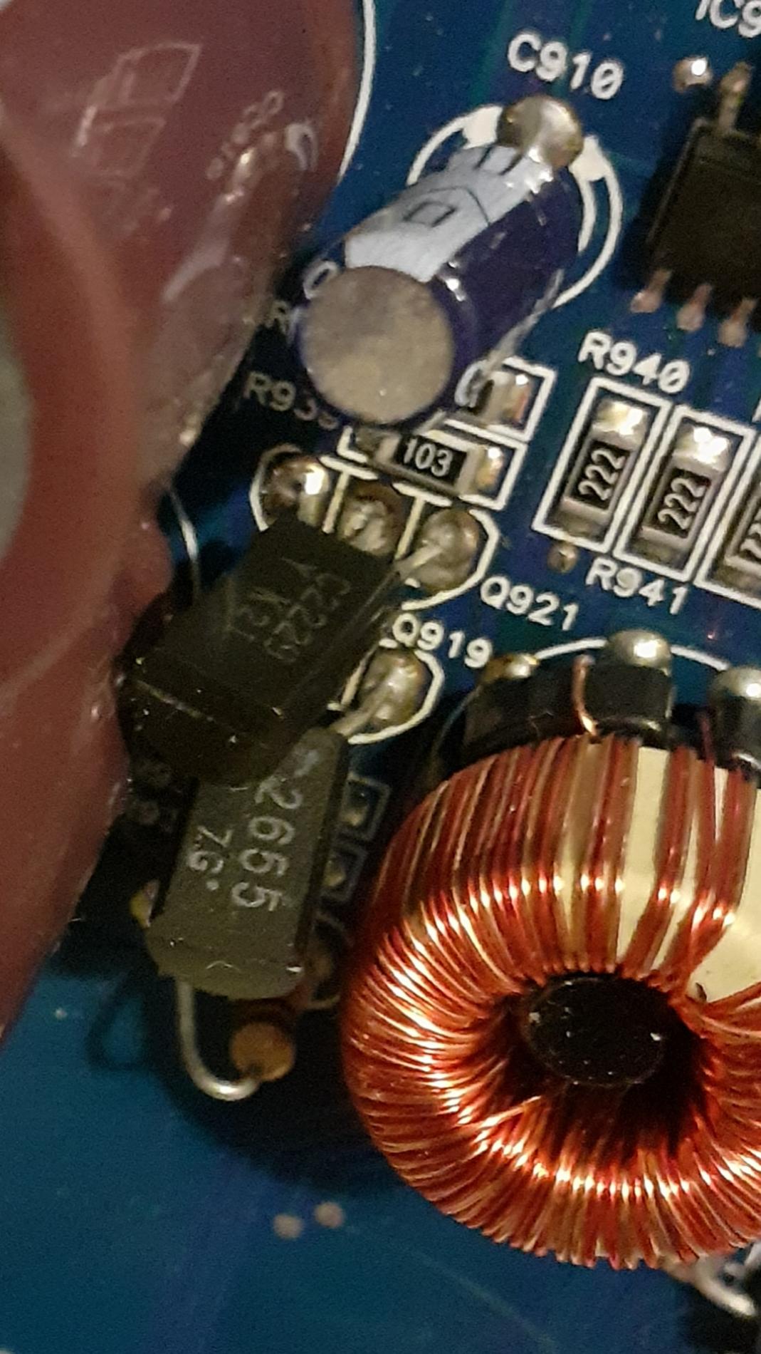

Today comes to me an eclipse xa1200 ice amp.

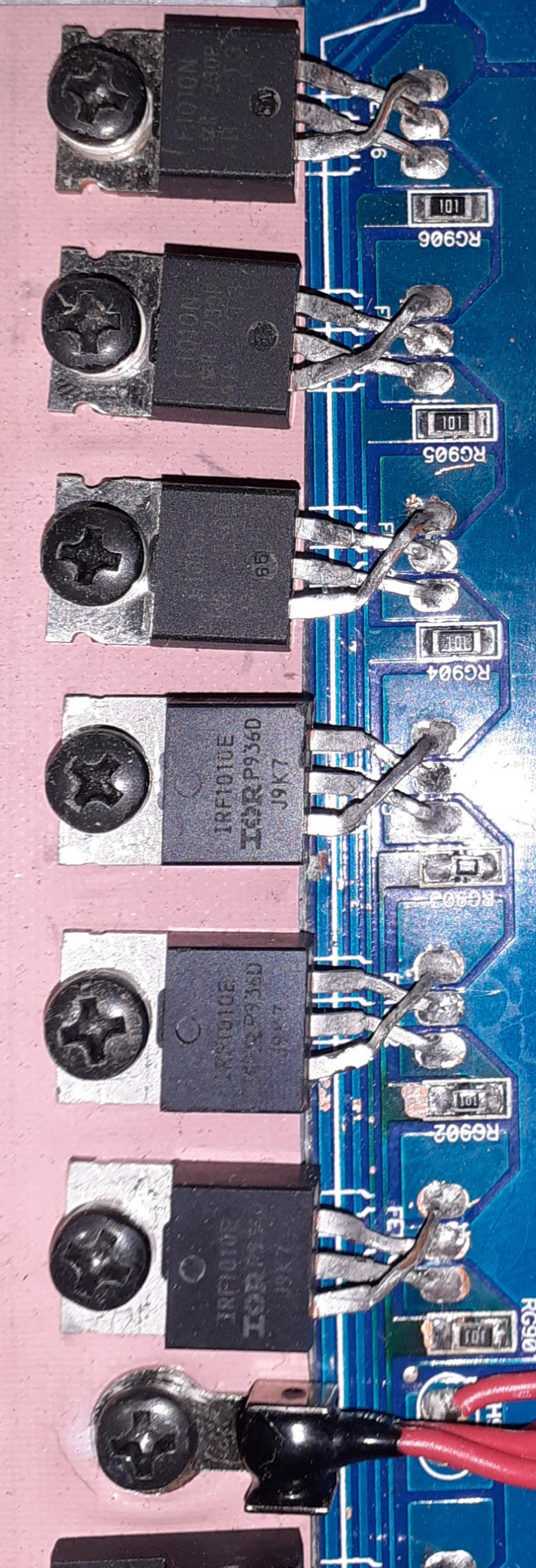

I dont test any amp, before i check the inside. In this one i find a rarely and 100% sure bad conection on the irf1010 ps mosfet, see the image.
So i take off all the ps mosfets and test it. No power, no 12v on the tl494 so replace the remote signal transistor. 12v on vcc and c1 and c2 of the tl. Now i have around 4-5v on the tl outputs, but im sure the ps mosfets drivers are grone. Anyone here have the shematic or the corrct part nunber for q919 and q921?
Thanks!

I dont have an oscope right now, only multimeter.
I have 0v because the gate signal transformer is off, i take off both transistors. I need the correct part number for those transistor and test again if the transformer had gate signal.

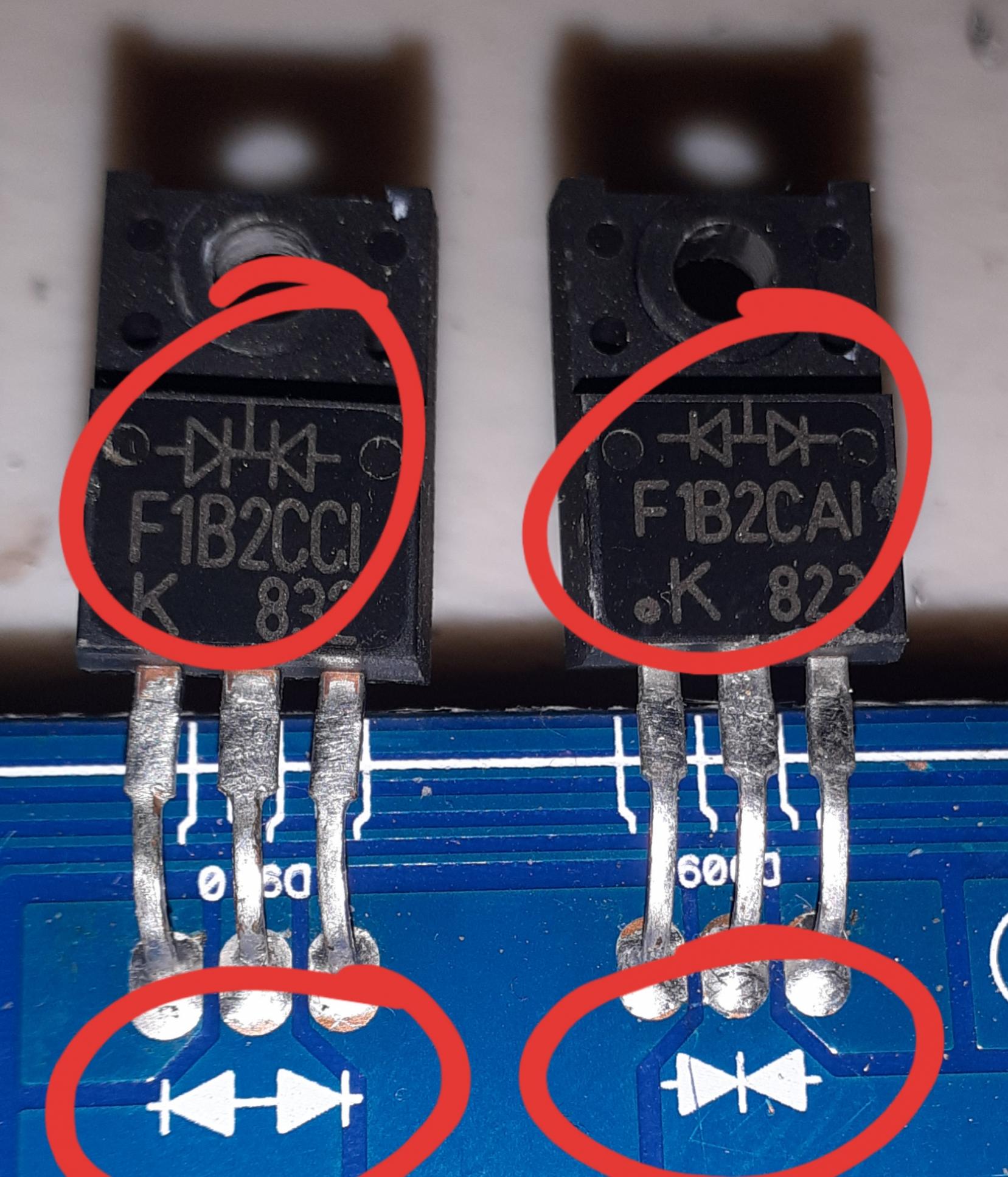

Thanks Perry! Its the same circuit. I put irf1010 and find another problem, someone do a mess with evrything in the amp. The rectifiers was in the bad side! 😱
Now the ps turn on, then protects, about 35 volts then go off. Im locking for bad traces or solder juntions.

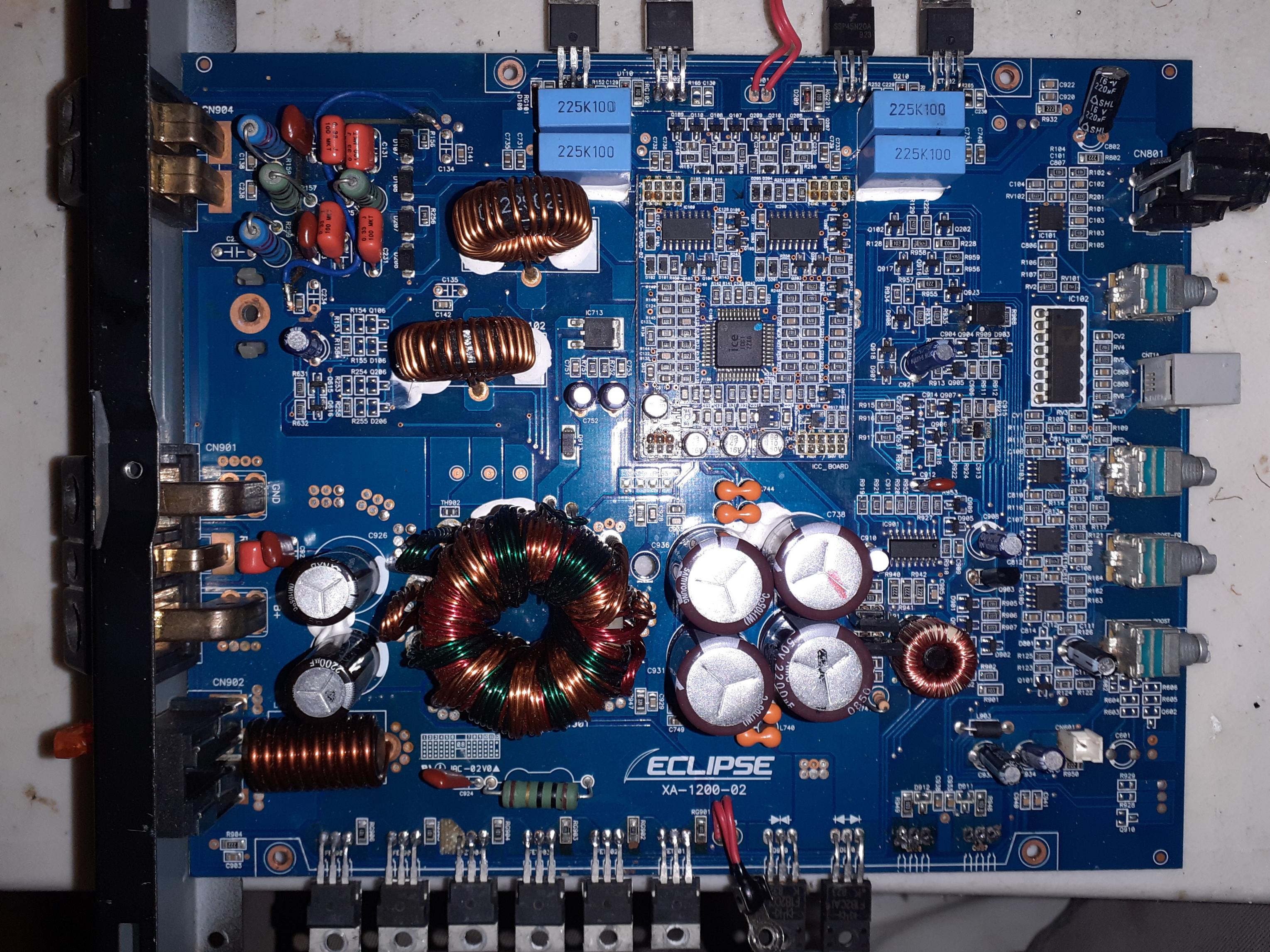

Everyone smd transistor and resistor checked. Now i think i found the problem, the ssm2018 ic. If i touch the ic leads, the speaker make noises, so i think the ice ic's are working. No heat from mosfets or anything else.
I found datasheet for the ic but its obsolete and discontinued
