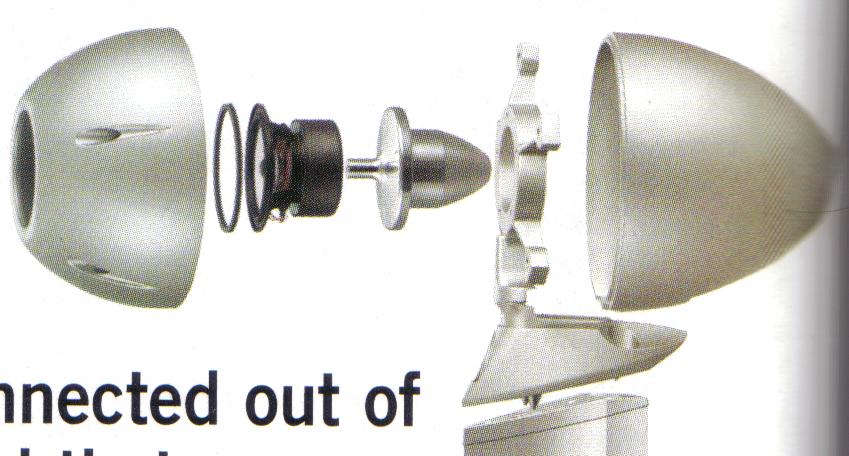

They are single driver units and supposedly FR with amazing imaging. The cabinet is a complex casting with various parts including a clemping system for the driver with a weight that is larger than the driver/magnet assembly to damp all unwanted resonence. The dtiver is 12cm.

Here is the unit opened up.
notice the large weight directly behind the driver.
It extends into the pole peice vent. It is tapered at the back, not only to fit the casing but to break up any remaining standing waves that the rear shell did not already kill. So the driver essentially never gets a wave refletion hitting it
The frame with the legs bolts to the front section of the cabinet and secures the DRIVER directly to the stand!

I hae no idea if the box if vented or not. All I know is that they have made a lot of effort in minimising vibrations, damping the driver and making the hole shebang as dead as possible.
If problems like internal reflections, vibration etc are minimised as much as possible I guess the driver can give its best.
Also having such a small (read no) front cabinet area the driver must be extreemly directional.

I was thinking about a translam cabinet to make the shaping easier using glass fibre on the inside and outside to make it stiffer. I will try to get a friend who has a lathe to turn a hunk of something he has laying around for the rear weight/phase thingy!

Thor, over on the Fullrange driver site, has been using exactly this shape of enclosure with the JX92S. He uses a ceramic pot from a garden store - he lines the inside and makes a wooden end cap to hold the driver, resulting in an 8 litre enclosure which rolls off at 100Hz to a sub. He says the enclosure is inert and the whole system images very well.
JC, on the same forum, has gone a similar route - but he has the advantage that he is a potter, so he made his own enclosure.
I am investigating a similar system myself, either using a local potter to produce something or keeping my eyes on the garden centres.
If you want to try something smaller, sometime in Sept/October, Jordan should have their new JX6 (JX53 replacement) driver available which will operate to 150Hz in a 1 litre sealed enclosure. No pricing details yet, as far as I know.
