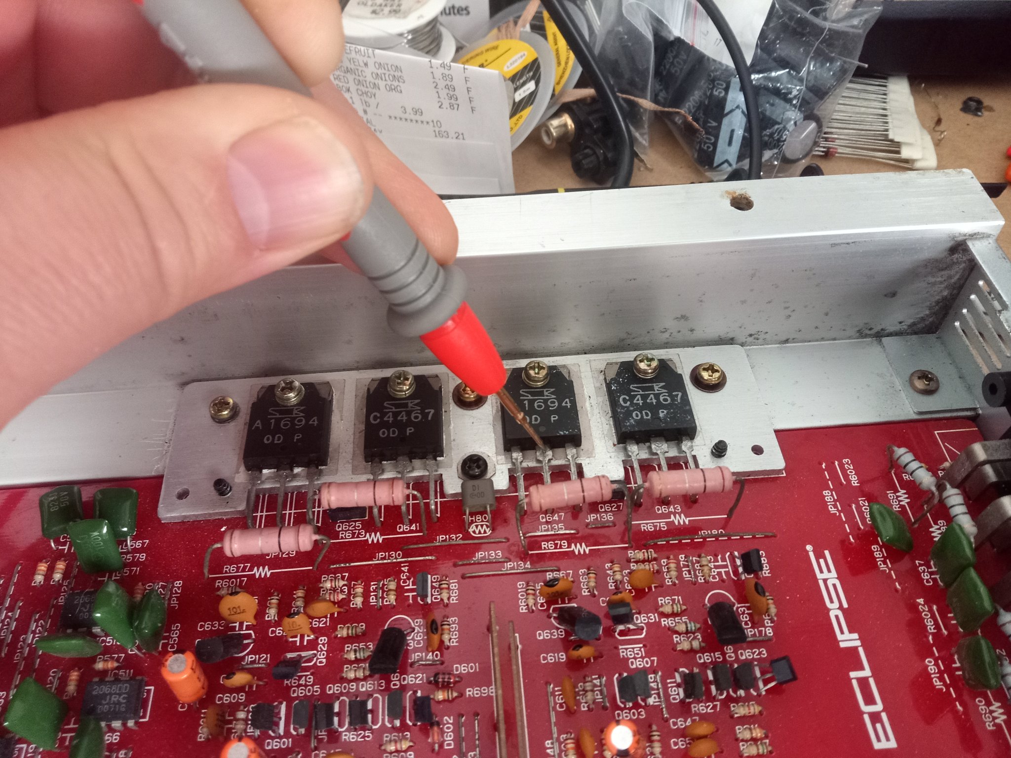

With the amp powering on and no output, where should I start, there no shorts in the fets or bjt's or rectifiers.

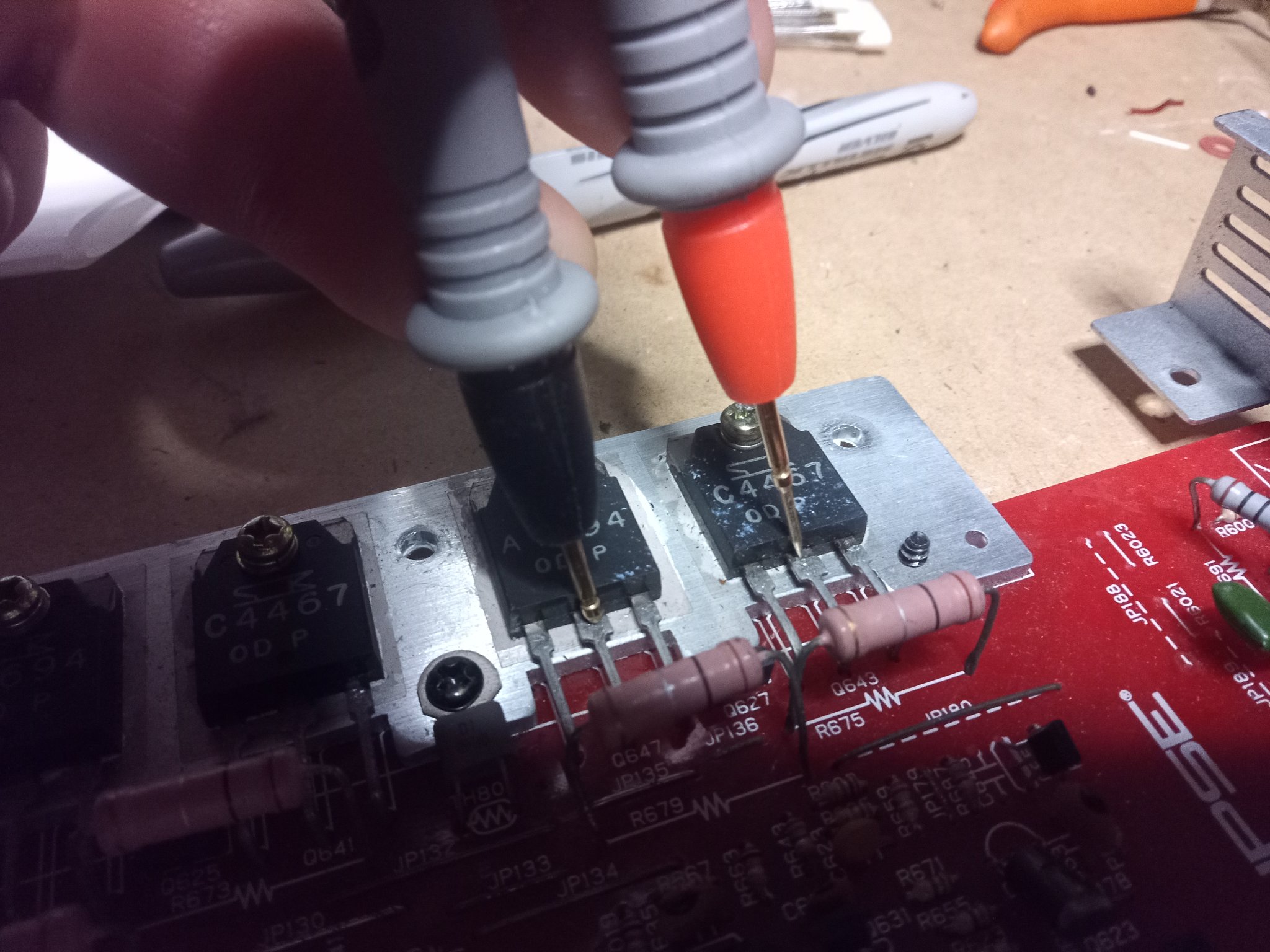

Hi Perry, so I bought an identical 36401 that works. When I tested bjt's have rail voltage +/-23, when I took it out of the heat sink I lost rail voltage. So that got me thinking, I put the old one back in its heat sink and rail voltage good, op amps +/-14. So im not sure why none of that would work unless it was in the heat sink? So still no audio on the old obviously but I feel like im back in the game on this one.

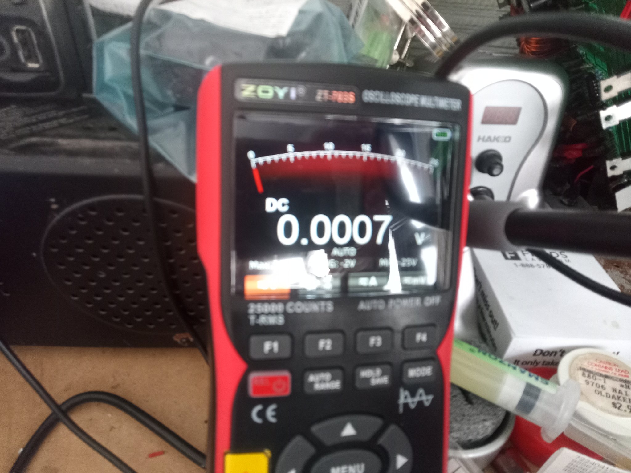

Place the black meter probe on one of the non-bridging speaker terminals and measure the voltage again.
Ok, again im not sure if my scope is set wrong. I have it set to auto and Vpp but all I see is like 0.00003 volts on the non bridged and 0.4 on the bridged.
The non-bridging terminals are a reference (black meter probe) that you will use to check the secondary voltages.

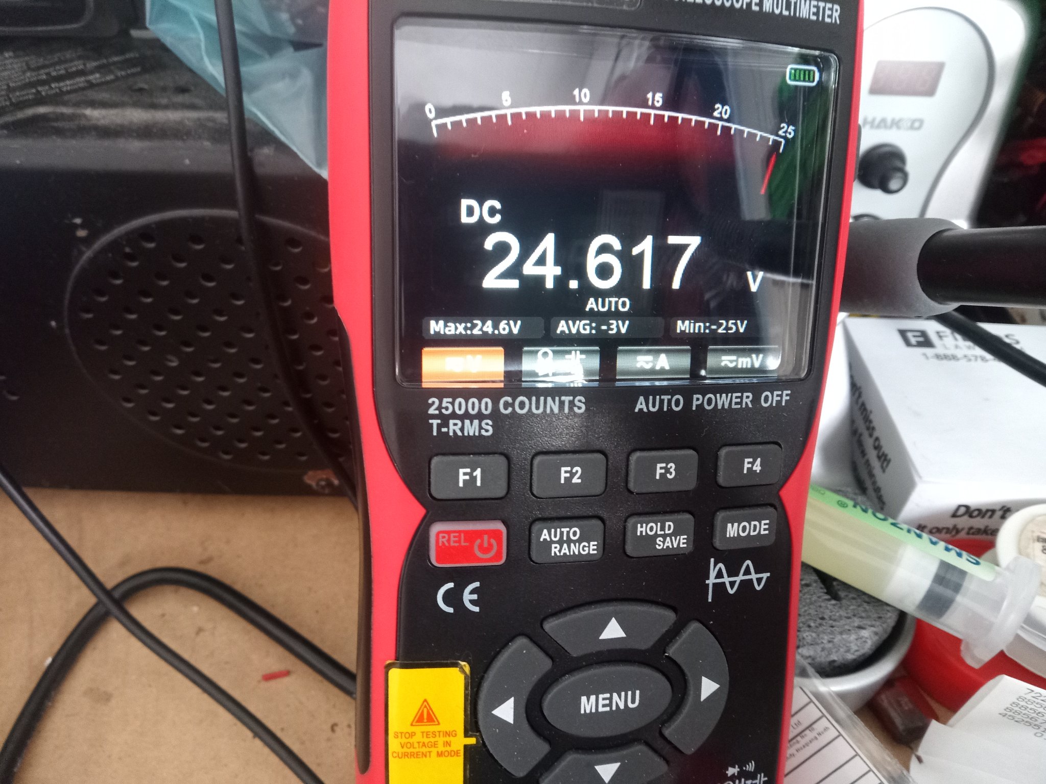

I still see nothing on the speaker outputs. These were the readings from the bjt's
The 0.0007 is what I get from the non-bridged terminals
The different reference was for it out of the heatsink. Does the different reference make a difference out of the heatsink?
If you measure from the center terminal of a positive rectifier to the center leg the adjacent negative rectifier, what's the DCV (out of the heatsink)?
With the black meter probe on one of the non-bridging speaker terminals and the red on either of those points, you read 6.83v?
