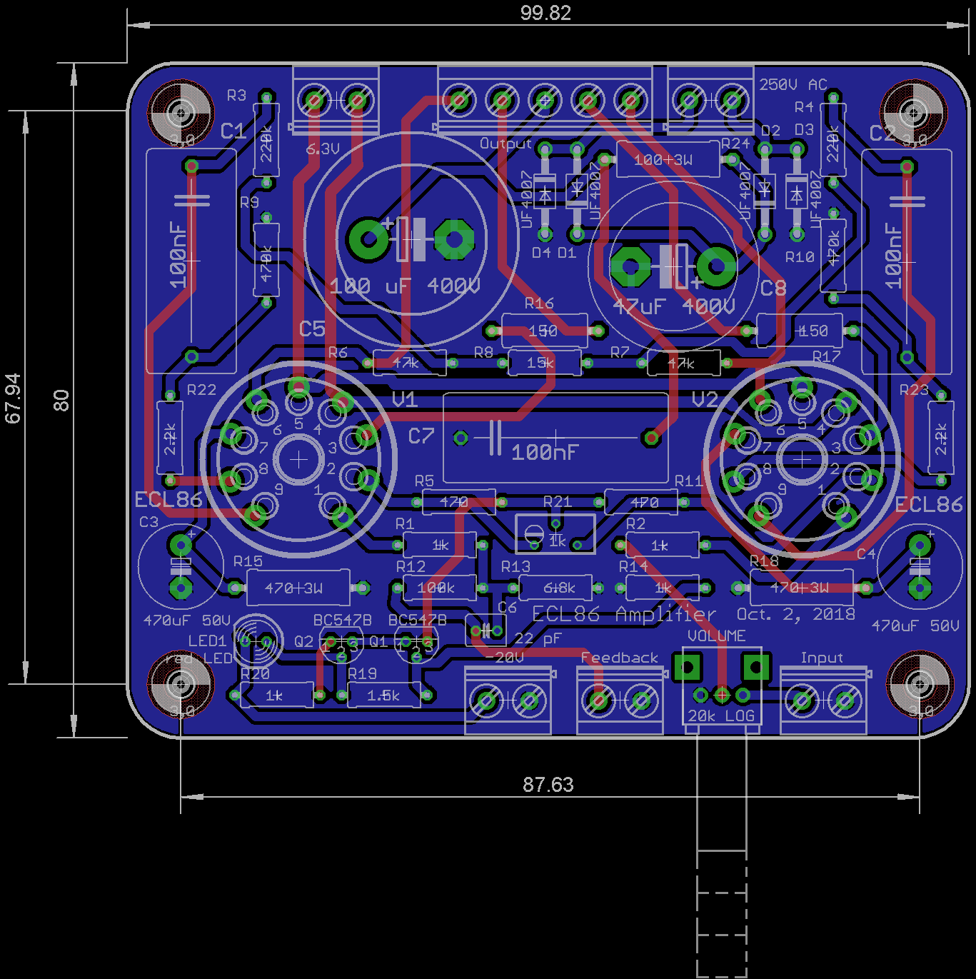

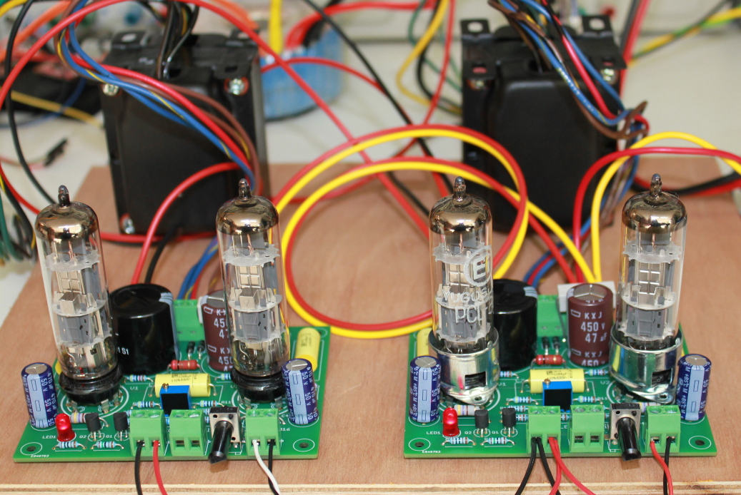

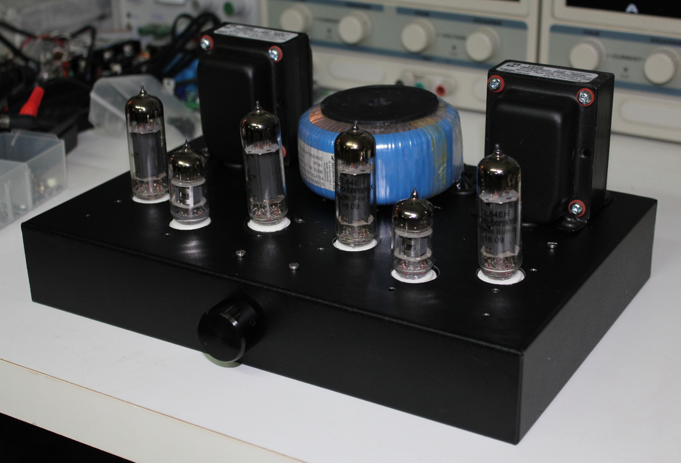

ECL86 Baby Huey Push-Pull
Hi Amit,
I don't have a single end ECL86 version, but this is a very good ECL86 or PCL86 push-pull version which will give you about 12 W with a 8k output transformer.
The Baby Huey concept give a very good musicality and if you are interested you can read more here post 1670 : EL84 Amp - Baby Huey and in the entire thread about the shunt feedback which give an incredible sound to this small amplifier 🙂

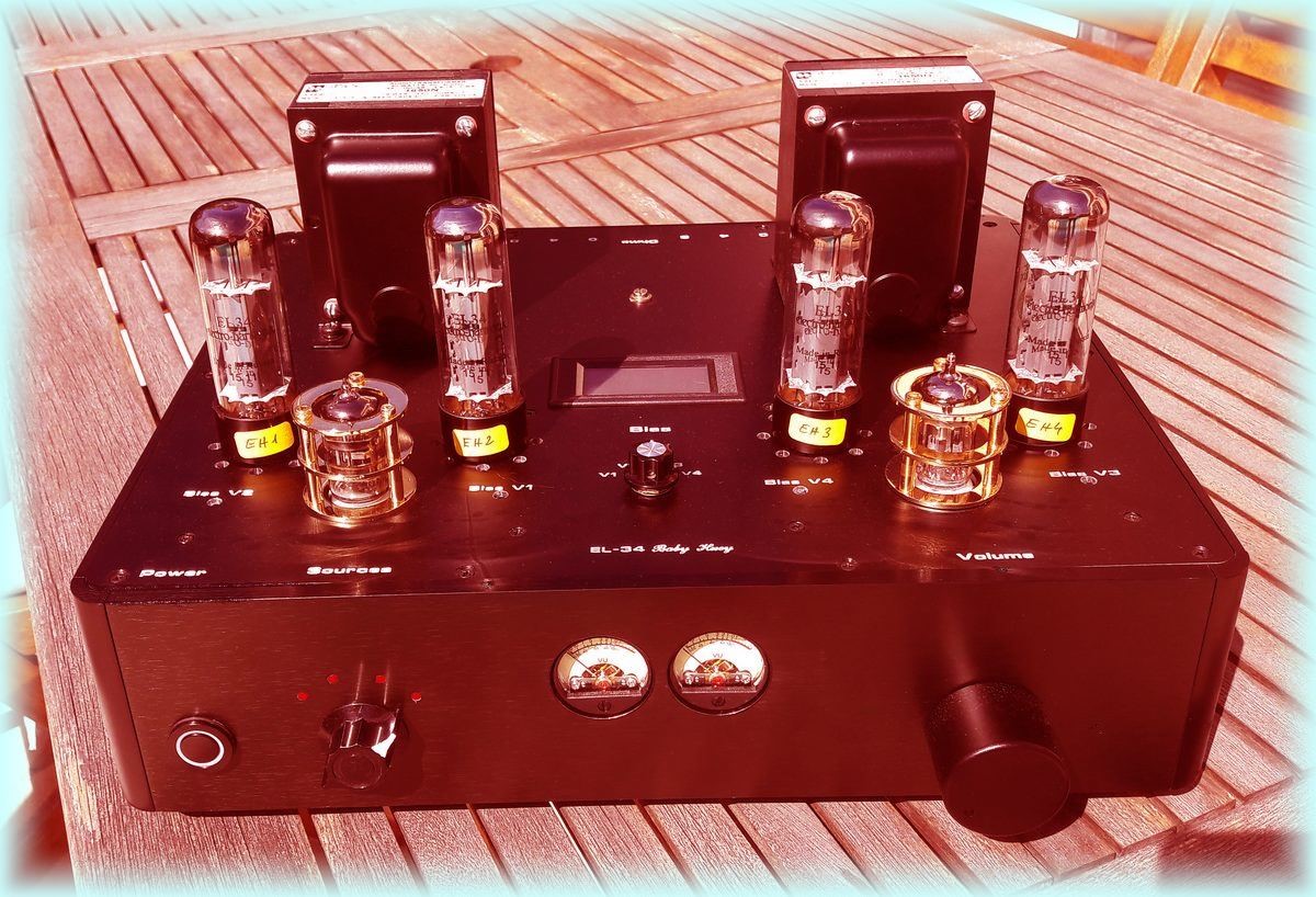

After this PCL86 version, I have made an EL84 Baby Huey version and an EL34 Baby Huey version (see pictures) ; EL34 Baby Huey Amplifier that has been built by more than 100 people in 5 Group Buy ( more than 500 PCB sold !) : GB for Baby Huey PCB 😀
The concept is validated and all versions have been fully tested !
Best regards,
Marc
