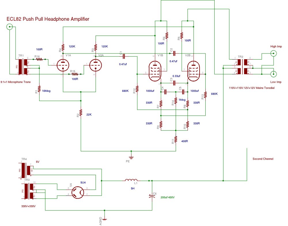

The negative feedback applied to the input stage of the Wave 8 means that you'll pick up a little headroom there. i.e. It might take a full volt before the input stage clips. But it probably doesn't matter as I expect the output stage will clip before that.
Having said that, my advice is to not worry about it. Just build the amp the way it's designed and see what happens. You'll need to have some kind of volume control before it anyway (a variable voltage divider!) It might turn out that you can only turn it up to 12 o'clock before it starts to distort. So what?

Thanks for the help finalising the design guys. I have completed the amp!
I built the Wave 8 design almost stock. As the small output transformers have ultralinear taps and I don't require high volume levels, I wired the design ultralinear instead of pentode. Also, noticed that the load resistor on the concertina was 33K and the cathode was 39K. Using these values gave different gain from the two signals from the concertina. I hooked one channel of the scope up to each output of the concertina and then summed the output. If the two signals are equal and opposite phase, then the scope should show a nice flat trace. It didn't. Replacing the cathode resistor with a 33K gave about 1/3 the distortion, so that is what is in there now.
Also, worked straight up when I tried it before hooking up the feedback with just about zero hum. Pretty happy about that, grounding efforts must be paying off. Murphy's law stated that the phase would be wrong for the negative feedback, so had to rewire the outputs from the tubes to the output transformers.
Overall, pretty happy with the result. Accomplished my aim of building a hum-free point to point, push pull amp for my office. Next project is a "Baby Huey" and my son now wants an amp and speakers for his computer...
