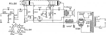

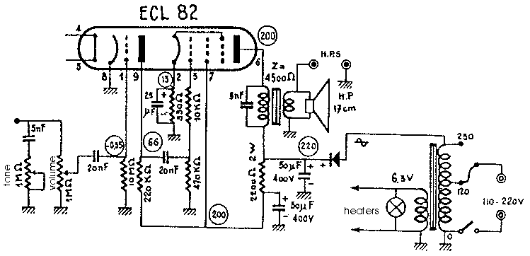

Hello, I am thinking of making a 5-1 tube amplifier for my room. Since 5 channels must be used this is 5x the cost so I have chosen a simple design (a better suggestion??)
I have found these two litle integrated amplifiers and I would like to have some suggestions of which one to use, based on sound quality and volume factors
Thank you

Availability considerations force you to use the 6BM8/ECL82, as Russian production is in the market place.
A PSU using an unsymmetrical 1/2 wave rectifier is a BAD idea, as "standing" DC is present on the rectifier winding.
Check this thread out. A Triad N-77U in the B+ supply is good for approx. 225 mA. That might be enough for 5X channels. The N-77U has dual primaries and works in both "120" and "240" VAC zones.
Go for the beefier ECL86. The pentode can be looked upon as a EL84 with 9W instead of 12W Pa and the triode is one half 12AX7. It sounds great and is available NOS. Probably the P will be cheaper.
If the driver feels wimpy you can always add a DC-connected MOSFET-follower between triode and pentode.
But why not go PP? Easier to get hum free and better performance by adding just one tube.
