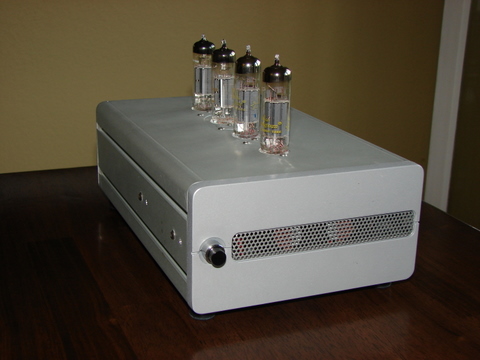

Surplus PCL82 PP Stereo
I finished building a PCL82 Push Pull stereo amp using the schematic from post 713745. The only difference is that I had to change the cathode resistors as the one on the schematic was exceeding the plate dissipation of the tube. I ended up putting a 1K ohm resistor, drawing an quiescent current of 25ma. Since the tubes were surplus and unmatched, one of the tubes had a combination of a 560ohm and a 1K 15 turn trimmer from Radioshack. This way I was able to match the currents. Other than that the amp is very silent and sounds very nice. Need to build some high sensitivity speakers next.
The amp is build will almost all surplus parts.
output transformers are 7010 line matching transformers, 8K to 8 ohms.
Power transformer is a triad 35va isolation transformer with a voltage double power supply.
The heater is a 16v @ 1.6amps.
The case is a LACIE usb drive case.
