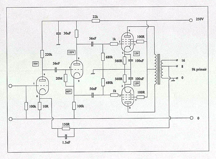

> schematic to build using 4 of the above valves, two per channel. I'm limited to only 4 valves in total
How many ways are there to use two ECL82s? Oh, I can think of several silly ways: use the pentodes as volt-amps, the high-Mu triodes as a bad power amp. But seriously, only a couple/three ways. Given your space, a V- supply for fixed-bias or LTP driver doesn't make sense. So it really comes down to some minor variation on this:
The "about 270K" resistor should be trimmed so the first plate sits at 1/4 to 1/3rd of the supply for that stage (so the cathodyne is well biased). The output stage cathode resistor is about 200 ohms, and may work better with a bypass resistor. I've set NFB with 2K7 and 27K fairly arbitrarily, change the 27K to taste.

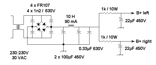

Try this one, sounds pretty damn good for a small amp, better than the Stoetkit (yes, I have compared them) Coupling caps can be as small as 22nF. I used a pretty heavy power supply with diode rectification --> 550uF --> 10H --> 550uF. the 30uF for the driver stage was a paper in oil cap I had lying around, coupling caps where Wima FKP's cheaply bought at a dumpstore.

Please notice that both PRR and Sjef suggested a common cathode gain block driving a "concertina" phase splitter. It's most definitely a workable solution.
A possible tweak to the concept is to regulate the the screen grid B+ of the "finals" with a Zener diode stack. Regulating screen grid B+ in pentodes and beam tetrodes improves linearity. Loop NFB is still needed to lower the O/P impedance for damping factor considerations.

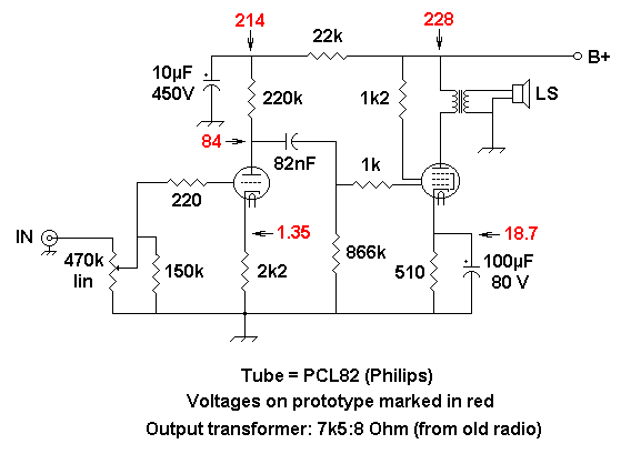

Looks like a neat little amp. What worries me is the pentode-connected
output without any form of feedback. Most speakers will misbehave
due to the high output impedance (may yield weird frequency response
with sloppy bass). Also, the input sensitivity will be very high,
which may be a problem in some cases (any noise issues?).
I've also built an SE PCL82, and like it a lot. It's switchable between
pentode and triode connected output (useful to match different music),
but more importantly, it uses plate-to-grid feedback, which really works
well. The input triode is run far hotter (in fact, I use a plate CCS to
"pull" the triode into a higher-current, more linear spot) and there is
a resistor from pentode's plate to triode's plate (in AC terms the same
as pentode's control grid). A triode "current pump" (V/I converter)
feeding the pentode "I/V converter" (not quite). That's all. Pretty
easy to try.
I've since learnt, from the excellent PRR, that a smaller plate-to-B+
resistor instead of a CCS will work almost as well. A rough calc. gives
about 15k triode plate resistor, 390 ohm cathode resistor. I think I
used 180k plate-to-plate resistor. No triode cathode bypass, and
remove or lessen the 22k B+ dropping resistor to maximize available
voltage to the triode. (This will demand big current swings from the
triode, in fact, just barely enough. A plate CCS at 2.7 mA replacing
the 15k plate resistor would improve the margin.)
Not a lot of feedback, but just enough to get a manageable Zout
and to clear up the sound just a bit without going overboard.
One disadvantage: power supply rejection gets worse, so good
filtering is required, but you seem to have that.
Just a suggestion, but IME well worth trying as an alternative to
global NFB, which can be tricky to get right without an o-scope and
the knowledge to use it (I'm talking about myself!). Also, this will
work with any output transformer, so is more universally applicable.:cloud9:
Morgan

So it really comes down to some minor variation on this - to taste.
At this moment I am repairing some changes made to my Revox Modell 40.
The schema is almost equal to PRR's. The input Ra is 220k;
The phase splitter has 47k and the pentode Rk is 10 ohms with a negative Vg for the penthode of -24V. This Revox 40 was built by Studer. It uses the ECL86.
I am contemplating making a CCS for the Rk to force equal currents.
