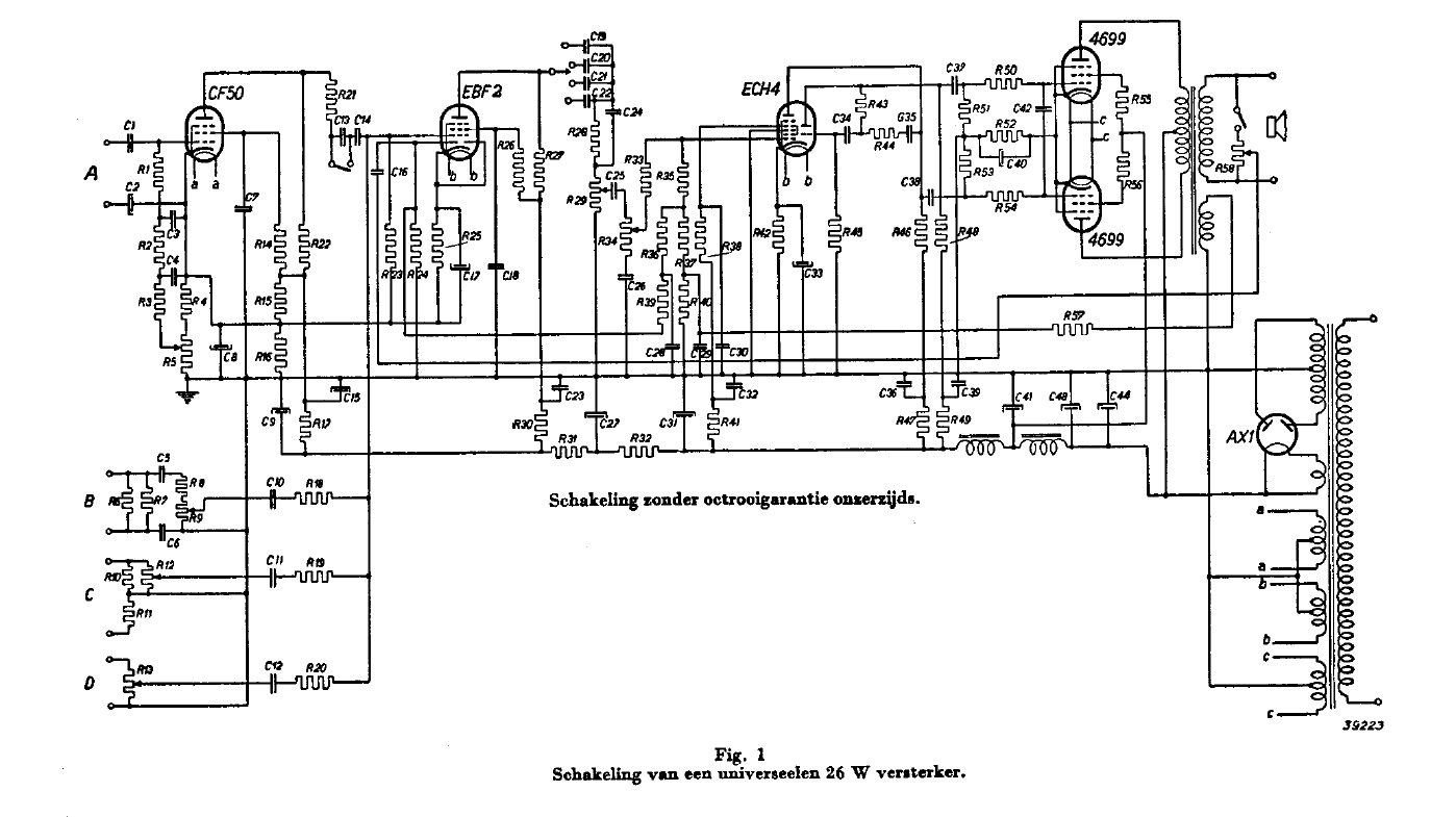

The ECH4 and the ECH21 were sometimes used as combined AF amplifier and phase inverter, just like the ECH81 sometimes was. Attached two examples, one from a book by Philips (1942) and one from a book by Ratheiser (1955).

CF50 + EBF2 + ECH4 + 2 x 4699 pp + AX1 (Philips) Schematic.jpg240.5 KB · Views: 455
CF50 + EBF2 + ECH4 + 2 x 4699 pp + AX1 (Philips) Parts.jpg517.6 KB · Views: 217
EF40 + EF40 triode + ECH21 + 2 x EL34 pp + GZ34 + 150C1 (Ratheiser 1955).jpg109.7 KB · Views: 308

After i drew the internal structures on a piece of paper and for both ECH80 and ECH81 and examined the ECH42 data sheet it seemed that it could not make sense otherwise.
I have quite a few 6M5 which are identical to EL41 being common here in Australia. So i think it would be worth trying that first example you have generously shared.
