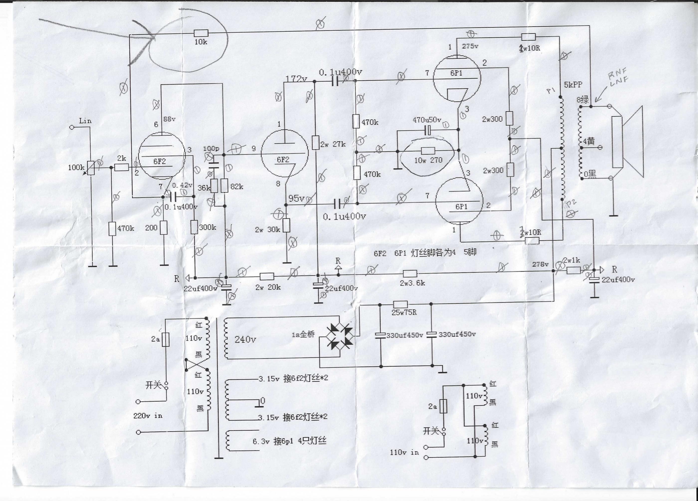

It's not the tube, it's a problem with unequal cathodyne load:
VR70E has a long standing fault in the concertina; they have unequal resistors for anode and cathode. Repair this and you will have less distorsion.
It's R35 and R36 that has 33k and 36k
It look like this is issue of in Dynavox VR-70E not Audio Institute VR-70E. All numbers and many values are different in mine. There is even no R35 / R36 on the board.

Changed out 6F2 for Jan Philips 6U8A in ChiFi PP schematic below...
6U8's have better brilliance up top w/ no loss of mid/lows into my Cambridge Minx XL's... But they're getting noisy after 150ish hrs of use- hum and hiss @ 0 vol that wasn't there initially.
So I weeded thru few data sheets of tri/pent equiv's in this searched thread...
Takeaway Q was construction of pentode first grid to cathode distance which garnered an app warning of arcing- does this relativity have any effect on sound? range? would seem so to me, but I'm always in 'learn' mode here.
Ordered matched 6AX8's to try, since there wasn't anything on this variant here, so we shall see.
Another Q-
Conventional wisdom here that plate and cathode resistors on PP triode inverter much match.. although they don't on current design (30k 27k). What does this imbalance do?

This seems to be a clone of dynavox where they also err with the cathodyn
resistors, The result is increased second overtone : distortion. Make the
resistors equal !

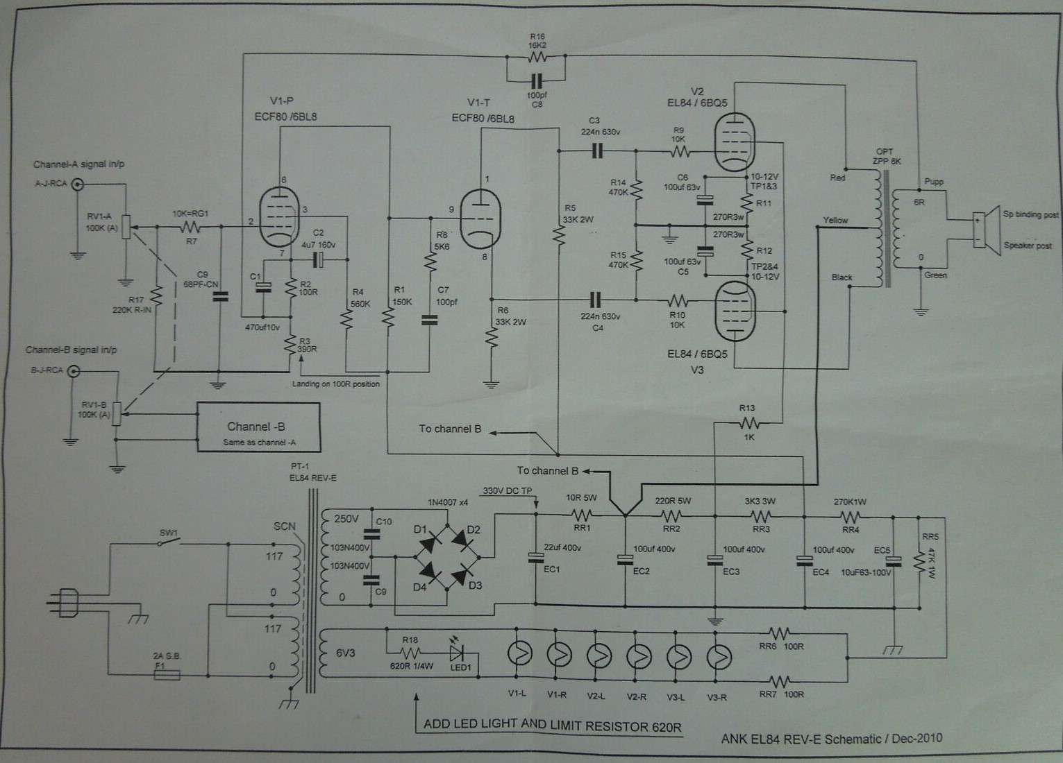

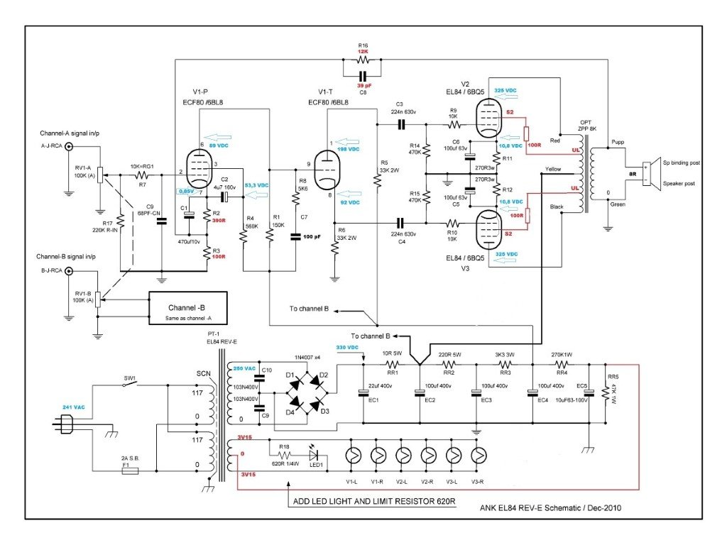

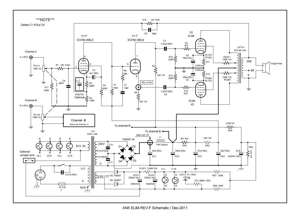

Instead of trying to tweak ChiFi circuit, I've designed retrofit PCB w/ proven audionote schematic. I'll be testing Chifi v audionote designs w/ same transformers & chassis. Board will also have capability to be expanded to UL mode (Rev E & F) in future. I'm sure curiosity will have me testing the different AN design's also.
Parameters aren't set yet, but thinking of using some or all of the following:
http://lcweb2.loc.gov/master/mbrs/r...ektronix Cookbook of Standard Audio Tests.pdf
