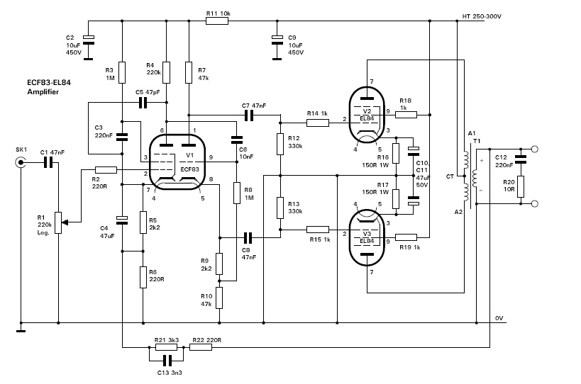

I was using this ECF80 to replace the ECF83 in the circuit attached. Its the phase inverter part so probable not a problem being a low signal valve.

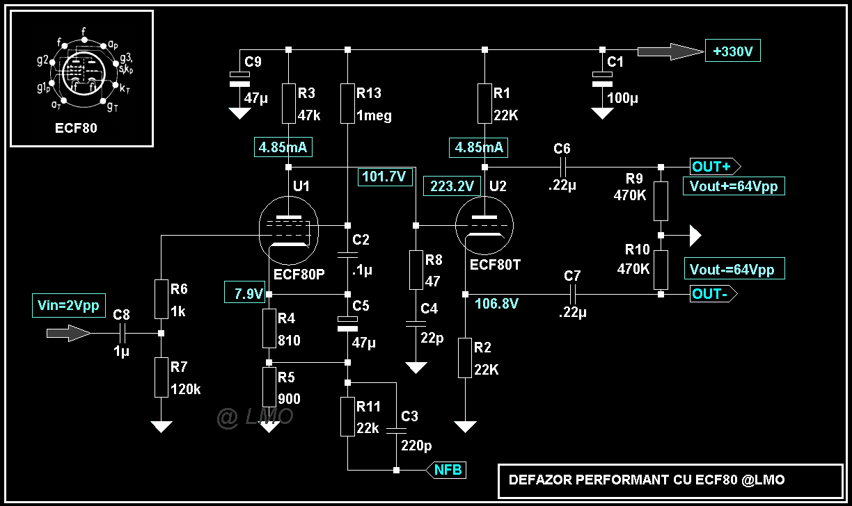

Maybe it will help this chart, the installation was made several copies and is useful for a final amplifier PP with very good performance.

There is an obvious difference in Ra between the two types for both sections which implies you may need to change load resistors to maintain performance. I haven't checked to see if they are pin compatible. I would imagine there is a capacitance difference between the two as well

If you change the cathode resistor of the pentode section I think it could function with a ECF80.
For me, the connection for the lower EL84 grid, is on the wrong side of the triode cathode resistance.
The gain of the amp is typical for old gear, today the output of most sources is much higher.Can do with much less input sensitivity, no need for a pentode input.

Thanks all for the replays. I will go over this tonight and see what is best. I still need to learn how to read the data sheets properly. I do know the pin out on both valves are the same but as some of you have said the plate and bias resistors may need changing.

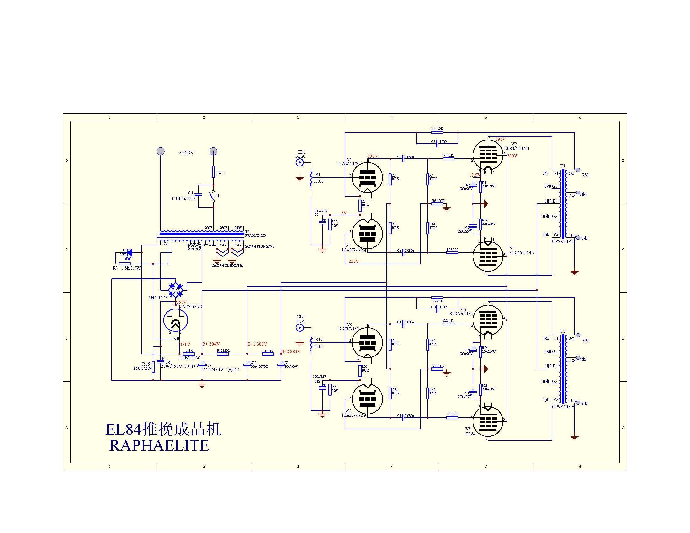

Ketje thanks for the schematic these look good. the second by raphaelite looks interesting but i will need to see if i can source the output transformer.
LAZAROIU did you do this schematic on a simulator and is so where can i find this as this would be very help full for learning

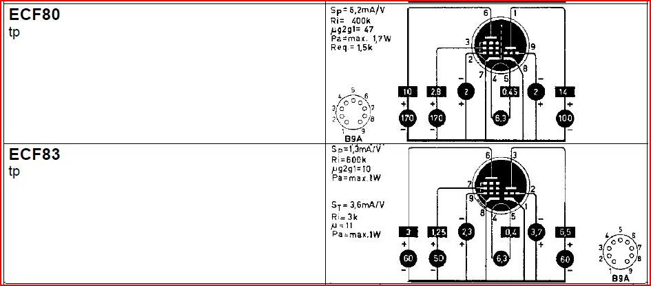

Where did you see that? The information I have seen says they are quite different. For example see ECF 80, Tube ECF80; Röhre ECF 80 ID2409, Triode-Pentode and ECF 83, Tube ECF83; Röhre ECF 83 ID3420, Triode-Pentode. This site is usually reliable.I do know the pin out on both valves are the same
The first link gives pins 8 9 1 for ECF80 triode cathode grid anode respectively.
The second link gives pins 1 2 3 for ECF83 triode cathode grid anode respectively.

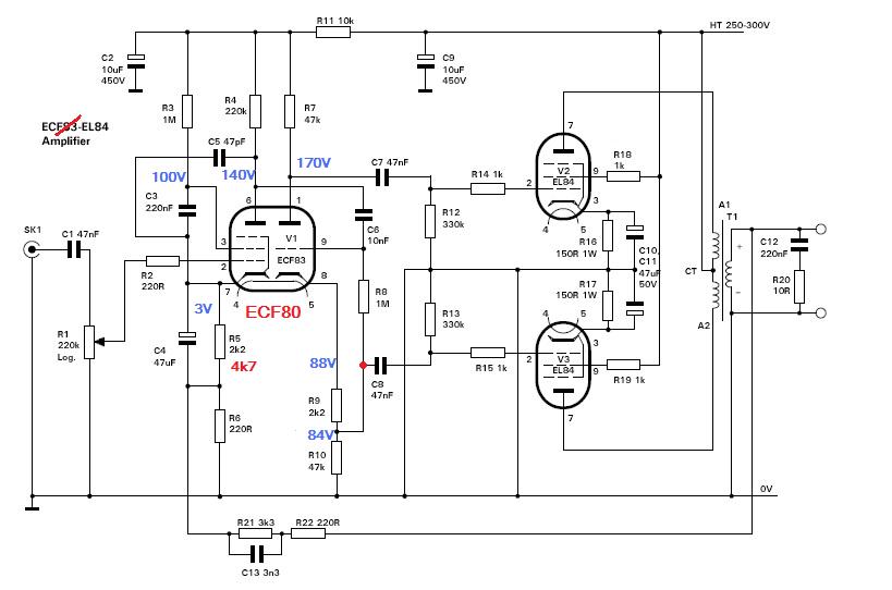

i see what you mean. This i sa bid worrying, I got the EFC 80 pin out from the data sheet and compared it to the schematic from the following link.

The nrs in the schematic are right for the ECF80 and they name it ECF83 😱i see what you mean. This i sa bid worrying, I got the EFC 80 pin out from the data sheet and compared it to the schematic from the following link.

Since it was for converting to the 80, I only checked if it was ok, not if the 83 was different 🙁
Mona
So from what you said and from the data sheet you posted the scematic actually is wired for the ECF80 already. (sorry not wanting to get to confused with all this)
If so then the ECF80 in this circuit hopefully should be fine

Basically, as long as you get the pins rightly hooked up, it looks like it would work. Ketje's advice is great, and should be taken (re: resistor values).
However, just looking at the amplifier diagram, it seems to be full of capacitor values that might once have been 'cost effective' in an optimal sort of way, but which look small by today's “we need bass response” world. There's a lot of compensation to squash high frequency (supersonic!). Suggests that the original unadorned design was a whistler.

Ketje schematic of the Raphaelite EL84 looks interesting. Anyone built this design. Will need to see if i can source the output transformer and cost all the part.
